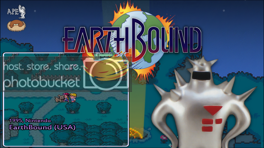

Hyperspin Earthbound Widescreen Game Theme (Super Nintendo Entertainment System)

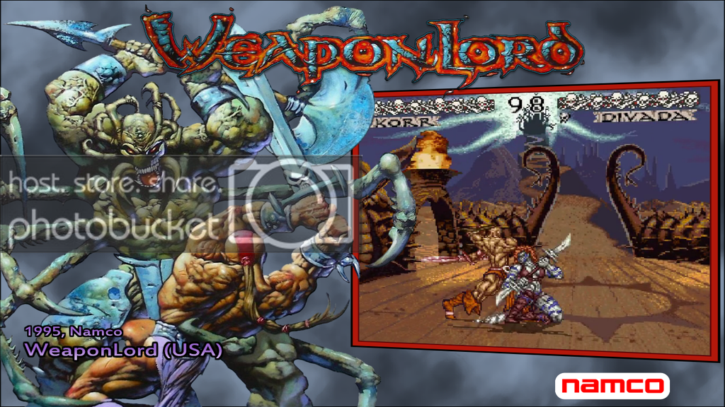

Hyperspin Weaponlord Widescreen Game Theme (Super Nintendo Entertainment System)
In case if you haven't noticed yet; Everything I post from here on out "has been" and "will continue," to be uploaded to my FTP.

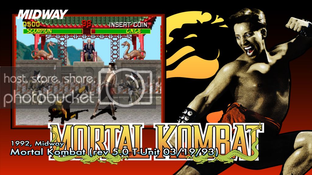

Hyperspin Mortal Kombat Widescreen Game Theme (Midway Classics (MAME))
Hyperspin%20Mortal%20Kombat%20Widescreen%20Game%20Theme%20Midway%20Classics%20MAME_zps6zfa4a52.png

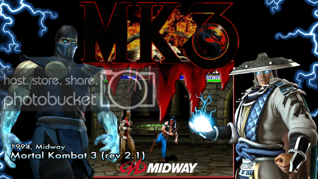

Hyperspin Mortal Kombat 3 Widescreen Game Theme (Midway Classics (MAME))
Hyperspin%20Mortal%20Kombat%203%20Widescreen%20Game%20Theme%20Midway%20Classics%20MAME_zpsjyb2enhv.png

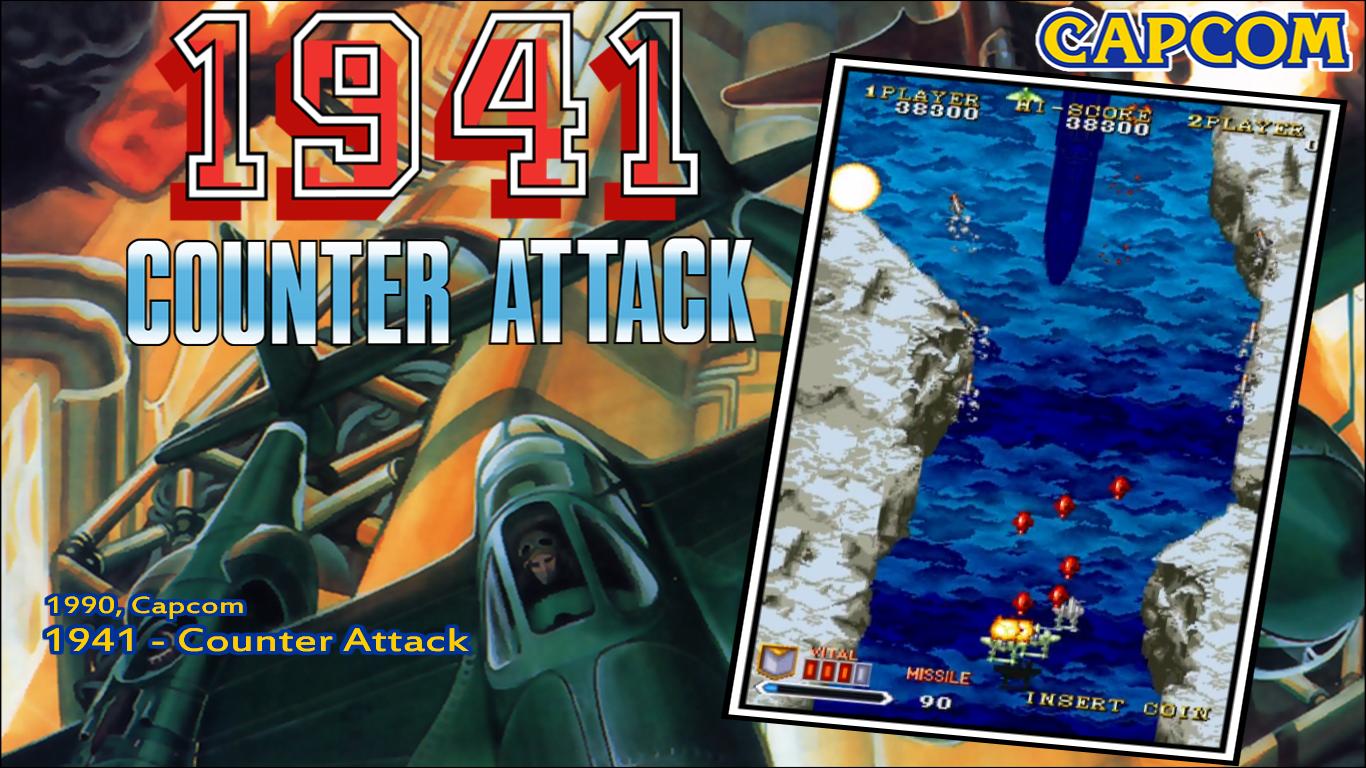

Hyperspin 1941 - Counter Attack Widescreen Game Theme (Capcom Play System (MAME))

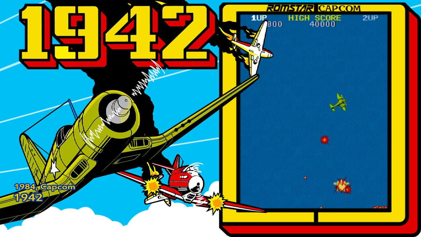

Hyperspin 1942 Widescreen Game Theme (Capcom Play System (MAME))

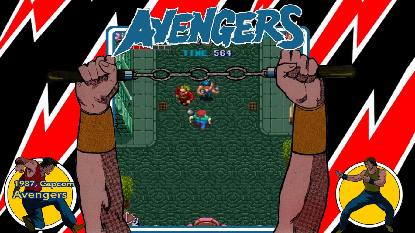

Hyperspin Avengers Widescreen Game Theme (Capcom Play System (MAME))

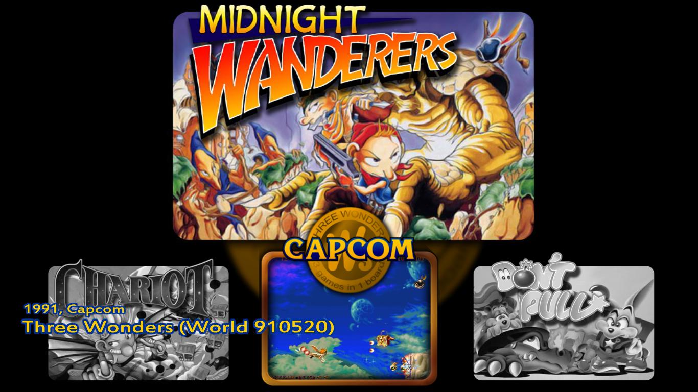

Hyperspin Three Wonders Widescreen Game Theme (Capcom Play System (MAME))
These themes shall and will continue to keep rolling in...
