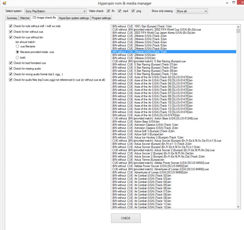

djvj Posted December 25, 2012 Posted December 25, 2012 The Show only missing drop down doesn't seem to do anything. I set it to show only missing roms and it always lists everything no matter what I choose. Also on your CD Image check/fix, I only see a check, where is the fix? It seems to list every game as Bin without cue, but when I open the cue, the bin is correctly mapped...? "Computer games don't affect kids; I mean if Pac-Man affected us as kids, we'd all be running around in darkened rooms, munching magic pills and listening to repetitive electronic music."RocketLauncher's Official Home If you appreciate my work:My Apps:Window LoggerIdle Volume AdjusterExplorerRestorerRom Folder CleanerModule UpdaterMy Guides:How To Mod Guncons with Aimtrak
xttx Posted December 25, 2012 Author Posted December 25, 2012 The Show only missing drop down doesn't seem to do anything. I set it to show only missing roms and it always lists everything no matter what I choose. Yes, this one is broken. I will reapre it today. Also on your CD Image check/fix, I only see a check, where is the fix? The fix was planned, but not implemented yet. As I said in first post "not all features work", sorry. It seems to list every game as Bin without cue, but when I open the cue, the bin is correctly mapped...? And this is very strange one. Can you send me one or two of your .cue files (I will create images myself), and a screenshot of your settings, please?
djvj Posted December 26, 2012 Posted December 26, 2012 Settings are all default except path to hyperspin. Looks like it might be when track1 was renamed to match the romname, but the rest of the tracks were kept with track numbers. FILE "2Xtreme (USA) (Track 1).bin" BINARY TRACK 01 MODE2/2352 INDEX 01 00:00:00 FILE "2Xtreme (USA) (Track 2).bin" BINARY TRACK 02 AUDIO INDEX 00 00:00:00 INDEX 01 00:02:00 FILE "2Xtreme (USA) (Track 3).bin" BINARY TRACK 03 AUDIO INDEX 01 00:00:00 FILE "2Xtreme (USA) (Track 4).bin" BINARY TRACK 04 AUDIO INDEX 01 00:00:00 FILE "2Xtreme (USA) (Track 5).bin" BINARY TRACK 05 AUDIO INDEX 01 00:00:00 FILE "2Xtreme (USA) (Track 6).bin" BINARY TRACK 06 AUDIO INDEX 01 00:00:00 FILE "2Xtreme (USA) (Track 7).bin" BINARY TRACK 07 AUDIO INDEX 01 00:00:00 FILE "2Xtreme (USA) (Track 8).bin" BINARY TRACK 08 AUDIO INDEX 01 00:00:00 cues.zip "Computer games don't affect kids; I mean if Pac-Man affected us as kids, we'd all be running around in darkened rooms, munching magic pills and listening to repetitive electronic music."RocketLauncher's Official Home If you appreciate my work:My Apps:Window LoggerIdle Volume AdjusterExplorerRestorerRom Folder CleanerModule UpdaterMy Guides:How To Mod Guncons with Aimtrak
xttx Posted December 26, 2012 Author Posted December 26, 2012 Aaaaa! Multiple binaries! I did'nt realize the audio could also be in .bin! Ok, i understood, thank you! Will fix today.
xttx Posted December 26, 2012 Author Posted December 26, 2012 - 'Show only missing' combobox now works - CD Image checker now aware of .bin audio tracks http://80.240.211.12/HyperspinChecker_bin_0.002u2.rar todo: - option to rename audio files associated with .cue - add 'fixer' in CD Image checker.
