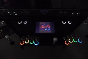

mameshane Posted January 14, 2013 Author Posted January 14, 2013 thanks mate. I think I'm going to go with black center with rgb led outer buttons. similar to what this guy has done (see image) good thing is I already have all the black buttons so only would have to buy the rgb buttons. thoughts? My Cab.. 1-UP ARCADE new hyperspin irc details.. come hang out!
mameshane Posted January 15, 2013 Author Posted January 15, 2013 I think that would look badass. Do it! yeah it will look badass. but unfortunately (after doing some costing) it looks like it would also be badass on my wallet at this stage lol. I have decided I'm definately going to do it. but it's going to be a while before I can pull the trigger on it. it would be cool if I could also somehow get the LEDs I have in the cab at the moment to somehow change with what's going on with the ones on the control panel. not sure how u do that. My Cab.. 1-UP ARCADE new hyperspin irc details.. come hang out!
evil eye Posted January 15, 2013 Posted January 15, 2013 Ahhh I hate when that happens, lol. Sounds like a nice future mod though. If you wire those LED's together with the ones in your control panel they will light altogether. Is that what you want?
mameshane Posted January 15, 2013 Author Posted January 15, 2013 can the PACled64 board control those led's also? could they be controlled by the led blinky software also? My Cab.. 1-UP ARCADE new hyperspin irc details.. come hang out!
zauche Posted January 15, 2013 Posted January 15, 2013 Yes ! You can do it with the PACLed64 and LedBlinky. That's also the way I want to go. I've ordered the LedBlinky about 2weeks ago and a bunch of RGB leds, too. Also wanted to use this kind of combination - inner black and outer translucent. Only want to light the outer ring of the buttons when the chosen game supports it. (NEO GEO colours when playing NEO GEO games)

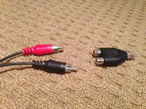

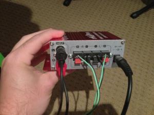

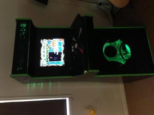

mameshane Posted January 16, 2013 Author Posted January 16, 2013 My amplifier turned up today. i have hooked it up to the 4inch speakers. sounds pretty good! at first i missed the bass i was getting from my 5.1 pc speakers, but after playing for a while, it didnt bother me at all. i didnt have the issue of needing to ground it to my motherboard some others had noted in another thread. i think its because im using a separate power brick from it and not power from the pc? i will find a spot and mount it inside the cab on the weekend. and take some better resolution photos. i have really been enjoying playing it now its pretty much a complete cab. My dad is even now contemplating wanting to make one for his place. i would like some opinions on if i should change the t-molding on the tankstick from the black it has now to the green to match the rest of the cab. or does it suit the black? the current t-molding thats in there is slightly different size, it has a thicker slot, and the green just wants to keep falling out, so if i did decide to change it to the green what are my options? glueing? is it hard to remove if its been glued in? My Cab.. 1-UP ARCADE new hyperspin irc details.. come hang out!
jq_quint Posted January 16, 2013 Posted January 16, 2013 My amplifier turned up today.the green just wants to keep falling out, so if i did decide to change it to the green what are my options? glueing? is it hard to remove if its been glued in? What amp you bought buddy? Cant you apply some tape to the back of the t mold to thicken it to help it wedge in place?
mameshane Posted January 16, 2013 Author Posted January 16, 2013 sorry forgot to post a link to it. I got this one. when applying the tape do u do it in small segments or along the whole length? My Cab.. 1-UP ARCADE new hyperspin irc details.. come hang out!
zauche Posted January 16, 2013 Posted January 16, 2013 I've bought such an amplifier on eBay: http://www.ebay.de/itm/Lepai-838-2-1-mini-Auto-Motorrad-Verstarker-car-amplifier-super-bass-de-/140753444758?pt=CE_Auto_Hi_Fi_Autoverst%C3%A4rker&hash=item20c58f1f96#ht_1539wt_1163 with the extra built in subwoofer chanel it has a lot of bass. (just the potentiometer for adjustment isn't chosen to well...) @mameshane: Why do the others connect the ground to the mainboard - are there any interferences ? I do have some light interferences sometimes - littele bit of crackling in the background. You can hear the crackling while copying files or moving windows on the desktop. Since it's not the Cinch Audio cable I know it's the fact that I power it via the computer power supply. I've a 12V power filter to stabilize the power supply and filter out the interferences for the audio amplifier. Hope that'll work...
jq_quint Posted January 16, 2013 Posted January 16, 2013 sorry forgot to post a link to it. I got this one. when applying the tape do u do it in small segments or along the whole length? I guess it depends how loose it is and in how many places....This process isn't reversible (unlike glueing) , so slap some on a trial section (say an 1" long) and see if that grips. Get this to work then repeat over longer lengths.. So on the amp - you just plugging that via 3.5mm jack / twin phono cable to your pc jack socket ?
Hyperion Posted January 16, 2013 Posted January 16, 2013 sorry forgot to post a link to it. I got this one. when applying the tape do u do it in small segments or along the whole length? That amp is pretty slick looking. With a face plate like that you could almost recess that in somewhere visible. My first cocktail cab: The Hyper Arcade Entertainment System Win 7 64bit | i5 3570K Overclocked to 4.2GHz | 16GB 1600MHz DDR3 | GTX 970 Strix | Samsung 250GB 840 Evo SSD + 8x4TB green drives in RAID 5 for XBMC/KODI
mameshane Posted January 16, 2013 Author Posted January 16, 2013 I guess it depends how loose it is and in how many places....This process isn't reversible (unlike glueing) , so slap some on a trial section (say an 1" long) and see if that grips. Get this to work then repeat over longer lengths..So on the amp - you just plugging that via 3.5mm jack / twin phono cable to your pc jack socket ? is that 1 foot or 1 inch? i always get confused with that yes, 3.5mm jack / twin rca adapter My Cab.. 1-UP ARCADE new hyperspin irc details.. come hang out!
monkeychunkuk Posted January 17, 2013 Posted January 17, 2013 Thanks for the amp pictures update,i may grab one of these were are you mounting it? And how are you changing the volume? Also what are you using to power it?
mameshane Posted January 17, 2013 Author Posted January 17, 2013 Thanks for the amp pictures update,i may grab one of these were are you mounting it? And how are you changing the volume? Also what are you using to power it? im just going to screw it to the inside of my cabinet, two sides of the amp have little tabs with holes pre made in them for easy mounting. it has volume/bass/treble dials on the front of it, i will just set these to the maximum i want to use, then use a volume adjusting ahk script to control the main volume in windows. (still got to find one of these, but i know there out there) and adjust the volume via control panel. but being a full size cabinet, i will have access to the controls if i ever need to adjust them again. also, if you have a look on there site, there are other mini amps like this available that even have remote controls and are still reasonably cheap... to power it i bought a ac power supply of the same people. heres a link to a search on that site that shows all the ones available so that you can get one for your region. My Cab.. 1-UP ARCADE new hyperspin irc details.. come hang out!
