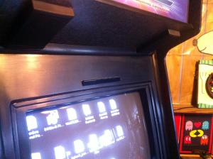

My recessed sensor bar above my monitor:
