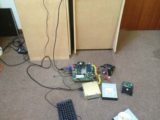

monkeychunkuk Posted January 30, 2013 Author Posted January 30, 2013 Not much progress today trying to install windows to one of the setups only to find it wont install windows 64 bit oh and the machine i had running i tool out the case and now it wont display on the monitor any more...oh and i blew up a power supply one of the screws landed on the pcb whilst it was on....never mind Mobo fun "What do you mean my parts are showing"

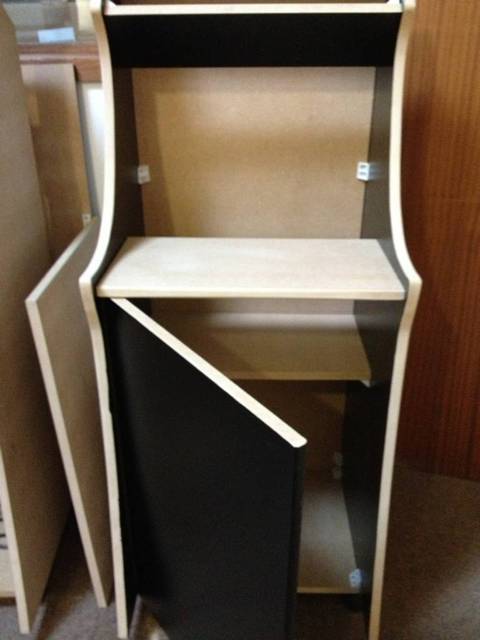

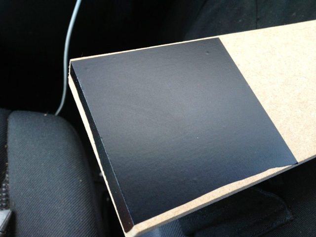

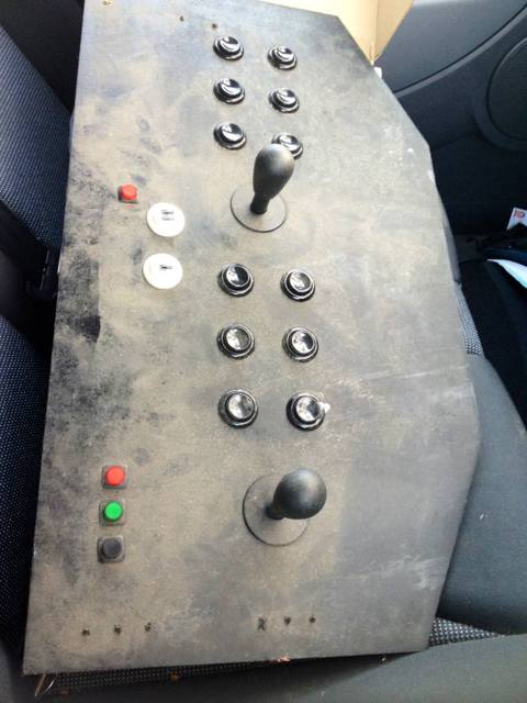

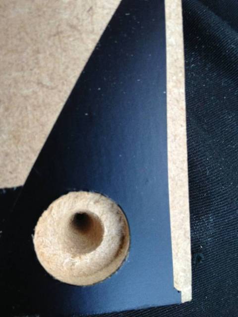

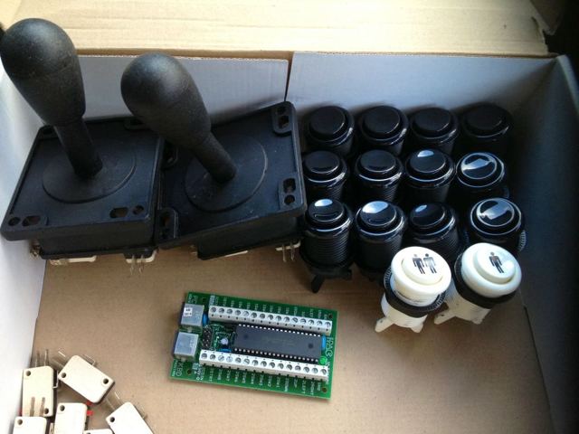

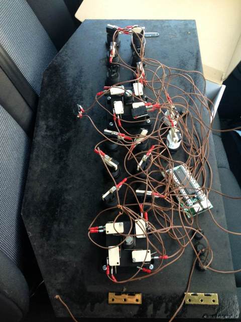

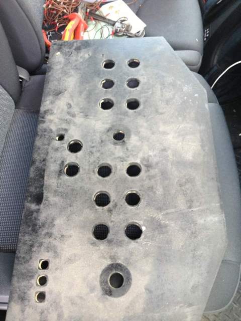

monkeychunkuk Posted January 31, 2013 Author Posted January 31, 2013 So i picked up my ebay purchase Little dusty Ive seen worse wiring Seems a shame to throw away this part i wonder how much fun its seen Bit of spit and polish and i have the perfect set up for the Star wars cab Anyone used these controls? On my travels I also picked up 10 metres of black matt vinyl to cover the machines were the artwork isn't. At £19 it was a risky idea but after a quick sample im really impressed with it Of course I'm going have to make sure the wood is smooth and blemish free Not bad at all it stayed put after i drilled a test hole and after i cut some shapes out of it

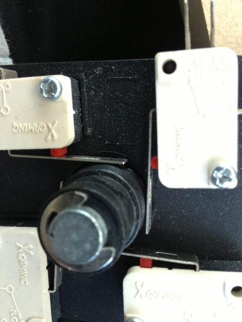

RidicRick Posted January 31, 2013 Posted January 31, 2013 X-gaming joysticks and buttons are my least favorite now that I have tried others. The buttons are loud and not that responsive or accurate. The joysticks have the same problem. But you might be able to make them better by getting higher quality micro switches. Definitely get quieter ones because you can hear those suckers clicking from a few rooms away.. LOL This is all just my opinion, but I have bought almost every brand button and joystick and I like to test this kind of stuff out. I don't have a life.. lol
monkeychunkuk Posted January 31, 2013 Author Posted January 31, 2013 X-gaming joysticks and buttons are my least favorite now that I have tried others. The buttons are loud and not that responsive or accurate. The joysticks have the same problem. But you might be able to make them better by getting higher quality micro switches. Definitely get quieter ones because you can hear those suckers clicking from a few rooms away.. LOL This is all just my opinion, but I have bought almost every brand button and joystick and I like to test this kind of stuff out. I don't have a life.. lol LOL funnt hte first thing i thought was how quite the buttons and joysticks where : ) ive been using these for the last 4months they REALLY click http://www.ultracabs.co.uk/ekmps/shops/ultracabs/images/standard-joystick-set-with-mixed-pushbuttons.-100-p.jpg
mikekim Posted January 31, 2013 Posted January 31, 2013 I had some x gaming sticks initally (you can see them on the fist post shots on my Retrocade thread), then swapped them out for Sanwa Joystick JLW-UM-8 x2. the difference between them is like night and day, the Sanwa's are soo much better.
monkeychunkuk Posted January 31, 2013 Author Posted January 31, 2013 Oh well at least i got some spares and a ipac
Silverback Posted January 31, 2013 Posted January 31, 2013 Ahh....so you're the one who picked up the control panel from Ebay. Did see it on there and was tempted but totally forgot about it. At least its gone to a good home!
mameshane Posted January 31, 2013 Posted January 31, 2013 I had some x gaming sticks initally (you can see them on the fist post shots on my Retrocade thread), then swapped them out for Sanwa Joystick JLW-UM-8 x2. the difference between them is like night and day, the Sanwa's are soo much better. did u replace them within a tankstick? I've been considering replacing mine... My Cab.. 1-UP ARCADE new hyperspin irc details.. come hang out!
mikekim Posted February 1, 2013 Posted February 1, 2013 no i initially bought an arcade bundle consisting of buttons and joysticks that contained the x gaming sticks. the mounting holes however are in the same position, so a tankstick joystick swap would be very easy.

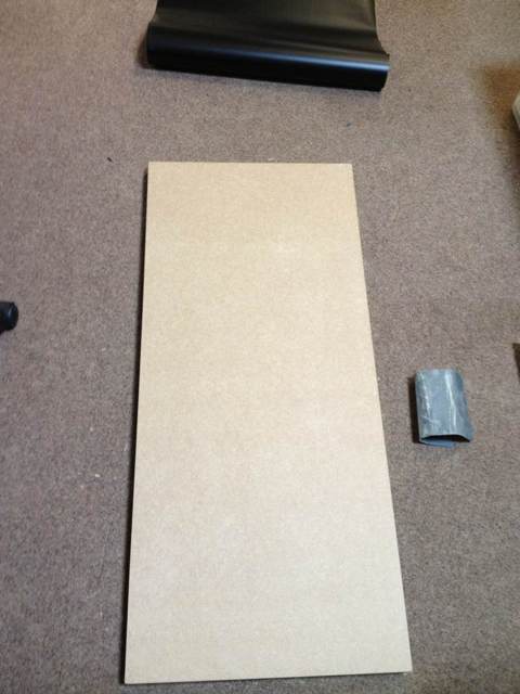

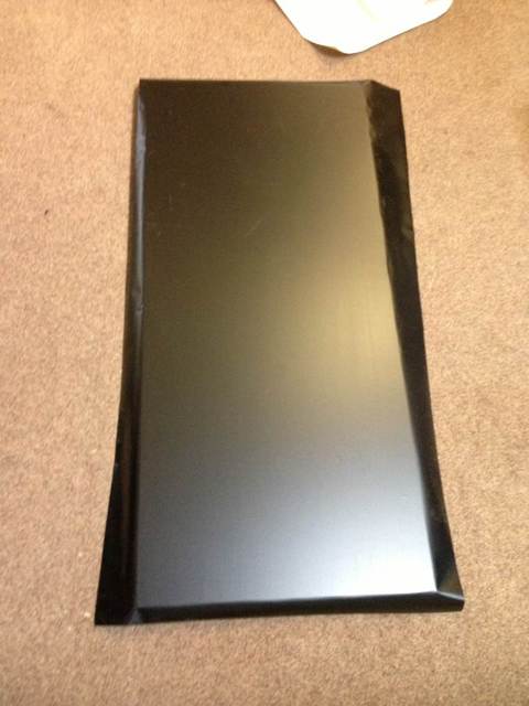

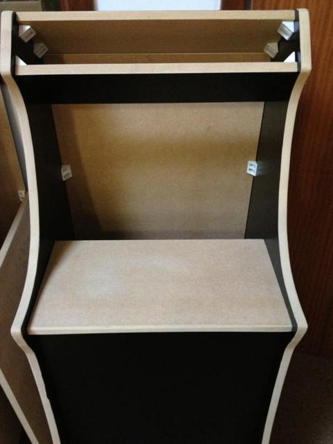

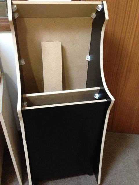

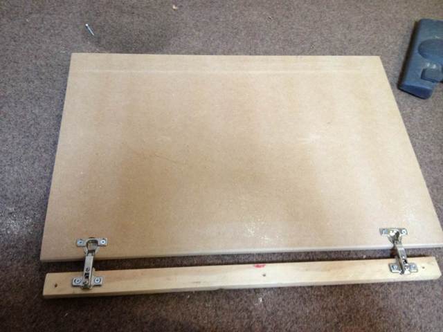

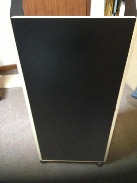

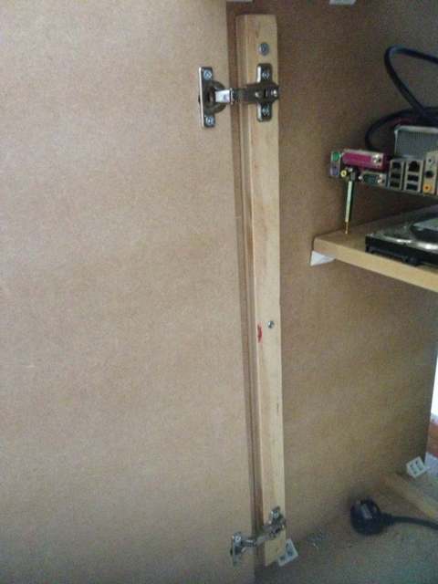

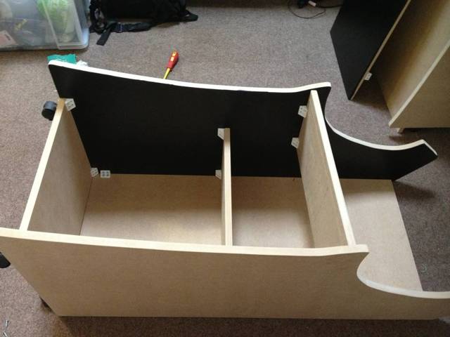

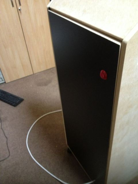

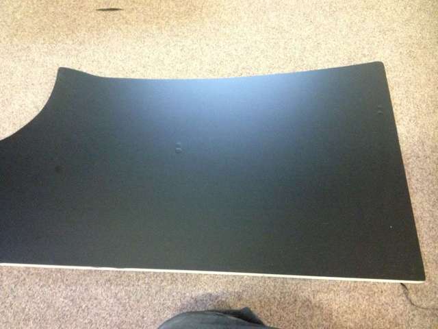

monkeychunkuk Posted February 1, 2013 Author Posted February 1, 2013 So i broke out the vinyl today Prepared back panel sanded with fine wet and dry Vinyl applied Side panel (the bump is a fixing hole) Side panel back in place All parts back in place I also fitted hinges on the door not my best work So the final thoughts on vinyl its much cleaner than spray/paint and i think it maybe a lot cheaper £19 will cover both machines,but the surface has to be perfect i had to refit a whole piece because a bit of wood dust got in the way and it really stood out if it had been paint i could have rubbed it down and did a touch up, Ill be a lot happier when i have the groove cut and the t molding fitted i plan to do this before the side art goes on

ericleroi Posted February 2, 2013 Posted February 2, 2013 Great stuff monkey. Vinyl sure does cut out a lot of work provided you get all the dust and lumps out of the way. I suggest this on every other post seemingly ... have you checked out blackboard vinyl? I find it really does give a great finish - more of a laminate look. Edit: Also, making the edged rounded (very, very slightly) or bevelling helps in applying the vinyl and avoid bubbling. Pulling the vinyl slightly (blackboard vinyl is tougher/thicker) whilst applying also helps with this.
monkeychunkuk Posted February 2, 2013 Author Posted February 2, 2013 Ohhh sounds interesting got a link to the black board stuff? Thanks for tip on rounding the edges,it something i do out of habit any bit of wood i cut i run a bit of sandpaper over it ; )
ericleroi Posted February 2, 2013 Posted February 2, 2013 Yes, sure. I get it from here: http://www.mdpsupplies.co.uk/blackboard.asp You could source a smaller piece from ebay first if you don't want to shell out a lot for something you may not be sure of: http://www.ebay.co.uk/itm/A4-SHEET-OF-BLACKBOARD-SELF-ADHESIVE-VINYL-CHALKBOARD-/200634481415?pt=LH_DefaultDomain_3&hash=item2eb6bf3b07 It has a slightly textured finish to it so it's less prone to showing greasy fingerprints. A few pics here may give an indication of the finish you can expect to get: Edit: Buying from the supplier in the first link actually works out at a reasonable cost if you buy a good run of it - the last order I made was for 5 continuous meters with a 1m or so width.

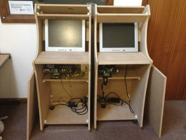

monkeychunkuk Posted February 3, 2013 Author Posted February 3, 2013 Cheers,im lucky as my job makes me drive all day so im all over the country, so i can just tap in my current location and see whats up for grabs Ive spent about £120 i have 5 monitors i can use but motherboard stuff is a bit of jumble, out of the lot i have 2 hard drives that will fit my needs,only have one psu working lots of odds and sods of ram im still not sure if they will be good enough for the 4 cabs i plan to build Do i get back on gum tree and pick up some odds and sods or do i pay the money and buy a new mobo from novatech like i have running well in my retro cade ???

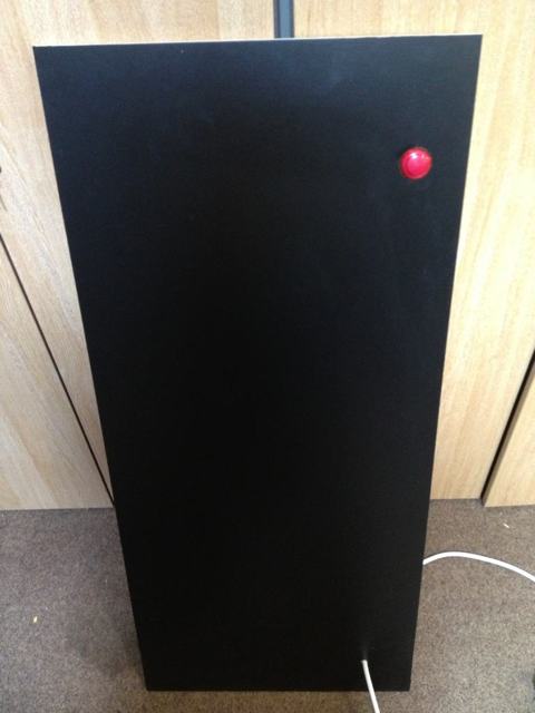

monkeychunkuk Posted February 7, 2013 Author Posted February 7, 2013 Really slow progress this week what with life getting in the way but i did fit the power lead and power button
