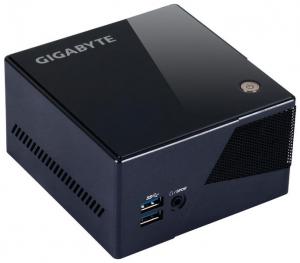

So I bit the bullet and I went and brought a "Gigabyte Brix 2807" which has Intel HD on-board graphics.
I installed windows 7 64bit, downloaded and installed HyperSpin and HyperLaunch and crossed my fingers. I launched HyperSpin and all the videos were a garbled mess, so I followed the instructions from an above post by "jumpingjay" and now......all my .mp4 videos are playing perfectly!!!
A big thanks to everyone who help contribute and solve this problem!
Just a confirmation: the little tweak app from BenjaminLSK worked perfectly for me. Currently running HyperSpin on a Gigabye Brix Pro HTPC (model GB-BXi7-4770R) which uses Intel's Iris Pro graphics chipset. OS is Windows 8.1 Pro x64. post-25116-142870676536_thumb.jpg
HTPC: Gigabyte BRIX Pro w/Intel Iris Pro graphics, Windows 8.1 x64/8gb RAM
