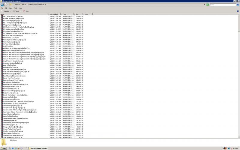

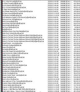

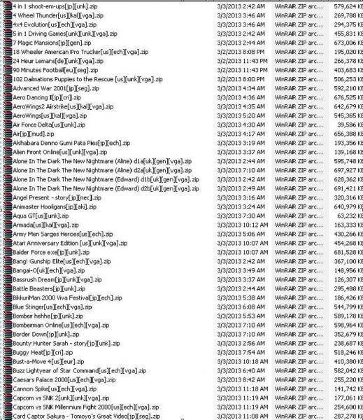

Not sure if I've experienced a limitation or simply just unsupported?
I am attempting to use your latest beta/tools against the Pleasuredome Dreamcast set. There's only one setting that picks up any games (System - Other) and combined with fuzzy match it finds 3 games out of 347.
I've tried any and all combinations - setting extension to zip instead of *, trying all different romset extensions - etc.
PD uses this type naming convention - 102 Dalmations Puppies to the Rescue [us][unk][vga].zip
They typically contain .cdi, .mds/.mdf and IIRC there's a few .NRG's in the mix as well.
So the question is - am I doing something wrong or is this not implemented/supported?
Thanks.
post-10574-142870607187_thumb.jpgThe files inside the zip as I explained earlier are MOSTLY .cdi
A fewer amount of images are Alcohol 120 .mdf files
Lastly a small handful or NERO .nrg files
As far as naming convention - yeesh. No idea honestly only a guess.
Cannon Spike[us][ech][vga]
Name of game - NTSC - Group who created - (VGA NO IDEA)
The problem is there appears to be a bunch of different naming conventions going on.
