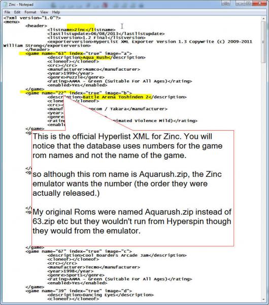

I read the official Hyperlist XML script and it clearly shows that the roms are numbered and not named.
[ATTACH=CONFIG]31261[/ATTACH]

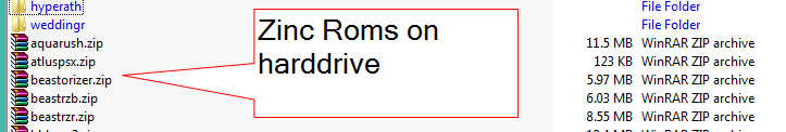

However, my roms were named:
[ATTACH=CONFIG]31262[/ATTACH]

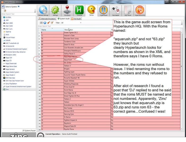

This obviously clashed with the official XML as it was looking for numbered ROMS and not names. Therefore the Hyperlaunch HQ game Audit showed 0.
[ATTACH=CONFIG]31263[/ATTACH]
However, I tried renaming the XML from numbers to names and that didn't work. The only way roms would run was if they were names.

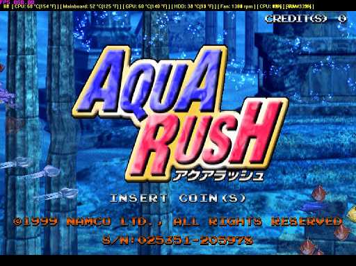

This is aquarush.zip running - 63.zip would not run.
[ATTACH=CONFIG]31264[/ATTACH]

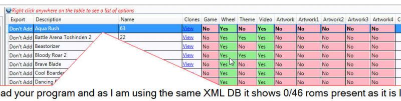

When I load your program it uses the same XML program and therefore shows RED cells indicating that there are no roms available.

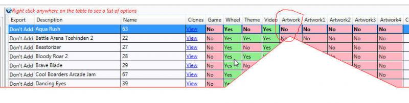

[ATTACH=CONFIG]31265[/ATTACH]
The Wheel and Video for aquarush are green but that is because they are numbered 63.png and 63.mp4. If I name them then HS doesn't see them because of the XML entries. Confusing hey?

The next issue I saw was that I have both vid snaps and stills in the same folder as we are supposed to, so that if there is no video available it displays the still. However, regardless of whether there is video or not the video cell is green - ONLY if there is a still present. If there is neither still nor video then it is red. But either then green.
Would it be possible to have separate cells for still and video? I would like to know if I only have a still without having to run HS or go looking.
Can I ask you why the Artwork cell remains red even if there is a still available - it only goes green if there is artwork in 1-4.
.[ATTACH=CONFIG]31266[/ATTACH]
