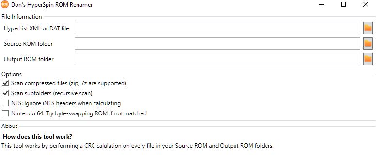

I grabbed the latest Nintendo Game Boy XML and trying to rename ROMs. It errors with "An item with the same key has already been added". I'm assuming this is a problem with HyperList's database?
All Games.xml works ok but is missing a lot of what Nintendo Game Boy XML has.
The MAME database from HyperList is crashing Don's Renaming Tool.
HyperList XML: G:\HyperSpin\Databases\MAME\MAME.xml
Source ROM folder: G:\ROMS\MAME 151
Output ROM folder: G:\Temp\Output
Hitting scan immediately crashes it.
Other databases from HyperList don't crash it.

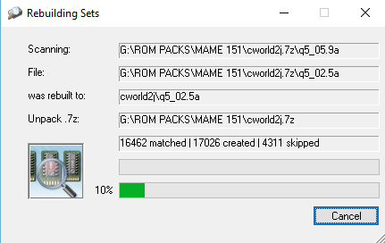

Is there a good tutorial for clrmamepro anywhere? My ROMs are version 0.151 and I do have the update packs (MAME0.155-0.156, MAME0.156-0.157, etc). I'd like to get to at least 0.170, if not the latest.
I also split the set. This is getting so damn frustrating. Working with HyperSpin as a whole is an exercise in frustration.
I did both, I did merged thinking it would be cleaner, then did split, THEN followed your advice and got the 0.173 set.. heh. It's still copying to my ROM drive but hopefully it works.
I started with Gigapig's base install which has MAMEUIFX 0.170 so I need to upgrade. I really haven't done much with high scores, controller configs, etc. I'm assuming it's safe to just overwrite everything in HyperSpin\Emulators\Mame?

Hi, I have a problem, that the Renamer crashes almost everytime for me. I'm trying to go through the Good Roms Snes Rom Pack, and it crashes always at 60 something percent...
It does not crash per se, it gets stuck, if i close the scanner, it responds, but i get no progress...
Any Idea on why it may be?
5 hours ago, RLBradders26 said:
@Deblintrake09 I'm not sure how to fix your issue with with the renamer but there are packs out there where everything is named correctly so you don't have to bother with any of that renaming crap.
This. I've never had to rename a single game.
