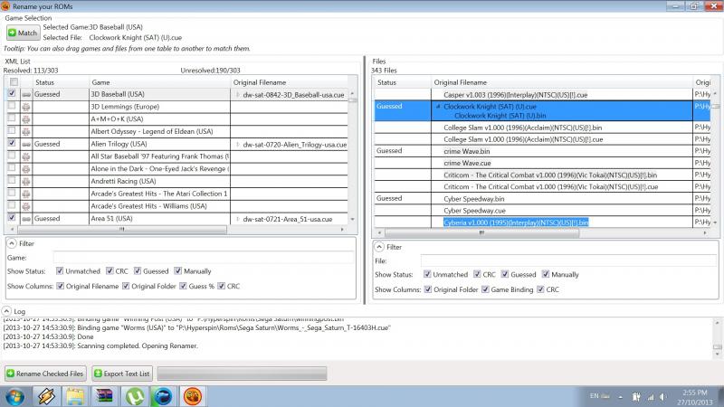

MaskedMavel Posted October 27, 2013 Posted October 27, 2013 Sorry if I didnt explain that very well. This is what my results look like: Not sure if its something I'm doing or maybe just because this set it so messed up, but as you can see most games don't have the .bin files nested beneath the .cue files in the list. Should I be renaming the .cue files or will I have to rename both? Thanks
emb Posted October 27, 2013 Author Posted October 27, 2013 The bin files are not nested under the cue files because your cue files are invalid. If you open crime wave.cue you will see that it does not point to crime wave.bin. it might point to some kind of absolute path instead of a relative path. The tool assumes your cue/bin files are functional and intact beforehand. Fixing any cue file requires manual intervention. Sent from my SPH-L720 using Tapatalk 2 %5BSIGPIC%5D[/sIGPIC] Download HyperSpin Tools and check out my MAME cabinet

MaskedMavel Posted October 28, 2013 Posted October 28, 2013 FILE "C:\DOWNLOADS\UPLOADS\SATURN\ISO\CRIME WAVE.BIN" FILE "D:\GOZILLA\CYBER SPEEDWAY.BIN" BINARY .... Yeah How do sets like this get out there in the first place? So I guess I should rename the .bin files first and then the .cues?
emb Posted October 28, 2013 Author Posted October 28, 2013 Yea, there is a lot of crap out there on the internet. Fix the cue file first (easiest way would be to create a folder, move the cue file into it, move the children into it, and manually update the cue file to point to the new files without the folder names). Otherwise, there might be a third party tool for this. Run the rom renamer once all the cue files are repaired. Sent from my SPH-L720 using Tapatalk 2 %5BSIGPIC%5D[/sIGPIC] Download HyperSpin Tools and check out my MAME cabinet
