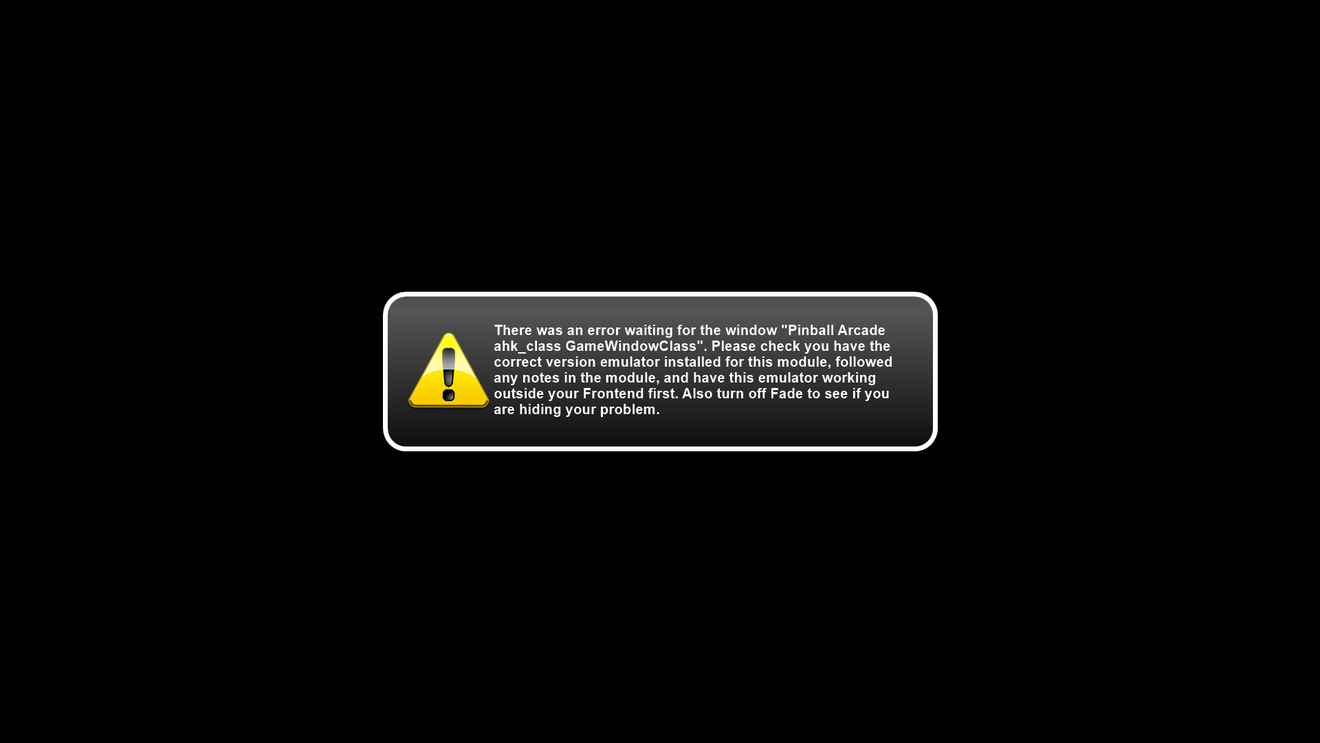

Hi all,
Could anybody shed some light on this. Pinball arcade works. It automaticallly selects the right table and starts the game, but after a while I get an error message. Does anybody know how to fix this? Thanks in advance!
PS i'm using the DX9 version

AHK_Class_Gamewindowclass is the DX11 version.
Sounds like you have your module settings set to DX11 instead of DX9. So Rocketlauncher is waiting for the DX11 version to execute, but it never does. Check the module settings and make sure DX9 is selected correctly.
What's weird about that is the DX9 version you're launching shouldn't be auto-selecting the table then.

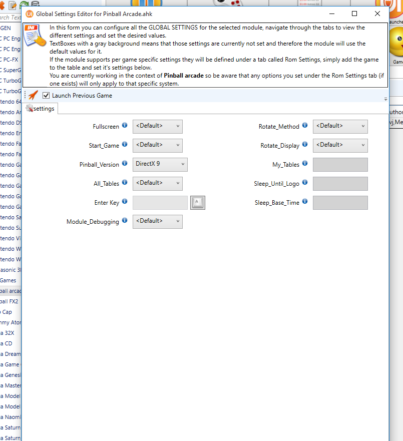

Could you please tel me how to set it to DX9, because that's the version I have.Thanks in advance!
Build your cabinet, conquer the codes, become a King of Chaos!
The module settings are in the same spot as they are for all systems.
In Rocketlauncher go to modules and click on the module settings tab. This will bring up the screen with the different settings mentioned in the module instructions. If you haven't already read the instructions then this is also the place you can click on the module instructions to read what you're supposed to do. You might also read my tutorial below if you haven't already.
http://www.hyperspin-fe.com/topic/10656-quick-tutorial-for-setting-up-pinball-arcade/?hl=%2Bpinball+%2Barcade+%2Btutorial
One of the settings is DX9 or DX11. I believe the default is DX9 though, so if you haven't already gone through these settings something else may be causing it to be looking for the Dx11 version, but I'd start there. If you're using an "unofficial version" that could be the issue too.

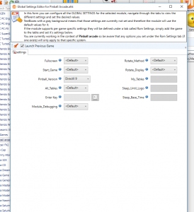

Hi Thanks for your reply. I fallowed the steps again with your tutorial, but still the same. And yes I am using a "special" Steam version :) It's version 1.41.12. Any idea how to get this to work anyhow?

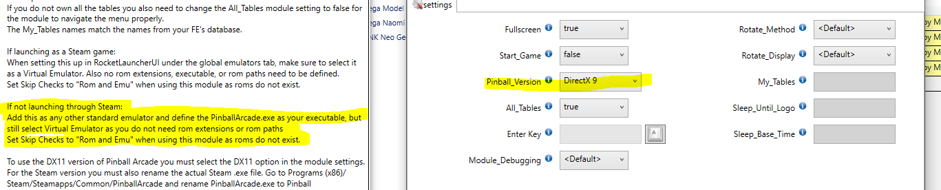

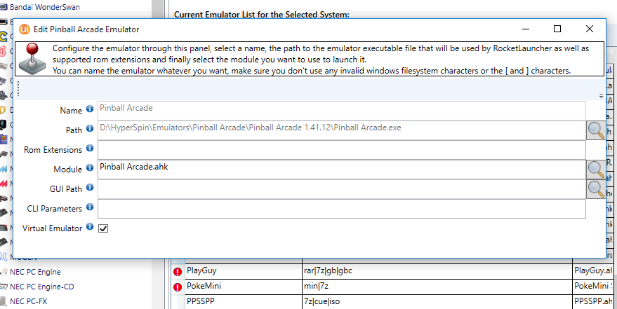

Here's what your module settings should look like and I highlighted part of the module instructions that applies to your version.
It's also possible that they screwed up the exe of your version and got the DX11 and DX9 window classes mixed so you might try changing your settings to DX11 instead of DX9 and see if that is the issue.

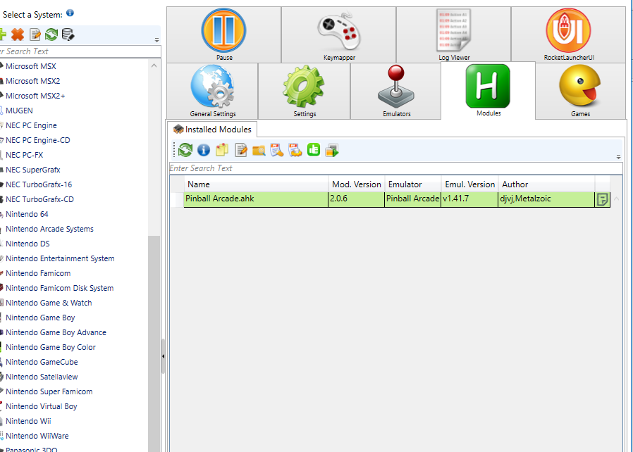

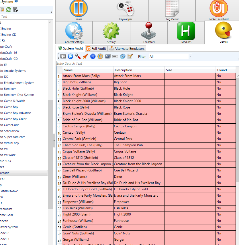

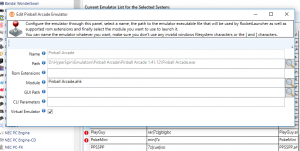

Hi Metal,
Thank you very much for your time and effort. I made some screenshots and have a log here for you. I hope it makes some sense? Thanks again.
Yes I am using the latest module and it shows up green.
Here are the screenshots:
Here is the log file

From looking at that log everything seems to be working correctly, although I did notice you have a couple naming issues to check. Here's the part of the log showing it looking for (and finding) the correct DX9 version (Waiting for "Pinball Arcade ahk_class Pinball Arcade"). No where in this log was it even looking for "ahk_class Gamewindowclass" which is the DX11 version error you posted the screenshot of. However it looks like you started and exited the game immediately before it ever gave you the error? Can you run it again, but let it run until you get the error screen again so I can see if the log shows what caused it?
Also check your names. Your .exe has a space in it (Pinball Arcade.exe). Try changing it to PinballArcade.exe with no space and update the path. Also your database shows that you don't have the "a" in arcade capitalized, so you actually have it as Pinball arcade (instead of Pinball Arcade)? Shouldn't matter for what we're checking, just pointing it out because having different caps in names can really screw up Hyperspin database/media/emulator stuff if they don't match exactly. If that's how all your folders/media etc are already titled then you should be fine.

Thank you Metal! I had to rename the exe to PinballArcade.exe without the space and it worked! Thanks again!
Awesome! I had a feeling that was it, but wasn't 100% sure and didn't want to get your hopes up if I was wrong.
Glad it's working. I'll add that it must be named correctly to my tutorial.
