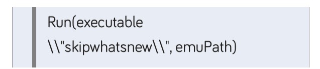

Metalzoic Posted July 5, 2015 Author Posted July 5, 2015 I am using your modded one from post 122. The // were in your post 180 Are you talking about the commas? Those need to be in that line. djvj didn't write that line, I did. That's the line that makes the Whats New page stop popping up on the Steam version Steam(238260,,"skipwhatsnew")The other line is the one we're trying to get working for your stand-alone version and it didn't work with those commas Run(executable "skipwhatsnew", emuPath)
Metalzoic Posted July 5, 2015 Author Posted July 5, 2015 Is it possible to get it working without RL? I am trying to avoid upgrading as of right now. However I was debating just buying another ssd and attempting a second hyperspin setup with RL until I get everything migrated the way I want. It would honestly only be to get arcade pinball working with each table. The new module from metalzoic errors out for me and I realized it was asking for features HL doesn't have. What does the error say? You don't need to have RocketLauncher. I just tested it in HyperLaunchHQ and even the newest module worked perfectly in both HyperLaunchHQ and RocketLauncher.
potts43 Posted July 5, 2015 Posted July 5, 2015 No I meant the double back slashes....what are they for as they seem to be missing or removed. (I'm not a scriptwriter)
Metalzoic Posted July 5, 2015 Author Posted July 5, 2015 No I meant the double back slashes....what are they for as they seem to be missing or removed. (I'm not a scriptwriter) I don't know man. I just did a search of both modules and there aren't any double backslashes in either one of them even once. They both have a double forward slash (MURL = http://www.pinballarcade.com/), but that's just for a website url and not any of the actual script
potts43 Posted July 5, 2015 Posted July 5, 2015 Post 195 has \\ No matter[emoji51] Don't know why they aren't being typed above either but showing code on my tapatalk post
Metalzoic Posted July 5, 2015 Author Posted July 5, 2015 Post 195 has \\ No matter[emoji51] Don't know why they aren't being typed above either but showing code on my tapatalk post Wow... weird man. They must be caused by tapatalk because those don't exist in the actual module or in the posts when viewed on a PC. We were seeing 2 different things. Now we know not to read code from tapatalk. Ha! I'm glad you figured that out or we'd be confusing each other for days!
