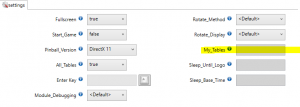

BlackPredator72 Posted July 27, 2016 Posted July 27, 2016 Ahh getting crazy, struggling all day with this, reading all 12 pages and trying things but without luck: I downloaded the 1.49.9 non-steam version and updated with seperate files to 1.50.10. DX9 and DX11 are working outside RL/HS. Copied your .ahk and .isd in the Pinball Arcade module folder. Renamed my PinballArcade11.exe to PinballArcade.exe Edited the Pinball Arcade Emulator screen as show in your example and added the path to my exe: G:\Emulators\Pinball Arcade\PinballArcade.exe In RL set to Rom Only and Mute Emulator on Fade to True Changed all module settings as told (added Enter key as my Enter Key, My Tables empty and All_Tables to True) Downloaded your XML When I select a game from RL, Pinball Arcade is starting, the Mute is working, after a while the Mute ends but nothing happens after that. It's not browsing to the right table. It just stays on the 1st Start Screen. Also the Esc is not working when in-game, I'll have to click on Exit Game to exit. So it looks like the module isn't working at all. However the No-Nag is working when starting from RL. Last thing I tried was (after reading the module info, was giving RocketLauncher and PinballArcade admin rights....and after that...it worked.....pffffff.....maybe also something for your tutorial. So maybe djvj and you can update the module to the latest (working) version to 1.50.10 and change the module info to Rom Only (for non-steam users). PS. is there a video pack for the tables somewhere? My Gamercard

newgames46 Posted October 17, 2016 Posted October 17, 2016 I have been trying to get this to work for a couple of days now I have pinball arcade version 133 I've got it to select certain games but some games it's one game off my database and everything across-the-board is exactly the same I have tried true false combinations in the rocket launcher module to no avail I've added one in increments to the sleep timer and it's only made it worse does anybody have a solution for this or do I have to get a new version of pinball arcade which I don't know how I'm going to do this unless I use my steam version and I'm sure that's not going to work properly either
Metalzoic Posted October 17, 2016 Author Posted October 17, 2016 On 10/17/2016 at 4:06 AM, newgames46 said: I have been trying to get this to work for a couple of days now I have pinball arcade version 133 I've got it to select certain games but some games it's one game off my database and everything across-the-board is exactly the same I have tried true false combinations in the rocket launcher module to no avail I've added one in increments to the sleep timer and it's only made it worse does anybody have a solution for this or do I have to get a new version of pinball arcade which I don't know how I'm going to do this unless I use my steam version and I'm sure that's not going to work properly either133 is really old so might be hard to say. Obviously you need All_tables set to false for an old version (as it will be missing several newer tables). And you need your database, My_Tables list and first table to match exactly to what you actually have. If your problem is that your table selection is always off by one that would imply you're either missing listing a table, have one mis-named or have an extra added that you don't actually have. 1. You have listed all of the tables you own, in the correct order, in the module settings for My_Tables? 2. You're database has only those same tables in it, same order and names match exactly? 3. You either have Adams Family and its your first table or you have changed your first table setting to what it actually is like the module instructions say? Sent from my SM-G935V
newgames46 Posted October 17, 2016 Posted October 17, 2016 All the tables in my database, my tables, and module are all the same and in the same order. I cannot set all tables to false because it will not work at all. I have it set to true and it works up to the table haunted house then it goes back one up till about 5 tables later.. I've tried a few different current modules 149 to 150 with the same result. I'm using Windows 8 and have doubled and triple checked all that's in the guide.. But I don't understand whe if I turn the all tables to false it won't even start? Hyperspin looks really nice and would love to set my arcade up with it but I've run into so many issues.. I'm trying to set up a cab I built using led Blinky and rgb buttons, I've purchased all front ends to include launch box/ big box which I'm really interested in and may go back to but led Blinky is another issue trying to detect a game like pba but doesn't see it so I can't set the buttons. That's why I'm trying hyperspin again but problems always come up. I'm at a loss .. This has been a 2 year project with no success
Metalzoic Posted October 17, 2016 Author Posted October 17, 2016 On 10/17/2016 at 2:55 PM, newgames46 said: I have it set to true and it works up to the table haunted house then it goes back one up till about 5 tables later.. Yes, that's exactly what you'd expect it to do If you have the All_Tables setting set to true, but don't actually have all the tables. So that is working correctly. You should have All_Tables set to false and you should have manually typed in all the tables you actually have into the All_Tables section of the module settings, highlighted here: If you've done that, and done it correctly it should work like a champ. If it still doesn't then it could be because you're trying to run such a crazy old version of the game (you're version is pre-module, pre-DX11 I believe). Your version is so old it's possible it may just be mismatched somehow (at one point they changed where the buttons were in the games UI). Personally I'd say update your version to as close to 1.50.10 as possible and see if it's all fixed. Or you can post me a pic of your main menu screen so I can see what your UI looks like.

Metalzoic Posted October 17, 2016 Author Posted October 17, 2016 On 10/17/2016 at 4:49 PM, newgames46 said: It looks like it's starting to load but stays on the table screen so you can spin to another table doesn't look like it even tries So it actually navigates properly into the table select screen (where it can scroll up/down through the tables), but then it just sits on the first table and doesn't scroll at all or even start the table it's sitting on? EDIT: Wait, are you actually saying that it stays in the Hyperspin wheel and doesn't launch the game at all? Be very specific.
newgames46 Posted October 17, 2016 Posted October 17, 2016 Yes it's not launching at all when I set the module to false for having all the tables but if it's true it launches and works right selecting the tables up to a certain point but I know I don't have all the tables and it needs to be set to false ?
Metalzoic Posted October 17, 2016 Author Posted October 17, 2016 OK then I think I know what's happening. Your version probably has the old UI. So when you have it set to true the game is launching and instead of the module navigating to the table select menu its navigating to the exit button and selecting that and closing the game. Possibly doing all that behind the RL fade screen so you never even see it happening. So the problem is how old the version is. Running a much newer version would fix that or if you send me a screens shot of your main menu I could probably whip you up a custom version of the module that works with your game. Sent from my SM-G935V
