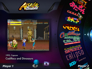

moleboyz101 Posted September 3, 2015 Posted September 3, 2015 Is there a way to change the game info lettering? Like in the attached picture how do you change the "1993, Capcom / Cadillacs and Dinosaurs" font?
Black Hazor Posted September 3, 2015 Posted September 3, 2015 Yes you can change it but u have to do it for every system, its not a global option. U can do it in the folder Hyperspin/Settings - each system has a ini file and the last section of it is the text... I use this one for everything looks fine for most of the Themes. [Game Text] game_text_active=true show_year=true show_manf=true show_description=true text_color1=0xF3FF00 text_color2=0xFF7300 stroke_color=0x000000 text_font=Style4 text1_textsize=20 text1_strokesize=7 text1_x=40 text1_y=675 text2_textsize=32 text2_strokesize=7 text2_x=40 text2_y=700
Styphelus Posted September 3, 2015 Posted September 3, 2015 You can but there are only 4 different fonts to pick from. See post above.

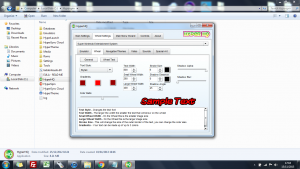

Retro Goonie Posted November 15, 2015 Posted November 15, 2015 Is messing with the .ini file (like in previous post) the only way to do this, as I've tried changing the "sample text" inside HyperHQ but it never takes effect?! My Artwork! Carts: GCE Vectrex 2D Carts (Realistic Version) 1.0, GCE Vectrex 2D Carts (Vector Version) 1.0 Pointers: NEC PC Engine Pointer(s), NEC SuperGrafx Pointer(s), Sega SG-1000 Pointer(s), Sega TecToy Pointer(s), Sega Mega Drive Japan Pointer(s), Nintendo 64 Pointer(s)
Retro Goonie Posted November 15, 2015 Posted November 15, 2015 Those settings change the wheel text (the text that displays the game name if you don't have a wheel image). Aahh...my bad! Thanks for the heads up! My Artwork! Carts: GCE Vectrex 2D Carts (Realistic Version) 1.0, GCE Vectrex 2D Carts (Vector Version) 1.0 Pointers: NEC PC Engine Pointer(s), NEC SuperGrafx Pointer(s), Sega SG-1000 Pointer(s), Sega TecToy Pointer(s), Sega Mega Drive Japan Pointer(s), Nintendo 64 Pointer(s)

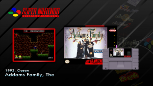

KRIS85 Posted November 5, 2017 Posted November 5, 2017 Hello It is possible to replace year manufacture or years underneath ?
richie_jones Posted November 5, 2017 Posted November 5, 2017 4 hours ago, KRIS85 said: Hello It is possible to replace year manufacture or years underneath ? Edit the database for this
Yeuxkes Posted November 5, 2017 Posted November 5, 2017 4 hours ago, KRIS85 said: Hello It is possible to replace year manufacture or years underneath ? Ignore Richie's reply above me, I think he is missing the point. Yes you can change the font for year and manufacturer. It's done by editing the settings file for that system. You want to scroll all the way down and edit the game text section. It uses the same parameters as the wheel text.
KRIS85 Posted November 6, 2017 Posted November 6, 2017 23 hours ago, Yeuxkes said: Ignore Richie's reply above me, I think he is missing the point. Yes you can change the font for year and manufacturer. It's done by editing the settings file for that system. You want to scroll all the way down and edit the game text section. It uses the same parameters as the wheel text. I know but I do not understand, I mean to switch to first show the manufacture a later year or under the years
Bungles Posted November 7, 2017 Posted November 7, 2017 I think the field location is set in stone. However you could just put the manufacturer in the years location and put the year/date in the manufacture location in the Database. Not to sure if there is a way to add a break like /n etc. Retro Cafe - Universal ThemeHyperControl - Main Menu Config and Apps WheelAudiocade - Main Menu Music PlayerTelltale Games WheelPCGamers Top 100 PC Games 2014 WheelMGS HD Exit Screen8-Bitdo Special ArtAll Contributions My Youtube Channel - https://www.youtube.com/user/3ungle
richie_jones Posted November 7, 2017 Posted November 7, 2017 45 minutes ago, Bungles said: I think the field location is set in stone. However you could just put the manufacturer in the years location and put the year/date in the manufacture location in the Database. Not to sure if there is a way to add a break like /n etc. Yep, like I said edit the database, you can put whatever you like in the manufacture and year fields....
KRIS85 Posted November 7, 2017 Posted November 7, 2017 11 hours ago, richie_jones said: Tak, jak już powiedziałem, edytuj bazę danych, możesz umieścić to, co lubisz w polach wytwarzania i roku. I know but with such a big list it will take me years, so I'll probably F. it Thank You for the quick reply
Bungles Posted November 7, 2017 Posted November 7, 2017 Not sure if there would be a way to script the swap of information. Maybe if you could tabulate it in excel or import it to SQL. But perhaps too much work for too little return. Retro Cafe - Universal ThemeHyperControl - Main Menu Config and Apps WheelAudiocade - Main Menu Music PlayerTelltale Games WheelPCGamers Top 100 PC Games 2014 WheelMGS HD Exit Screen8-Bitdo Special ArtAll Contributions My Youtube Channel - https://www.youtube.com/user/3ungle
