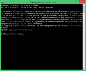

rfancella Posted May 26, 2014 Author Posted May 26, 2014 Version=WinUAE 2.7.0 (2013.12.05) is the version I am currently running Ron. Sorry its taken me so long to get back to you. Bank Holiday weekend over here and there was far too many beverages being passed around to say no As for the command line Im not sure when it comes to this thing. I cut and pasted into the CMD Prompt but it just comes back saying its not a batch file? Hhhmmmm.. Is the emulator located in "P:\Hyperspin\Emulators\Commodore Amiga\WinUAE\winuae.exe"? Is HyperSpin located in "P:\Hyperspin"? Can you post a screenshot of that command line and the error? Thanks, Ron Code Monkey and all around Command Line geek!If you like what someone has said or done for you, be sure and 'Thank' them. And if they changed your life, send them a Beer!

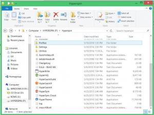

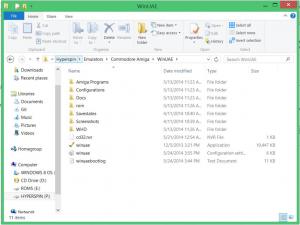

SIMPLYAUSTIN Posted May 27, 2014 Posted May 27, 2014 Yes that is all correct? WinUAE loads fin if I run it out of HS and through HLHQ.... well it still waits for HLHQ to run the error and then kicks in... but yes it does run? Here is a screen of everything I can..... MY CMD line.... Here is My HS folder..... And here is my Amiga Folder...... I just cant seem to see where the error is? Simply Austin's YouTube
marxkemp Posted May 27, 2014 Posted May 27, 2014 Maybe the space between commodore and amiga when i look at the cmd, but im just guessing here
Turranius Posted May 27, 2014 Posted May 27, 2014 Indeed. "P:\Hyperspin\Emulators\Commodore Amiga\WinUAE\winuae.exe" -f "P:\Hyperspin\Emulators\Commodore Amiga\WinUAE\Configurations\host\amigahost.uae" -s quickstart=a1200,1 -s use_gui=no -s gfx_fullscreen_amiga=true -s cycle_exact=true -s immediate_blits=false -s cpu_compatible=false -s cpu_speed=real -s cachesize=8192 -s filesystem=rw,WHD:"P:\Hyperspin\Emulators\Commodore Amiga\WinUAE\WHD" -s filesystem=ro,Games:"P:\Hyperspin\Emulators\Commodore Amiga\WinUAE\rom\4DSportsDriving_v1.0_1461.zip" -portable Mame related stuff: FTP: grandis.nu, port 21, user:misc, pass:misc http://grandis.nu/software Tur-Matcher - Match your roms/media/XML files. Another Idle Volume Adjuster - Automatically control the volume. How to: Use MAME Extras as material for HyperPause How to: Use eXoDOS 2.0 as material for HyperPause
SIMPLYAUSTIN Posted May 27, 2014 Posted May 27, 2014 Haha! yeah thats got it working! For some reason though its still loosing focus when I load a game? Simply Austin's YouTube
