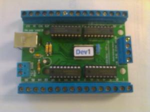

shilmover Posted November 17, 2010 Posted November 17, 2010 Chris, You suck! Stop teasing us! Seriously, though, it looks great! BTW, I just got my LEDWiz boards today. I actually bought 4 (by accident)... I bought 3 off someone that bought them a bit a go and ended up not using them. After talking to him, he figured that they were v1, so I got them cheaper than the v2. I then ordered a v2 from GGG. Well, the three came in today and they are v2! Large chip v2, but v2! So while I needed a couple of other projects, I have an extra one or two if people need them...
chriz99 Posted November 17, 2010 Author Posted November 17, 2010 ... Well, the three came in today and they are v2! Large chip v2, but v2! ... good info, could you post a pic of the large chip v2? thanks cheers chris [sIGPIC][/sIGPIC] * taito egret 29 candy cabs * indy & star wars pachinkos 17" bartop with ledwiz rgbleds * 10" bubble bobble & galaga bartop * arm champs 2 check out hi-res backglasses * best vpin performance * ledwiz config and software
shilmover Posted November 17, 2010 Posted November 17, 2010 good info, could you post a pic of the large chip v2?thanks Here you go. Sorry for the Mobile phone picture (getting my new phone tomorrow). I can post a better one later if people want me to.

luvthatapex Posted November 18, 2010 Posted November 18, 2010 My LEDWIZ hasn't been delivered but I got this from Randy at GroovyGameGear: Hi Frank, I think someone is spreading some misinformation out there. We are only shipping "the small chip version" now. I would appreciate it if you could relay this to the source of this information. It's not necessary to request it. Additionally, there was actually a "large chip" version which also had the "Voltage Select" connections, which is the only difference in board versions. We haven't produced the earlier "single voltage" version (which was still multi-voltage compatible) for a very long time. Thanks, RandyT
