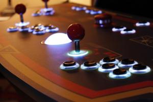

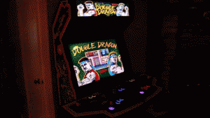

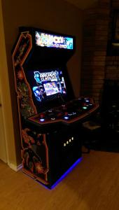

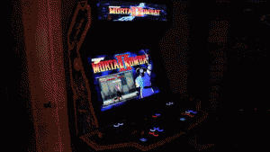

scoodidabop Posted April 27, 2016 Posted April 27, 2016 This cabinet includes lightguns with recoil, 4 slot coin mech, RGB LED buttons, and of course the LCD marquee! I need to start logging my hours on these things but it was probably a few hundred hours to complete. Enjoy! Thanks for everything, bros. Gallery: http://imgur.com/a/5mcSx

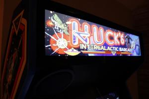

Metalzoic Posted April 28, 2016 Posted April 28, 2016 This is a beautiful build. I love the ground effects and the marquee. How much of a nightmare is it to set up a marquee like that and how much art is actually already available for MAME and the other arcade systems (Taito Type x, Naomi, Atomiswave etc...)?
scoodidabop Posted April 28, 2016 Author Posted April 28, 2016 Thanks for the positive feedback bros! Amazing! where did you get your arcade classics main theme from? I love it. I made it. I added it to the downloads section This is a beautiful build. I love the ground effects and the marquee.How much of a nightmare is it to set up a marquee like that and how much art is actually already available for MAME and the other arcade systems (Taito Type x, Naomi, Atomiswave etc...)? The ground effects are fun. They just randomly flash with the rest of the buttons on idle but in Future Pinball I have them set to audio react. Setting up hypermarquee isn't so bad once you get the hang of the flow. As for the art - as you probably know there's a huge initiative underway here on the forums to redraw hundreds and hundreds of marquee graphics in hi def. Since that's not ready I grabbed the Progretto Snaps for now: http://www.progettosnaps.net/marquees/ Progretto has many Naomi, Atomiswave and Sega Model 2/3 included as well. For everything that doesn't have a specific marquee I setup Hypermarquee to use the wheel art for that game, which actually looks pretty great! You can also tell Hypermarquee to use the default theme for that game if the resolution of the wheel art is too low. You set the resolution threshold manually so there's some control over what winds up on the marquee. Ultimately I think I'll jazz up the home console selection in Hypermarquee for my next build but overall this came out pretty cool.
Metalzoic Posted April 28, 2016 Posted April 28, 2016 Cool thanks. Doesn't sound bad if you can have defaults to avoid blanks. Any tips on good places to check for marquee sized screens or what to search for? Now I'm curious if they make one that will fit my cab. Looks like they're just called ultrawide monitors?
DJQuad Posted April 28, 2016 Posted April 28, 2016 Awesome build. Can you give us more info about the LCD marquee?

chartwel Posted April 28, 2016 Posted April 28, 2016 Definitelt interested in marquee lcd. I have one but too big and looking to get one for my mk mame i am completing. What size is that and where did you get it? Sent from my SM-N900V using Tapatalk
scoodidabop Posted April 28, 2016 Author Posted April 28, 2016 Here's the LCD seller, Vitrolight: http://www.ebay.com/usr/vitrolight?_trksid=p2047675.l2559 They have 32" 1/2 listed but my cabinet uses their unlisted 32" 1/3, which is shorter vertically. It's a perfect fit. They have many sizes to choose from. The LCD acts like a screen that was literally chopped into a third of it's original size which means the on screen menu (adjusting contrast, color, brightness etc) is cut off. You'll have rotate the menu left and right to see all the options, then adjust them from there. In other words the LCD thinks it's still 720 pixels vertically Kinda shitty, but it's workable. Plus with Hypermarquee (a godsend!) you can manually adjust the marquee display window to fit the odd little bastard. Using Hypermarquee you can set the graphics to stretch/fill etc to fill the entire marquee LCD. Worked like a charm despite some of the graphics getting a little fat on the wide stretch. Can't win them all! Great job man! Did you use themes at 16:9 or at 4:3? Because they look good =) These are 4:3 I believe but since the monitor is a taller 16:10 the stretch isn't too noticeable! EDIT: By the way I asked vitrolight about a discount since their LCDs are so pricey - they said at qty 10 or more we can get only a 10% discount. Not great :/
