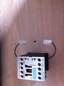

pixelmagic Posted March 5, 2012 Posted March 5, 2012 Alrighty Crude Diode wire made with my limited soldering skills and the use of some electrical tape Man, go shame yourself !! Using 'kroonsteentje' is even better then this ! Or go look for some 'krimpkous' [TABLE=width: 500] [TR] [TD][/TD] [TD=align: center]New project homepage: http://blog.pixelmagic.nl/[/TD] [TD][/TD] [/TR] [TR] [TD][/TD] [TD=align: center]LED-Wiz utility: http://pinball.pixelmagic.nl/ledwiz/[/TD] [TD][/TD] [/TR] [TR] [TD][/TD] [TD=align: center]Anyone want to buy my LEDwiz ?? [/TD] [TD][/TD] [/TR] [/TABLE]
njay Posted March 5, 2012 Author Posted March 5, 2012 Yeah yeah i know lol !!! Oooh well if it works , and i won;t see it My Mini Pin Build: http://www.hyperspin-fe.com/forum/showthread.php?t=5622 My Arcade Bartop Build: http://www.hyperspin-fe.com/forum/showthread.php?t=14570
DeeGor Posted March 5, 2012 Posted March 5, 2012 Go grab some heat shrink tubing. The stuff is cheap and looks a lot better. You also don't have to worry about it coming unraveled like electrical tape sometimes does.
njay Posted March 5, 2012 Author Posted March 5, 2012 Yeah maybe i should then search for it Lucky my solder is messy but it holds Thx for the tip guys .. i feel such a noob with looking at your wiring My Mini Pin Build: http://www.hyperspin-fe.com/forum/showthread.php?t=5622 My Arcade Bartop Build: http://www.hyperspin-fe.com/forum/showthread.php?t=14570
njay Posted March 5, 2012 Author Posted March 5, 2012 guys how can i make sure my diode wire works without destroying my wiz ? i dont have a multi meter My Mini Pin Build: http://www.hyperspin-fe.com/forum/showthread.php?t=5622 My Arcade Bartop Build: http://www.hyperspin-fe.com/forum/showthread.php?t=14570
Numiah Posted March 5, 2012 Posted March 5, 2012 Wire a small lamp to it. On one side it will work, on the other side it wont. ---- Sent from my iPhone 4S using Tapatalk **Each pinball machine is a tiny universe... that we control** My Build Overview My Computer Specifications
njay Posted March 6, 2012 Author Posted March 6, 2012 Lol ... here is a noob question for you can you explain the lamp wiring? i can connect all the things to the ledwiz because there are nice graphic explanations of it all thx for your help My Mini Pin Build: http://www.hyperspin-fe.com/forum/showthread.php?t=5622 My Arcade Bartop Build: http://www.hyperspin-fe.com/forum/showthread.php?t=14570

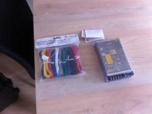

njay Posted March 6, 2012 Author Posted March 6, 2012 Alrighty ... Better as my soldering skills .... Question do i still need to power the ledwiz banks? Or just connect the + from the contactors to a terminal strip then a cable to the + of my 24 power suppy and then the ground from the contactor to the ledwiz? My Mini Pin Build: http://www.hyperspin-fe.com/forum/showthread.php?t=5622 My Arcade Bartop Build: http://www.hyperspin-fe.com/forum/showthread.php?t=14570
njay Posted March 6, 2012 Author Posted March 6, 2012 Any ideas boys? Question do i still need to power the ledwiz banks? Or just connect the + from the contactors to a terminal strip then a cable to the + of my 24 power suppy and then the ground from the contactor to the ledwiz? Sorry for the quick bump but i will get my psu tommorow so i can't wait lol My Mini Pin Build: http://www.hyperspin-fe.com/forum/showthread.php?t=5622 My Arcade Bartop Build: http://www.hyperspin-fe.com/forum/showthread.php?t=14570
DeeGor Posted March 7, 2012 Posted March 7, 2012 Yes, you still need to connect power to the ledwiz banks. Remember that each bank supplies power to 8 terminals and they are numbered on the ledwiz. Make sure not to accidentally attach a 24v device to a 12v bank or else you will fry something. Lost a 12v power supply this way. Here is a wiring diagram I did for my contactors. You can find wiring diagrams for my other devices here.
njay Posted March 7, 2012 Author Posted March 7, 2012 Sweet this explains it very clearly My Mini Pin Build: http://www.hyperspin-fe.com/forum/showthread.php?t=5622 My Arcade Bartop Build: http://www.hyperspin-fe.com/forum/showthread.php?t=14570

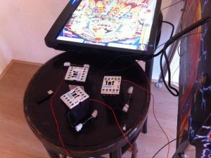

njay Posted March 12, 2012 Author Posted March 12, 2012 All are installed in my cabinet now and i must say it's awesome !!! i only have 3 now but will get more soon sharing 1 contactor for both slings works perfectly My Mini Pin Build: http://www.hyperspin-fe.com/forum/showthread.php?t=5622 My Arcade Bartop Build: http://www.hyperspin-fe.com/forum/showthread.php?t=14570
njay Posted March 15, 2012 Author Posted March 15, 2012 Ordered 4 more Contactors from ebay.de only 39 euro's with shipping Thx for the tip pixel ! My Mini Pin Build: http://www.hyperspin-fe.com/forum/showthread.php?t=5622 My Arcade Bartop Build: http://www.hyperspin-fe.com/forum/showthread.php?t=14570

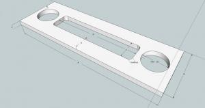

njay Posted August 3, 2012 Author Posted August 3, 2012 So i am also going the real dmd route, ordered the 12v plasma dmd @ mouser lol 16 weeks lead time In the meantime maxx is willing to create a customer front for my pincab idea is to incorperate the MM theme of my cabinet in the front I included the measurements My Mini Pin Build: http://www.hyperspin-fe.com/forum/showthread.php?t=5622 My Arcade Bartop Build: http://www.hyperspin-fe.com/forum/showthread.php?t=14570
mameman Posted August 3, 2012 Posted August 3, 2012 So i am also going the real dmd route, ordered the 12v plasma dmd @ mouser lol 16 weeks lead time In the meantime maxx is willing to create a customer front for my pincab idea is to incorperate the MM theme of my cabinet in the front I included the measurements [ATTACH=CONFIG]19030[/ATTACH] Wow didn't know Maxx, built a CNC in his spare time also.. wicked lol I sent you a note, need a few other dimensions besides what you have here. PM me for any custom CNC needs. Find me on Facebook.. Xtreme Pinball or www.xtremepinball.com Ipad pinball cabinet iFlipper Here: See the Doctor Who build Here.... / See the Tron build Here.... / See the BattleStar Galactica build Here.... See the Big Bang Bar build Here.... / See the Twilight Zone build Here.... CNC Work Here.....

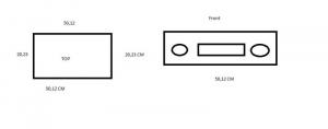

njay Posted August 4, 2012 Author Posted August 4, 2012 Wood thickness: 1,5 CM Width: 50,12 CM Heigt: Does not mather because it will be a underbox for the existing backbox Speaker hole dimension: diameter: 102 mm (4.016 inch) (don't know if this is the normal speaker size?) Is this all you need? My Mini Pin Build: http://www.hyperspin-fe.com/forum/showthread.php?t=5622 My Arcade Bartop Build: http://www.hyperspin-fe.com/forum/showthread.php?t=14570

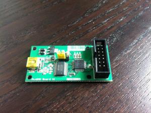

njay Posted August 7, 2012 Author Posted August 7, 2012 Pindmd board arrived: Since is also posted a topic on tweakers.net, they contacted me and are going to film me and my pin for their online show. Will keep you posted My Mini Pin Build: http://www.hyperspin-fe.com/forum/showthread.php?t=5622 My Arcade Bartop Build: http://www.hyperspin-fe.com/forum/showthread.php?t=14570

russdx Posted August 14, 2012 Posted August 14, 2012 dont forget to flash the plasma version of the firmware (if you ordered the plasma display)
