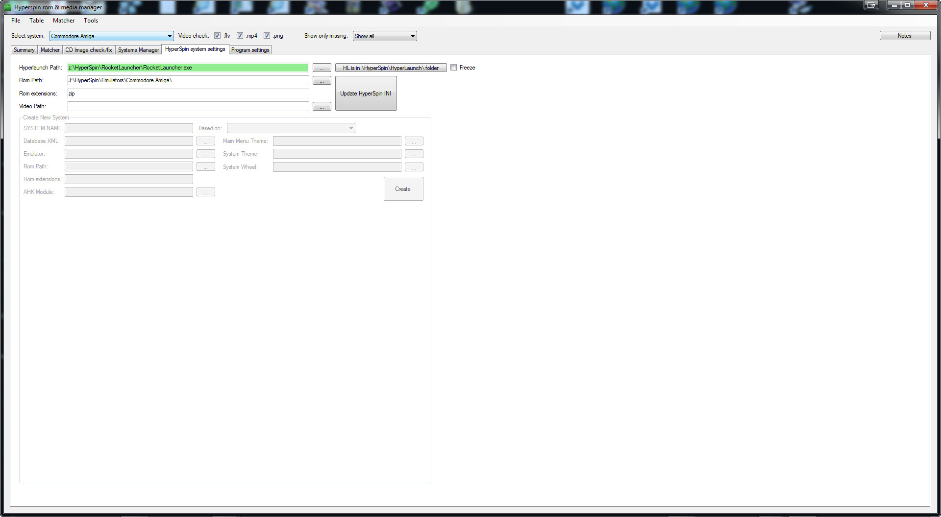

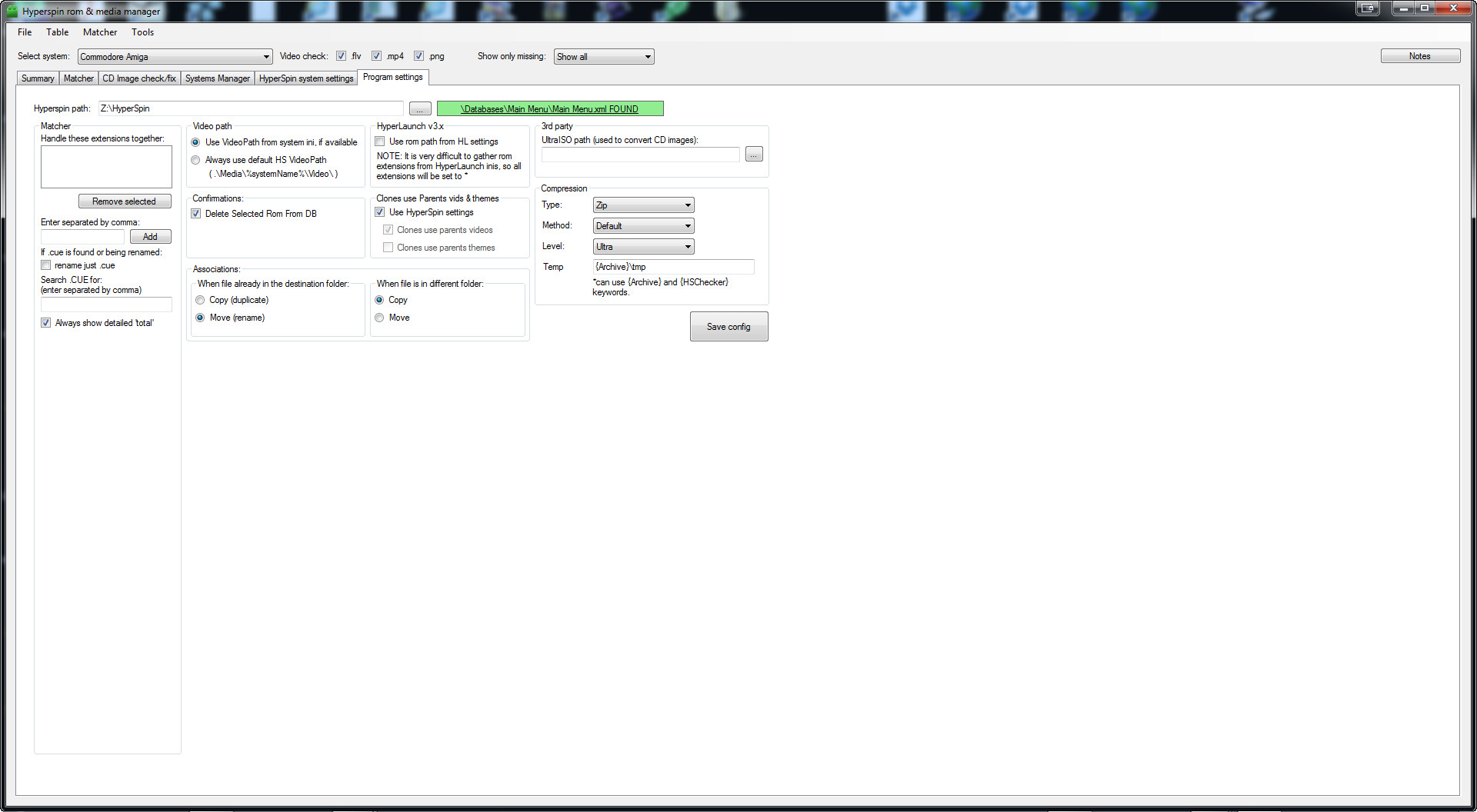

potts43 Posted June 18, 2016 Posted June 18, 2016 When I set my path to Hyperspin \\Mamemachine\j\Hyperspin it goes green if I add "\" at the end. However, when I set my path to Rocketlauncher if I do not add "\rocketlauncher.exe" then it doesn't go green. When I try to scan in systems manager tab I get "Hyperspin path is incorrect" Goto program settings. I have saved the config. I have also allocated the letter Z to my networked drive for ease of access from my main PC. I have tried to use the path using Z rather than \\ but when I close the program and go back into it the drive letter of my rocketlauncher path has changed to J (which is what it is on the arcade machine. I hope this helps.
xttx Posted June 19, 2016 Author Posted June 19, 2016 yup. All this is normal behavior. (except this "it goes green if I add "\" at the end.", it should detect directory even without slash at the end). The "hyperlaunch path" field in "HyperSpin system settings" is more for information and not for editing. The actual Hyperlaunch/rocketlaunch path is pulled from HS Settings.ini everytime you scan something, because in older version of Hyperspin, hl path settings was placed in system.ini, instead of global settings.ini, and was needed to be reloaded every time you change a system. That being said, I'll try to fix it as soon as i have time.
gigapig Posted June 19, 2016 Posted June 19, 2016 Yes thank you xttx, I too have used this app in the past.
xttx Posted June 19, 2016 Author Posted June 19, 2016 You are welcome. I added "freeze" checkbox to Hyperlaunch path field, if you have problem with network setup, or relative HL paths, try build in attachment. HyperspinChecker 0.11.1u1 Beta.7z
potts43 Posted June 19, 2016 Posted June 19, 2016 I have now checked it and the path input for RL seems to reset itself to J everytime ( is that because it reads what is in the HS settings file?) Although it should know I am using a network it seems to say invalid file for systems as it can't find them over the network. It's looking really useful though! Do you have plans to audit RL media? That woule be awesome! I've used this program for a long time! many thanks
xttx Posted June 19, 2016 Author Posted June 19, 2016 I think i didn't explained well: In you case you have two options: 1: check "freeze" checkbox (to the right of rocketlauncher path, it's visible on your second screen), then manually enter right rl path on the network. (Optionally click save config button) or 2: just use relative rl path in hyperspin's settings.ini. Latest hyperpin allows to do so. RL media - yes, it's on my todo list. Right after i finish with "association tables" - concept of one-click-all-media-autorenaming.

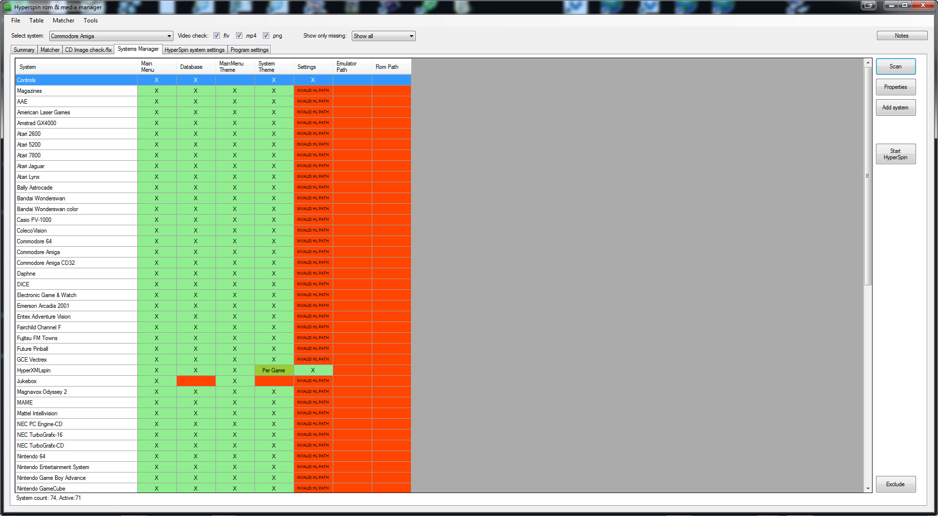

xttx Posted June 21, 2016 Author Posted June 21, 2016 In the last few days I was trying to find a way to autorename medias, and I failed... I was very excited after implimenting checksum renaming. Most of xmls in HyperList are now have crc field filled, and I was able to rename all my romsets in about 10 minutes. Obviously, it doesn't work with videos, wheels and artworks. I thought i found a way to do it. Any pack, of any media is named basing on something. So, the things to do is to find this "something" and associate every name with current name in Hyperspin XML. A was thinking to make "association tables" based on different .dats (good, no-intro, tosec, redump, gamebase, trurip... I guess that's all). It looks like this: You can let it eat all available .dats for a single system, and it create a table like this based on roms's checksum (Atari ST on the screen), In theory, this is enough to autorename all the media, but it turns out that it's actually useless... As you can see on the screen, only small amount of roms from one set, have corresponding rom, with the same checksum in others sets. And many of media packs are based on names from another galaxy (at least, the ones i have)... brief, after implimenting this, I realized that it doesn't work. Maybe someone here have another idea....

BlackPredator72 Posted July 27, 2016 Posted July 27, 2016 I got a lot of systems (275) and all my paths are wrong, so I have to correct it manually on every system, but it works. They are all wrong in HyperHQ because in the past my HS was on another drive and my roms were in my emulator folder but they still work from RL or HS (in RL it's already changed to the correct paths) Of course I changed the paths to the normal way it it supposed to be like this: And in this last case I also had to add 7z or zip to the Rom extensions and restart the program to make the ROMS available in the checker. I only miss the option Check for missing theme in another folder which could be usefull and maybe not having to select the system name for checking but the whole media folder for all systems at once. Great job done so far! My Gamercard
xttx Posted July 31, 2016 Author Posted July 31, 2016 I got a lot of systems (275) and all my paths are wrong, so I have to correct it manually on every system, but it works. They are all wrong in HyperHQ because in the past my HS was on another drive and my roms were in my emulator folder but they still work from RL or HS (in RL it's already changed to the correct paths) ... And in this last case I also had to add 7z or zip to the Rom extensions and restart the program to make the ROMS available in the checker. I only miss the option Check for missing theme in another folder which could be usefull and maybe not having to select the system name for checking but the whole media folder for all systems at once. Great job done so far! Actually, you can just check "Use rom path from HL" in "Program settings". Don't need to correct all paths. You still have to correct extensions though, in some cases. "Check for missing theme in another folder" - I will add this soon. checking all systems at once - This can be tricky to add... But anyway, it can take forever, to check 270+ systems. Maybe an hour, maybe even more. Are you really sure this feature can be useful?
