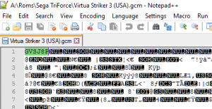

kylecp1979 Posted August 24, 2016 Posted August 24, 2016 You open your iso or however you have your game formatted with note++ and change the game id. then copy the ini and put it in each emulators user gamesettings folder the game ID is in the first line. both mario kart games have the same id but make sure the rom names are different. ID for both is RELSAB Virtual soccer's ID is GVSJ8P ROM name Mario Kart - Arcade GP (USA) Game ID Name RELSAB RELSAB ini content [OnFrame]$Disable crypto0x8023D828:dword:0x93A300080x8023D82C:dword:0x93C3000C0x8023D830:dword:0x93E300100x8023E088:dword:0x4E800020$Loop fix0x800790A0:dword:0x986500250x8024F95C:dword:0x600000000x80031BF0:dword:0x600000000x80031BFC:dword:0x600000000x800BE10C:dword:0x4800002C0x8009F1E0:dword:0x600000000x800319D0:dword:0x60000000[OnFrame_Enabled]$Disable crypto$Loop fix ROM Name Mario Kart - Arcade GP 2 (USA) Game ID Name RELSAB ini content [OnFrame]$Emulation Bug Fixes0x8002E100:dword:0x600000000x8002E340:dword:0x600000000x8002E34C:dword:0x600000000x80084FC4:dword:0x4800000C0x80085000:dword:0x600000000x80073BF4:dword:0x986500230x80073C10:dword:0x98650023$Disable Commentary0x801B6510:dword:0x38800000[OnFrame_Enabled]$Emulation Bug Fixes ROM Name Virtua Striker 3 (USA) Game ID Name GVSJ8P ini content [OnFrame]$DI Seed Blanker0x80000000:dword:0x000000000x80000004:dword:0x000000000x80000008:dword:0x00000000[OnFrame_Enabled]$DI Seed Blanker GameSettings MKGP 1 VS.zipFetching info... Gamesettings MKGP 2.zipFetching info...
