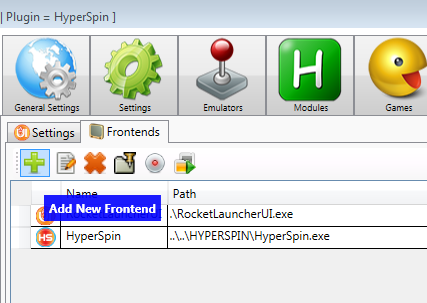

gigapig Posted January 29, 2017 Posted January 29, 2017 1 hour ago, demonseed said: Hey i got my default profile to load every time now however is can't figure out how to load a profile for a particular system jr You select your system on the left pane, hit the Keymapper tab. Click the drop down next to the green + and choose "system" JoyToKey should then pop up so you then set you keys, make sure you go to Preferences and check the minimise box and then save it. Done. Really most controls should be set in the emulator depending on your set up. Most of the console systems I have just have blank profiles.
Aorin Posted January 29, 2017 Posted January 29, 2017 5 hours ago, gigapig said: You select your system on the left pane, hit the Keymapper tab. Click the drop down next to the green + and choose "system" JoyToKey should then pop up so you then set you keys, make sure you go to Preferences and check the minimise box and then save it. Done. Really most controls should be set in the emulator depending on your set up. Most of the console systems I have just have blank profiles. Does the Hyperspin profile reload when you exit a game? A friend of mine is having troubles setting up his controls. Aorin
gigapig Posted January 29, 2017 Posted January 29, 2017 1 hour ago, Aorin said: Does the Hyperspin profile reload when you exit a game? A friend of mine is having troubles setting up his controls. Yes Rocketlauncher should reload it on exit if a frontend profile has been created.
Aorin Posted January 30, 2017 Posted January 30, 2017 2 hours ago, gigapig said: Yes Rocketlauncher should reload it on exit if a frontend profile has been created. OK, I'll help him with it later, I hope we can solve it. Thanks. Aorin

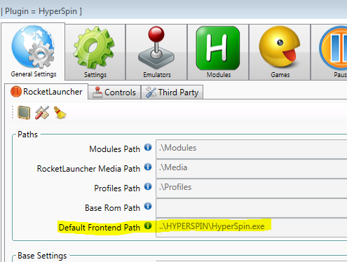

Spawk Posted January 30, 2017 Posted January 30, 2017 May or may not be relevant but I've seen NOT having this set as a cause of focus and reloading HS issues for jtk users: I only bring it up because I don't think this option was even created yet in RL when I wrote my Tutorial so it's not even in there. This is one of those settings that if unset... things sorta still work! Since you set active and default profiles here: Games load and it may seem like everything is ok.
