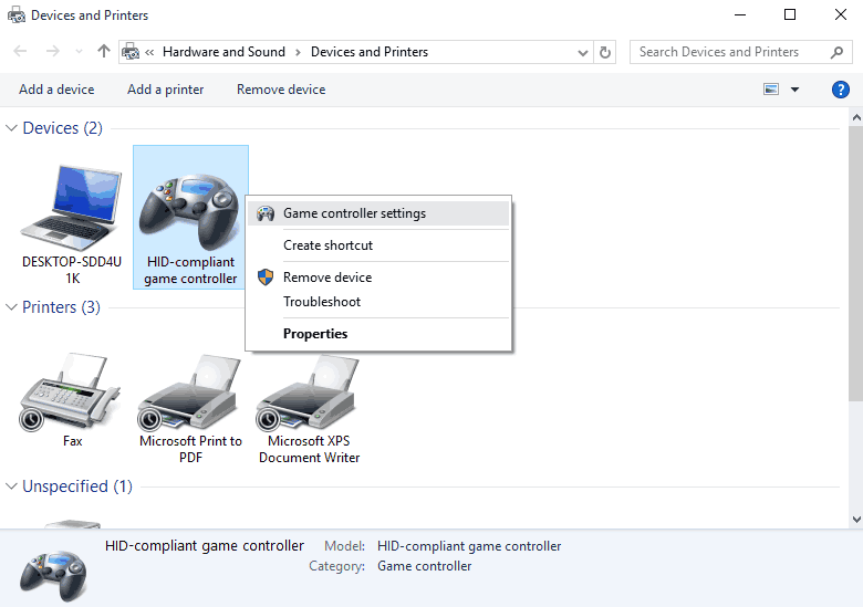

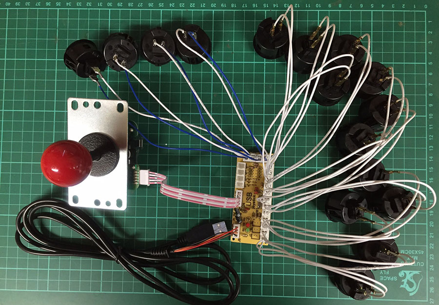

32assassin Posted February 21, 2018 Posted February 21, 2018 20 hours ago, Dedge said: What I don't understand - is how do you connect the controller kit (joystick buttons etc..) to windows? Is there some kind of controller I need to order? their are two types of controller interfaces 1. Keyboard encoder (example ipac) when you plug them to your PC, they register as a USB keyboard You simply connect a button and when you press a button --> they mimic a keyboard button press 2. Joystick encoder (hundreads to choose from) a joystick encoder is nothing more then a gutted out generic Windows USB controller when you plug it in to your PC, you will find it in your device manager and be able to pull up this window similar to this and you will be able to go into the controller settings and test the buttons after you connect your buttons and joystick to your Joystick encoder you simply map your buttons in your emulator. similar to this c both Keyboard encoders and Joystick encoders have their pros and cons its up to you on what you want to get. I personally would not touch a keyboard encoder, as you noticed from the previous posts allot of people love their ipacs
thatman84 Posted February 21, 2018 Posted February 21, 2018 2 minutes ago, 32assassin said: oth Keyboard encoders and Joystick encoders have their pros and cons its up to you on what you want to get. I personally would not touch a keyboard encoder, as you noticed from the previous posts allot of people love their ipacs I would love for you to expand here. I highly respect your opinions. Your an asset to this community. Hyperspin 2.0 Latest Download Hyperspin 2.0 Documentation -------Pre Hyperspin 2.0 Below---------- HS Android Overview & Install HS Android Base Pack Download My Tutorials

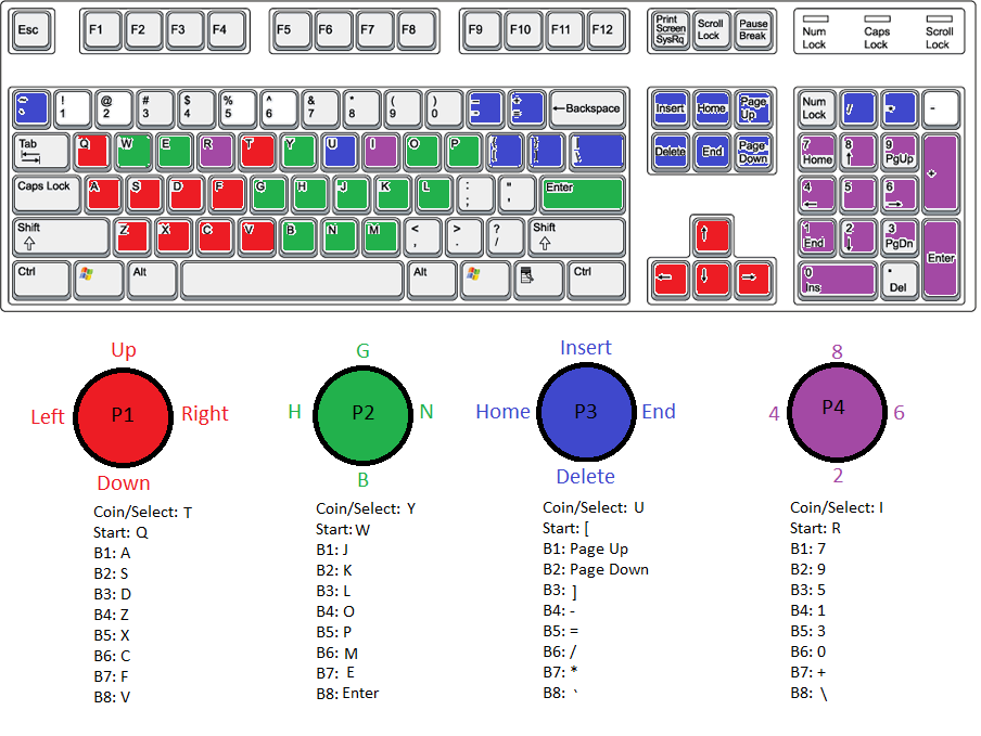

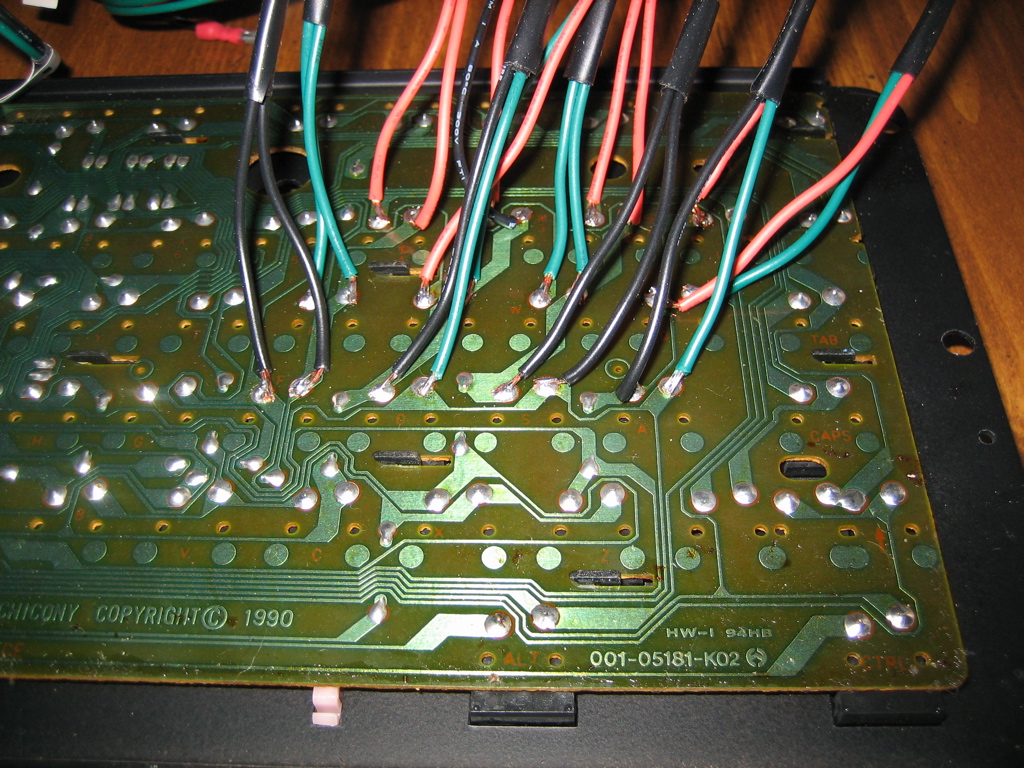

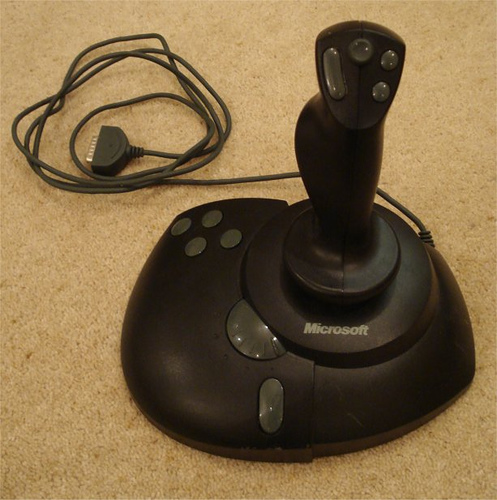

32assassin Posted February 21, 2018 Posted February 21, 2018 I mentioned this in another thread but I can't find it. When emulators first came out we had Windows 95 PCs, and the serial based joysticks similar to this Serial joysticks where complete joke, the best way to play MAME and the other emulators was to do this to your keyboard Since their is allot of people who are not comfortable soldering, we ended up with keyboard encoders. Joystick support has come a long way since Windows 95, and most modern day emulators fully support Joystick inputs. unless you are running some outdated or obscure games/emulators; their is really no need for Xpadder/Joy2key becasue you can directly map your joystick to your emulators. The only major drawback to Joystick encoders is that Hyperspin Joystick support at its best is hit or miss. but that problem is solved with ghutch92 start up script. One thing you should know is I'm in no way shape or form stating that keyboard encodes don't work. if you have a limited amount of emulators in your system you will probably never find a problem. and if you do it will be those weird bugs, the biggest one is when you press multiple keyboard inputs and your games exits. (something easily fixed in RL but most noobs will not have a clue on what is happening) the problem I have with them is that allot of modern day PC games don't fully support keyboard inputs. some are pre-configured to work with xbox controllers (and no you can't re-map the buttons) see the threads with the new Street Fighter PC games with ipac controllers. only way you can use an ipac for Player 2 in those games is if you install a virtual joystick ---> map your keyboard keys to the virtual joystick buttons then install XboxCE --> an Xbox 360 controller emulator ---> map your virtual joystick buttons to this program to re assign your joystick buttons. I use XboxCE in a virtual pinball machine to map an analog pinball plunger input ( using a generic joystick encoder) to Pinball FX2/3 again, Modern day PC games are pre-configured to work with Xbox 360 controller. and no their is no analog plunger keyboard controller in this game (as I mentioned limited keyboard support). You have to use a joystick encoder with an analog joystick support. aside from all that, you will have to find a uniform key mapping system. the ipac is pre configured to MAME keys, but some emulators don't like service keys as inputs. so you have to remap the ipac keys to something like this, where you no longer have service keys as inputs

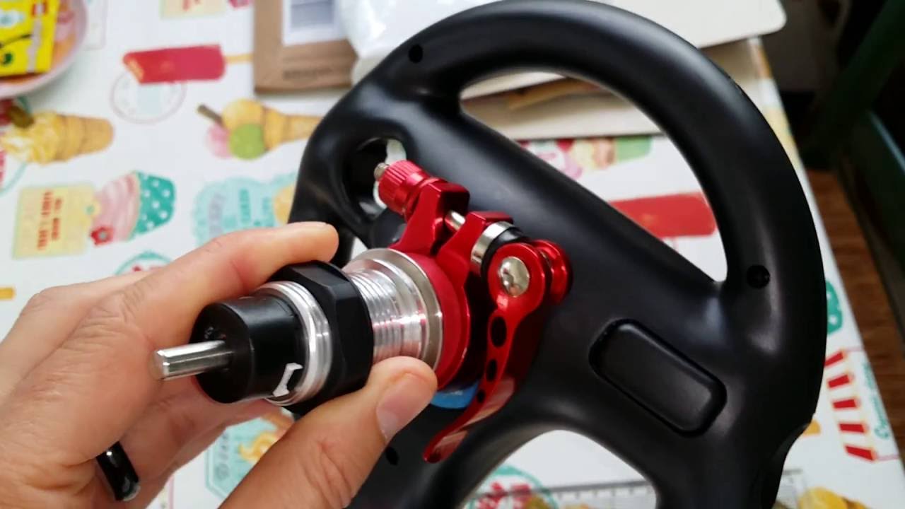

artman999999 Posted February 22, 2018 Posted February 22, 2018 @ci2own - You make the spinner/clamp/steering wheel combo? I REALLY like that! Regarding joystick integration - I didn't see this above, but something to consider: Using an IPAC to convert joystick directions to key codes is not ideal in terms of lag or flexibility, but it has a definite advantage when it comes to keeping your Player 1 and player 2 sticks properly set. Windows generally retains assigned usb joystick IDs so long as they are not moved from port to port. But if you plug/unplug them on a frequent basis, it's only a matter of time before your player 1 joystick suddenly controls player 2 in your game and vice-versa. With a custom controller config file, MAME has the ability to deal with this properly, but most of the other emus don't. If you want the best of both worlds, use usb joysticks for all emus that properly recognize the physical device IDs (MAME, Supermodel). But for all others, use joy2key or xpadder's application profile settings to convert the directions to key presses. This will give you maximum compatibility, low lag, and analog capability for games that need it to be playable (all rail shooters, flying/driving games). Last thought - turning the processing speed up too high on joy2key or xpadder will result in keystrokes coming in too quickly for the computer to process them as "simultaneous" and thus "multi-directional". On 2x processing your diagonals will become problematic, but on 4x processing or higher they completely stop working, locking your joystick to 4-way only. Took me a long time to figure out that one little checkbox was the reason my Demul emu fighting games would not let me jump towards or away from an opponent. Just some thoughts. -A
