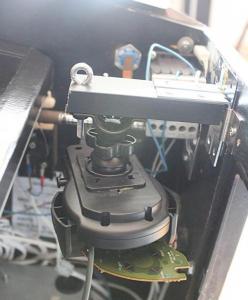

pinballlooking Posted February 27, 2012 Posted February 27, 2012 I am offering a $25 paypal reward to assist me in getting nudging to work on my virtual pinball cabinet.I will purchase items such as ms sidewinder or nanotech mot-lon boards whatever. I just want to get nudging to work on my machine. The key is a working solution All the info is here just scattered around. Buy MS sidewinder Mount it like this. http://www.hyperspin-fe.com/forum/showthread.php?t=10492&page=18 use XPadder use gstav config Originally Posted by gstav "I would be happy to post my config file for XPadder" http://www.mediafire.com/?mhf95c0fxvg18lx Just make sure the PBW Accelerometer checkbox is unchecked (in VP eidtor) Level MS sidewinder in Xpadder. Then play around with the deadzone settings (in Xpadder)to make it work the way you want it to. My Pinball Cabinet:http://www.hyperspin-fe.com/forum/showthread.php?t=15290
legtod2 Posted February 28, 2012 Posted February 28, 2012 Let me ask the important question, does it work well ? Does it require a special version of vpinball ?o
pinballlooking Posted February 28, 2012 Posted February 28, 2012 Let me ask the important question, does it work well ?Does it require a special version of vpinball ?o I think it works well but you can ask DeeGor, or gstav they have the exact same setup. No it does not require a special version of VP. It is a very low cost to solution to implement. My Pinball Cabinet:http://www.hyperspin-fe.com/forum/showthread.php?t=15290
DeeGor Posted February 28, 2012 Posted February 28, 2012 It works great in my setup. I have the nanotech board, and I prefer the gamepad over it. Just make sure to mount the gamepad on the other side of the cabinet from your shaker motor.
