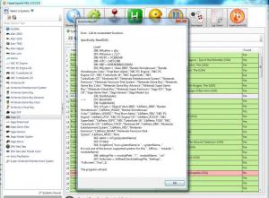

keltoigael Posted November 12, 2014 Posted November 12, 2014 I am getting this error with all my systems. It looks like it is calling for some sort of bezel support, but I do not use bezels or have ever set them up. Anyone run into this issue? https://www.youtube.com/channel/UCGAi8dJWR4bpg1oRfItcPCw
gigapig Posted November 12, 2014 Posted November 12, 2014 keltoigael said: I am getting this error with all my systems. It looks like it is calling for some sort of bezel support, but I do not use bezels or have ever set them up. Anyone run into this issue? You normally get those if your system is not up to date. Do you have GIT setup?
