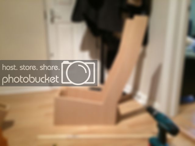

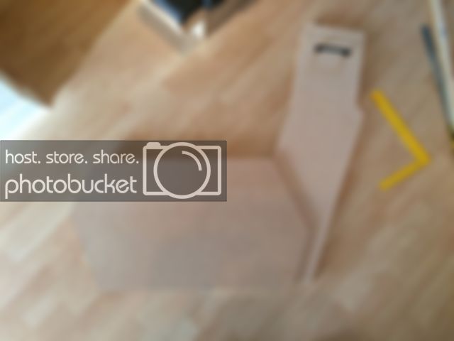

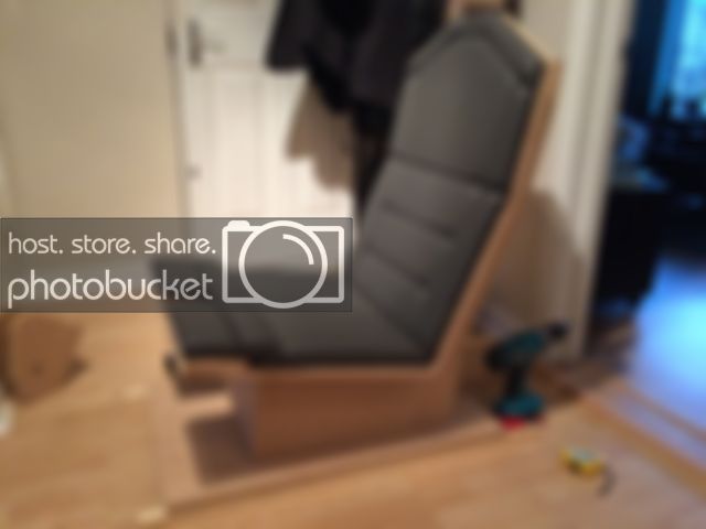

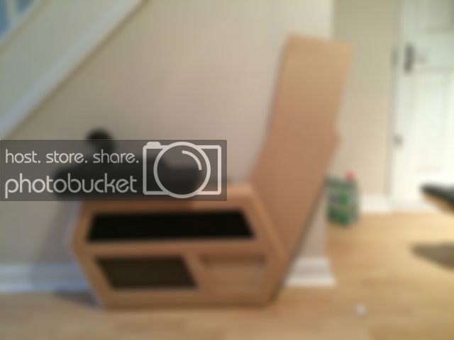

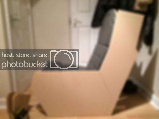

ericleroi Posted November 23, 2014 Author Posted November 23, 2014 Drop the rear of the sub-frame to create more of a recline: Made the base: Started on the side panels (lower pencil lines denotes where the side pods will sit):

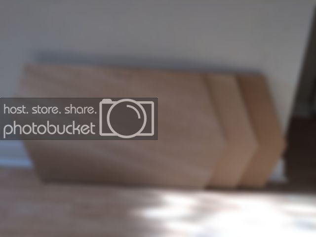

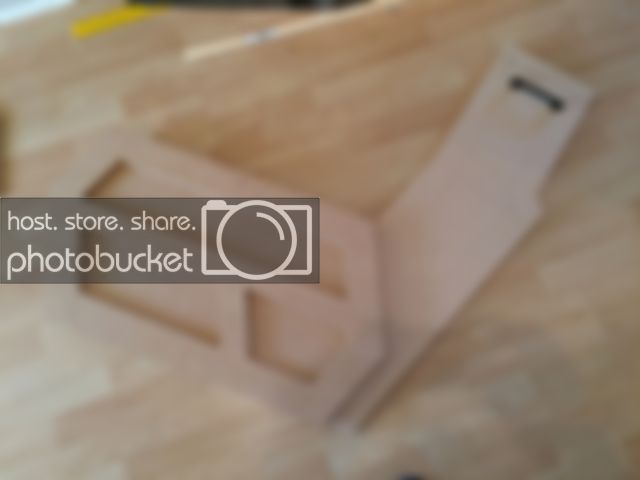

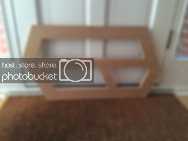

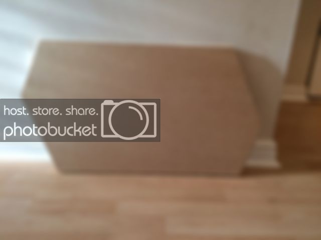

ericleroi Posted November 29, 2014 Author Posted November 29, 2014 Busy morning and lunchtime. I cut the side pieces for the left side pod. First piece: In-place: Cloned: Windows drawn out: And cut:
ericleroi Posted November 29, 2014 Author Posted November 29, 2014 derekablackburn said: Looking good! Thanks derekablackburn The outside and inside edges of the cutouts have been beveled: Both sides have been completed: In-place:

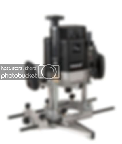

HazzardActual Posted November 29, 2014 Posted November 29, 2014 are you routing the edges? or do you have a drum sander or something set up at an angle?
ericleroi Posted November 29, 2014 Author Posted November 29, 2014 Jeremy is correct. I use a router with a 1/2 inch collet. I have the Trend T5. I was umming and arring about buying it at the time but it's proved to be the best investment in a single tool I've ever made. It's heavy and demands respect but it's a fantastic piece of equipment: It allows me to use much larger chamfer bit for really deep beveled edges when required. Edit: It's a T10 not a T5
dougan78 Posted November 29, 2014 Posted November 29, 2014 jeremy0203 said: My wife yelled at me last time I used my router in the garage. Boy do I need a vacuum attachment for it. I made mine hold the shop vac while using it to collect the dust.. She had fun helping out. Not big on playing games though... likes making stuff.
ericleroi Posted November 29, 2014 Author Posted November 29, 2014 Yes, the delights of internal MDF snow. The stuff really is not good for you at all so a respirator and a hose/vac is pretty essential to keep things clean

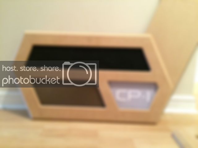

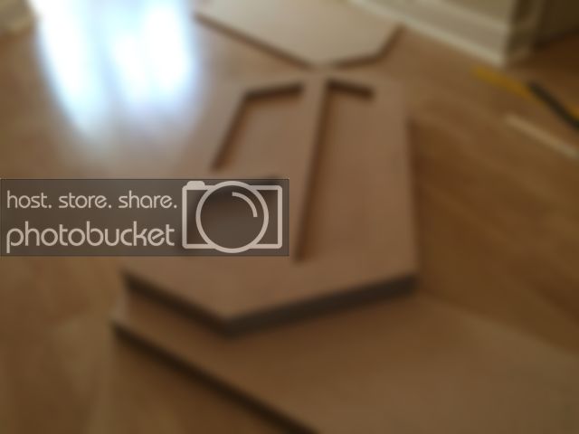

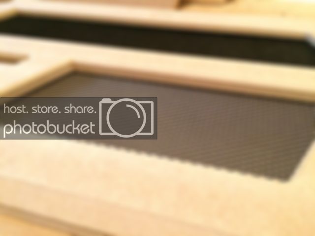

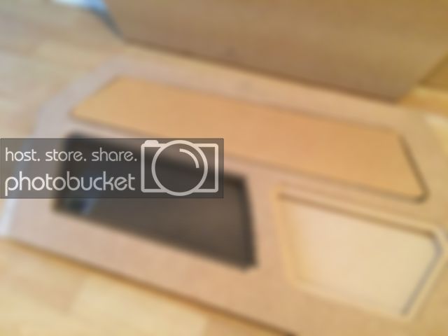

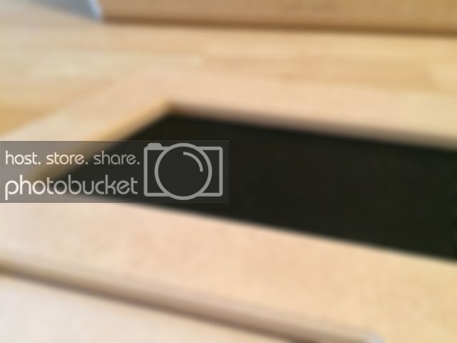

ericleroi Posted November 30, 2014 Author Posted November 30, 2014 Yes, I need to seriously consider updating my monitors ... it will cost a small fortune though Made some good progress with the side pods today: All pieces have been cut: Remaining bevels complete: Inlays routed: Likely position for the throttle case:

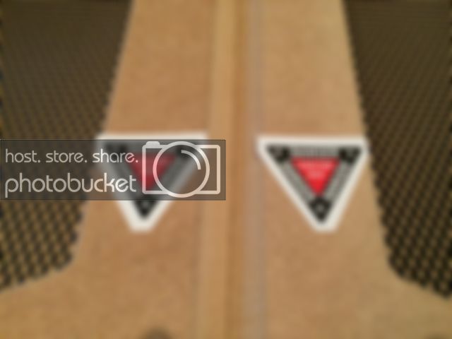

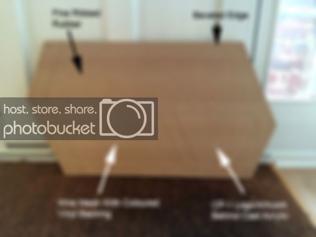

ericleroi Posted December 1, 2014 Author Posted December 1, 2014 Mesh and rubber inlays for the side panels have been fabricated: Currently working on the artwork. It will remain fairly simple but I may include a simple logo with it as well: Ejection seat stickers arrived also:
