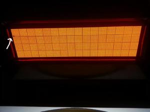

rotoforever Posted January 19, 2013 Posted January 19, 2013 @rotoforever from the image i can see the 8th pixel down on the faint line the pixel is not lit up? can you play a few games and see if this pixel has died?which DMD are you running rotoforever Thanks for your reply. It's the LEE-128G032B. It seems the pixel is working though. My Tron:Legacy Build Thread
russdx Posted January 19, 2013 Posted January 19, 2013 (edited) ok doesn't seam to be a dead pixel then, does your faint line remain when the DMD should be blank. the reason i don't think these faults r pinDMD related is because there is around 60ish pinDMD1's running that DMD with out any problems, running the same firmware as you. and normally when there are firmware issues it seams to upset the whole display or every one see's the same fault. but in these 2 cases (and a few others) it seams to be 1 random column seams to be faulty. (iv seen it for my self with my pinLED, and it was a DMD fault) which leads me to believe its a DMD fault not pinDMD/firmware fault. if you want you can send the pinDMD back to me and i can test it for you (on 3 different DMD's hehe) to confirm that the pinDMD/firmware is ok Let me know Edited January 19, 2013 by russdx
rotoforever Posted January 19, 2013 Posted January 19, 2013 I agree that it makes much more sense that it's a faulty display. I'll just wait for my Pindmd2 and if the problem remains, think about sending the display back to Future Electronics. The line isn't really a showstopper, just a small imperfection. Thanks! My Tron:Legacy Build Thread
rotoforever Posted January 19, 2013 Posted January 19, 2013 And yes, the faulty line remains when everything is supposed to be blank. My Tron:Legacy Build Thread
russdx Posted January 19, 2013 Posted January 19, 2013 no worries let me know how it goes if any one ever has any problems the offer to test any pinDMD's is always there

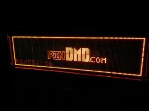

jasonsmith Posted January 22, 2013 Posted January 22, 2013 (edited) DMD's are a pain lolPlasma ones leak gas and go all funny or the paper ribbon cable on the side gets detached and kills whole rows/columns. LED ones seam to have dead pixel faults which intern cause faint lines to appear. out of 235 pinDMD's sold iv heard/seen about 6 dodgy DMD's (mostly pinLED lol) 1 or 2 Vishay and 1 Plasma vishay ...and one X-Pin January must be the Bermuda triangle month for DMD's, they're crapping out all over the place. @boogies2 and rotoforever I feel your pain, my X-Pin came with a dead pixel, some of the 8x8 blocks twisted, some right against each other while some were 1/16" apart, a real shame. I'm really starting to think the 16x16 PinLED is the way to go, less blocks to have issues with, less grid lines to deal with, lifetime warranty (US and Canada). But hey, The pinDMD.com logo looks awesome! I'll report back with any warranty updates, if I can get a hold of X-Pin 2013-01-22 Edit: Just got a reply from Brett, we're going to wait until the end of February for a new one from the new manufacturing process. Edited January 23, 2013 by jasonsmith Updating My $1900 Budget Cab
russdx Posted January 22, 2013 Posted January 22, 2013 dead pixels suck, we really need to get these plasma dmd's up and running hope you get that future pinball .dll soon as the pinDMD does a lot more then show a simple logo
