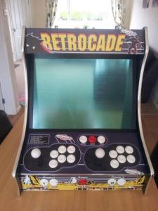

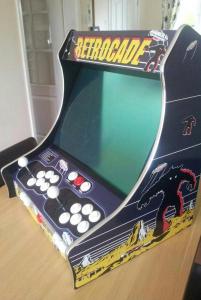

Sir Cyrano Posted April 18, 2013 Posted April 18, 2013 I have seen the edges of you BarTop and they are very well painted, very bright !!! Can you tell me what kind of paint did you use ??? Repaint 2 or 3 times ??? And the edges must be sanded before ??? Some special treatment ???
mikekim Posted April 18, 2013 Author Posted April 18, 2013 Actually they're not painted. .. They where covered in duck tape, prior to the photo, as the edges where covered in glue residue from the rubbish chrome strip supplied with the kit. I subsequently slot cut the edges and applied black t-mold. Also the shots where taken on an expensive DSLR (with a professional grade lens) which helped with the clarity and brightness of the photo. Sent from my Samsung Galaxy Note II.

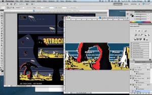

Yardley Posted April 22, 2013 Posted April 22, 2013 i think it came from freefonts.comjust google invaders font Tried that before but was just able to find the pixelated style font or the one where its just the game characters.
luvthatapex Posted April 22, 2013 Posted April 22, 2013 So how do you get the retrocade psd file? This looks very cool!
mikekim Posted April 22, 2013 Author Posted April 22, 2013 So how do you get the retrocade psd file? This looks very cool! The file is in my folder on the ftp site, you need to be a gold member (or higher, to access it) Sent from my Samsung Galaxy Note II.
mikekim Posted April 24, 2013 Author Posted April 24, 2013 Tried that before but was just able to find the pixelated style font or the one where its just the game characters. did a check on the font, and the one you need to replicate the marquee is "ITC Machine CE Medium"

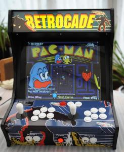

tippers27 Posted May 11, 2013 Posted May 11, 2013 Big thanks to Mikekim for the art its awsome thank you . Here is my build up to now. Still got monitor to fit and Motherboard etc. Protective film is still on the glass. I've made the front pannel smaller than I usually do and angled the control panel more I think it looks good plus it feels more comfortable to me.

Yardley Posted June 14, 2013 Posted June 14, 2013 Hey Mike, quick question. Did you change the color on the latest art work files you posted? The blue on the old and the new looks different. Thanks.
mikekim Posted June 14, 2013 Author Posted June 14, 2013 Yes I did, as it was changed to the same colour as the original taito space invaders background. I wasn't happy with the original retrocade design, as the colours where wrong, which I only realised after I had received the printed artwork from Lucian045. Sent from my Samsung Galaxy Note II.
Yardley Posted June 17, 2013 Posted June 17, 2013 Yes I did, as it was changed to the same colour as the original taito space invaders background.I wasn't happy with the original retrocade design, as the colours where wrong, which I only realised after I had received the printed artwork from Lucian045. Sent from my Samsung Galaxy Note II. Thanks for clearing that up.
