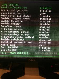

Styphelus Posted January 25, 2015 Posted January 25, 2015 When using the Mess core, is it possible to remove that blue nag screen at the start of a game? I can do it in Mess but haven't figured out a way to do it in Retroarch.
baddeolv Posted January 25, 2015 Posted January 25, 2015 It's in the core options Instagram : baddeolv Facebook : Brian Addeo
baddeolv Posted January 25, 2015 Posted January 25, 2015 You have to have a game loaded to access them. If it still says no options available then make sure your paths are correct. Instagram : baddeolv Facebook : Brian Addeo
Styphelus Posted January 25, 2015 Posted January 25, 2015 That worked. Now I noticed that once you add an anti-aliasing filter, Mess games slow to a crawl. Guess I'll just have to use the ctr-geom-curved filter on it's own without advanced-aa. Thanks for the help.
