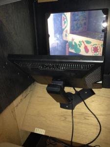

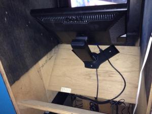

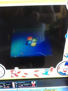

markdivine Posted May 18, 2013 Posted May 18, 2013 Buckethead I installed my 19" Dell LCD and it actually fits very well in the cab. This is a pretty small cab anyway. Here are some photos:
RidicRick Posted May 18, 2013 Author Posted May 18, 2013 19" to 22" all look great as long as they are 4:3 monitors and turned vertical. I have tried a few that size that are 16:9 ratio and it looks goofy. warriorpoet... I gave access of the files to someone else now, somewhere in these pages there is a link I think to them.

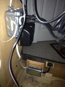

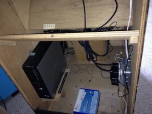

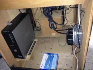

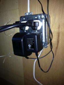

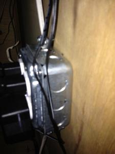

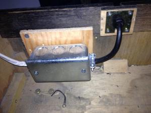

BUCKETHEAD Posted May 19, 2013 Posted May 19, 2013 Buckethead I installed my 19" Dell LCD and it actually fits very well in the cab. This is a pretty small cab anyway. Nice! I see you wired it up alot like the real Disney Cab. Could you share some more pictures? What is going on with the electrical outlet in there? How is it wired? Thanks! Bucket ...
markdivine Posted May 23, 2013 Posted May 23, 2013 Hi Buckethead I watched the YouTube video "Inside a Fix It Felix Cabinet" and copied it as close as I could. Basically I cut the end of a a thick server power cord and tied it inside a wire box (from Home Depot), used Romex 14/2 and ran it to the 2 gang duplex receptacle. I bought a new florescent light from Wal-Mart for $8 and cut the plug, splicing it in the 2 gang receptacle. I also cut a small piece of plywood to cover the old power switch hole. This is almost identical to the real newer Disney cabinets. If you see photos from the instruction manual that came with the real Disney cabinet it has a photo of a FIF cab with the original Nintendo 20ez monitor and the power supply on the floor next to the HP desktop.
