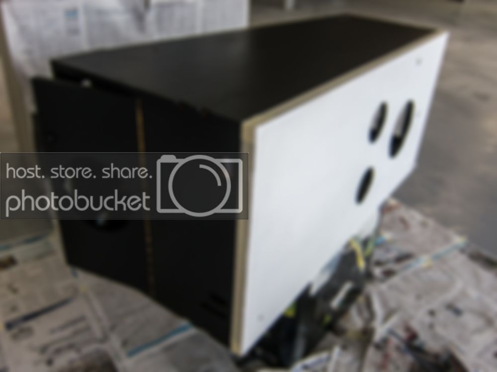

freezy Posted August 9, 2012 Author Posted August 9, 2012 White bottom hopefully makes the LED strip shine!

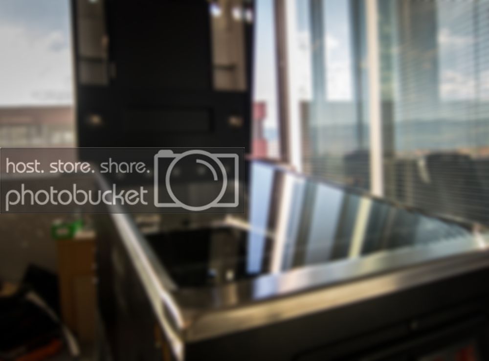

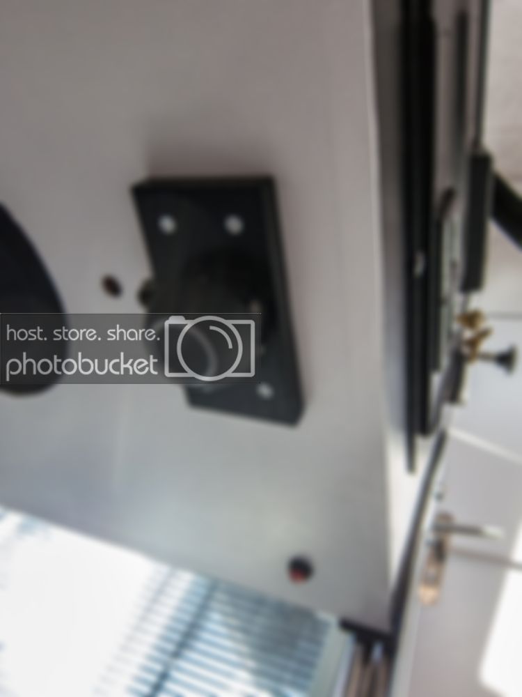

freezy Posted August 10, 2012 Author Posted August 10, 2012 Paint job done, could have been worse. The surfaces that are visible finally came out okay, the others will get decals over it anyway. Put some aluminium foil into the holes so the RGB LEDs get fully through! Also mounted side rails, glass and lockdown bar, and boy, she's a beauty! Volume knob is screwed+glued to the bottom: Also had my first game with real flipper buttons. Could have spent all night long playing. Next thing are probably the solenoids, then the LEDs. Let's see

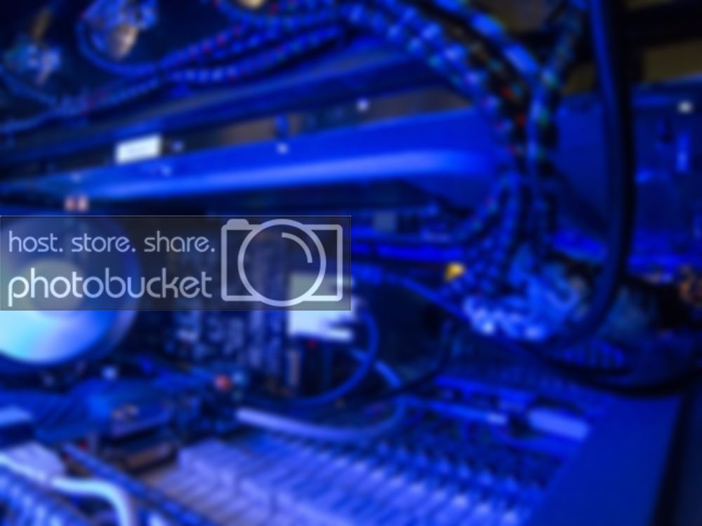

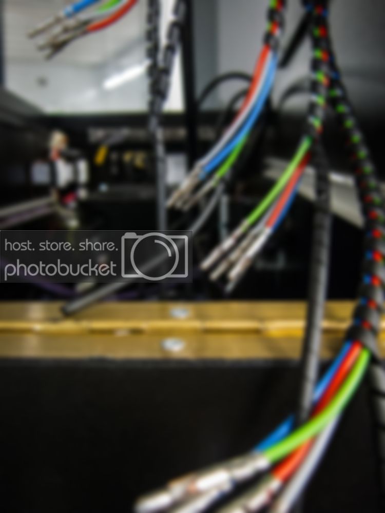

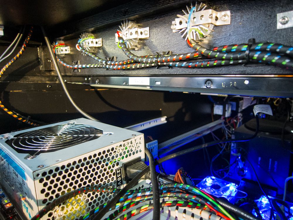

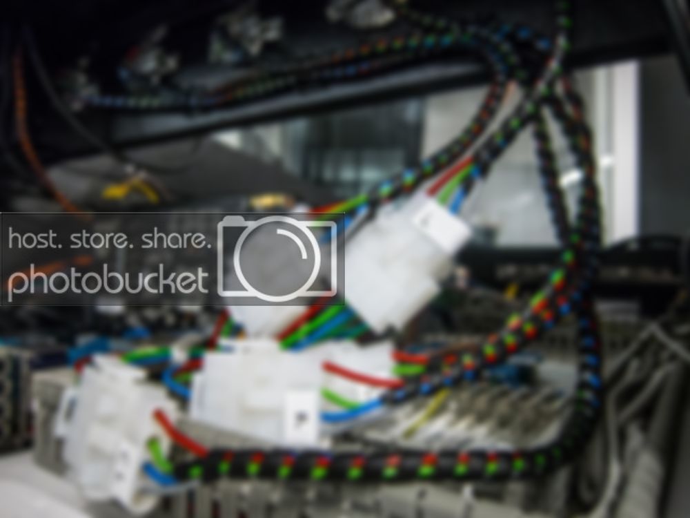

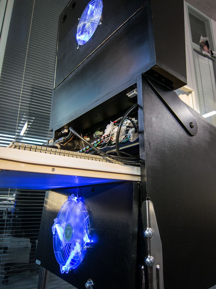

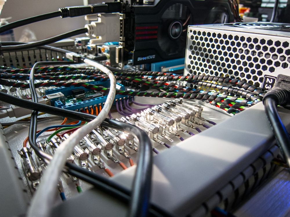

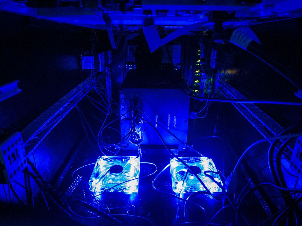

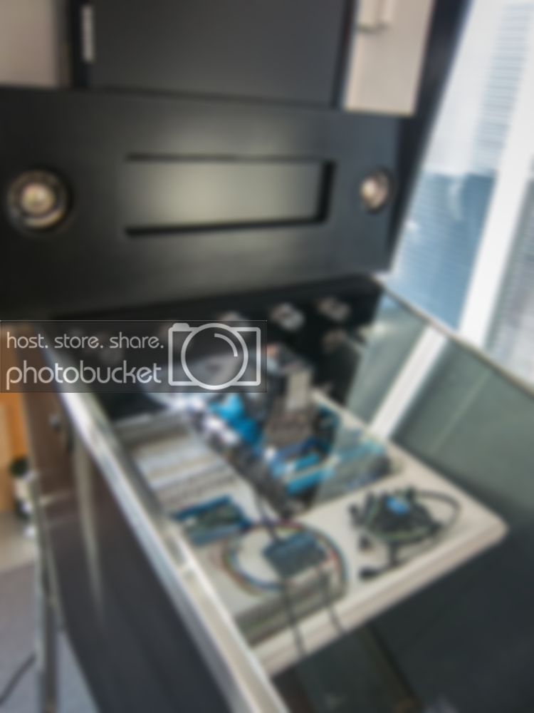

freezy Posted August 19, 2012 Author Posted August 19, 2012 Added the contactors: Plugged vents: Also mounted the RGB LEDs: Wiring those connectors was no fun... But finally it makes the drawer easily removable:
maxxsinner Posted August 19, 2012 Posted August 19, 2012 Nice wiring job there freezy Electropin - Enough lights to land a jet on an aircraft carrierHigh Voltage Pinball - Cause one build just wasn't enough Voltek Arcade - Funglo pedestal style mame cabinet Pinball Electrical Tutorial - Wire All Your Bling With Confidence and Fewer House Fires

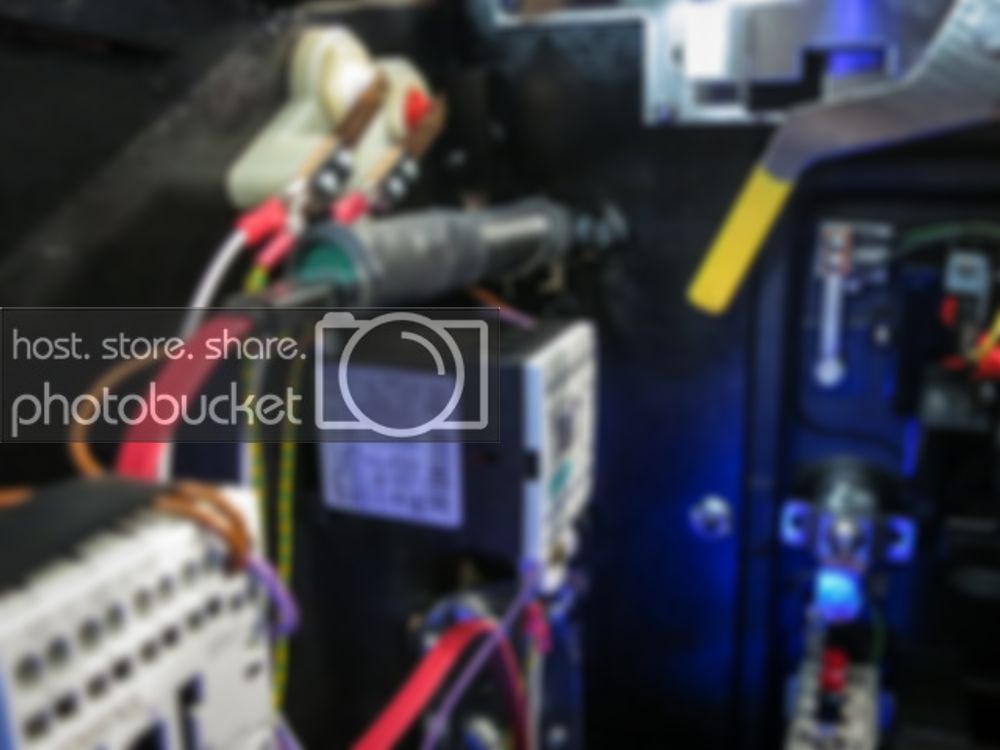

freezy Posted August 19, 2012 Author Posted August 19, 2012 Thanks guys. Seems the insulation from the wires that are soldered onto the flashers is stripped a little too much so there is contact between some wires and the heat sink. Will put some nail polish on it tomorrow, that should fix it.

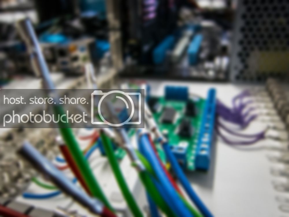

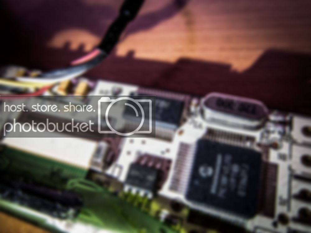

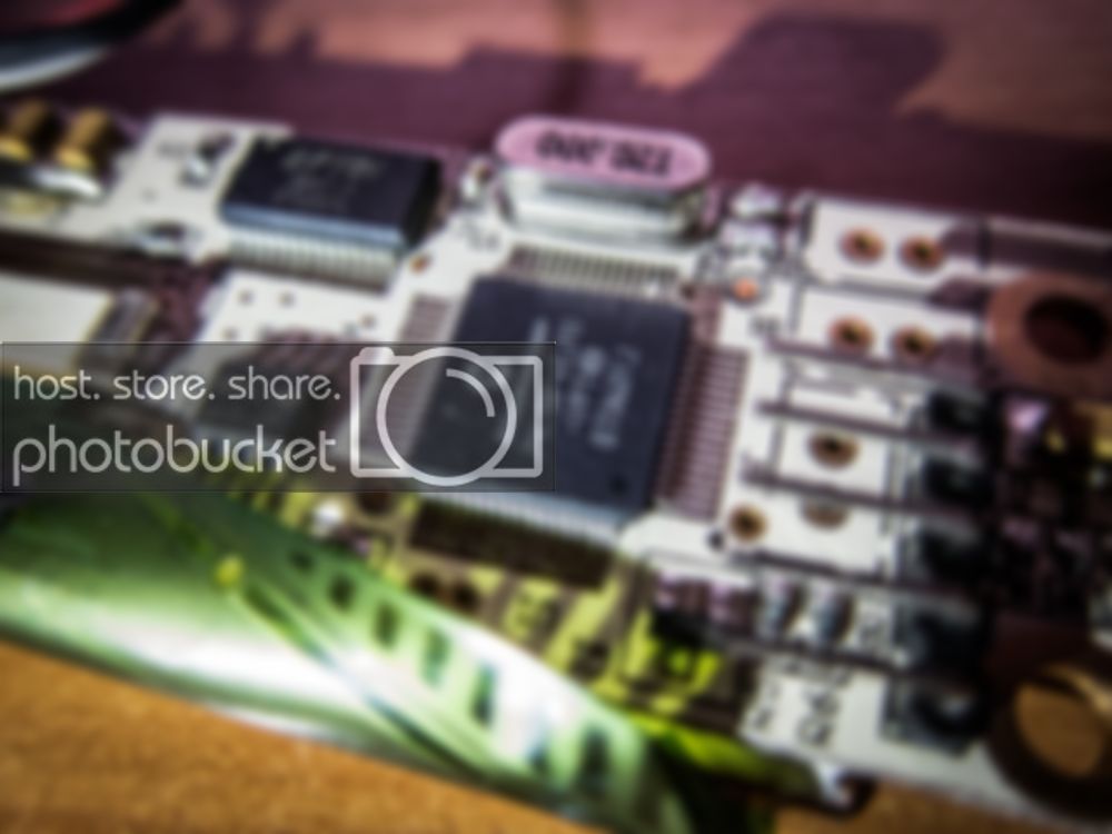

freezy Posted August 22, 2012 Author Posted August 22, 2012 Finished LED-Wiz soldering today! Also started tidying up the cable mess. Some of the flashers I had to re-solder because of short circuits. Tested them and they work like a charm! Front buttons are wired too and the backside vents are also still working. Cleaning up the inner cable mess is the next task. Re-mounted glass and side rails and she's pretty again! @kizam33: Thanks for the compliment! The volume knob came with the speaker set and also has headphone out and an aux in, which is quite practical if you want to just plug your phone and listen to some music.

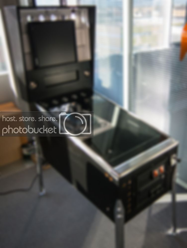

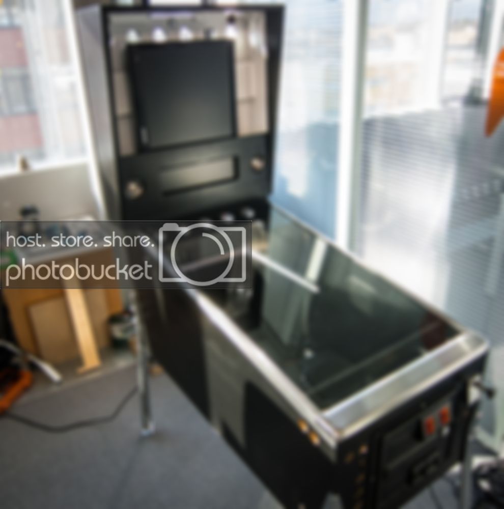

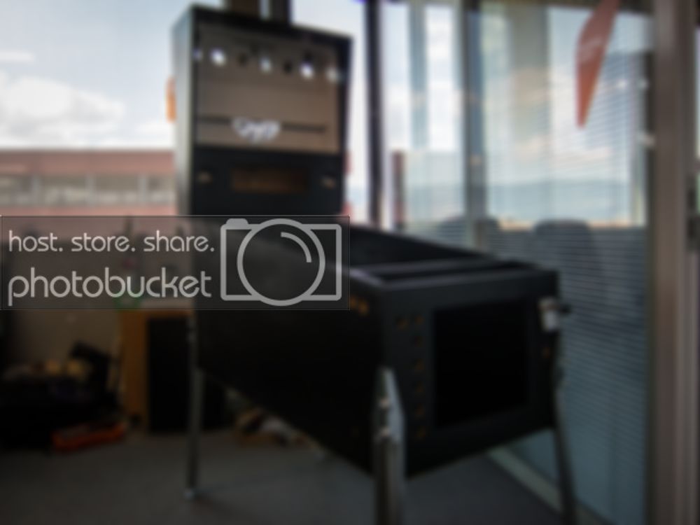

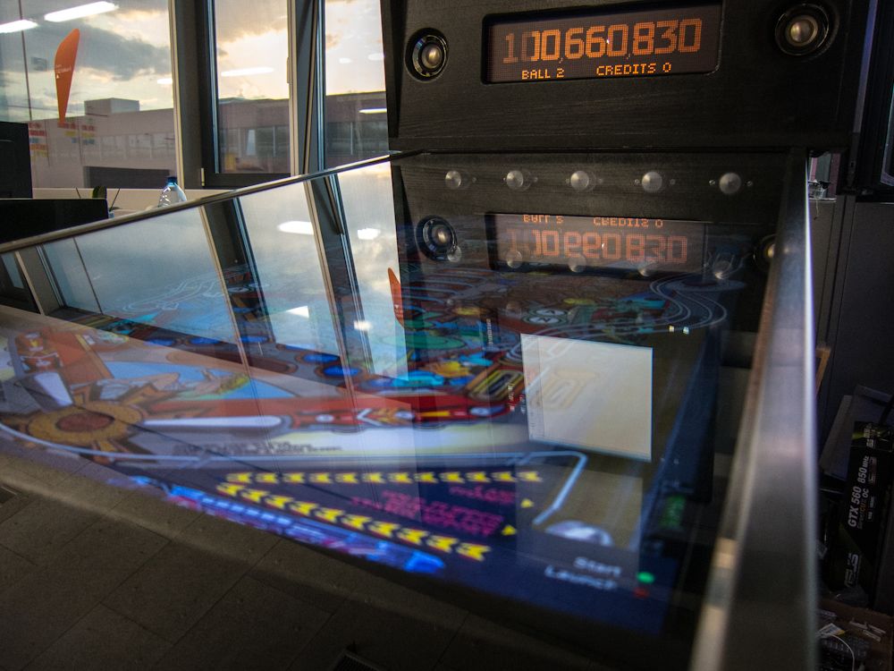

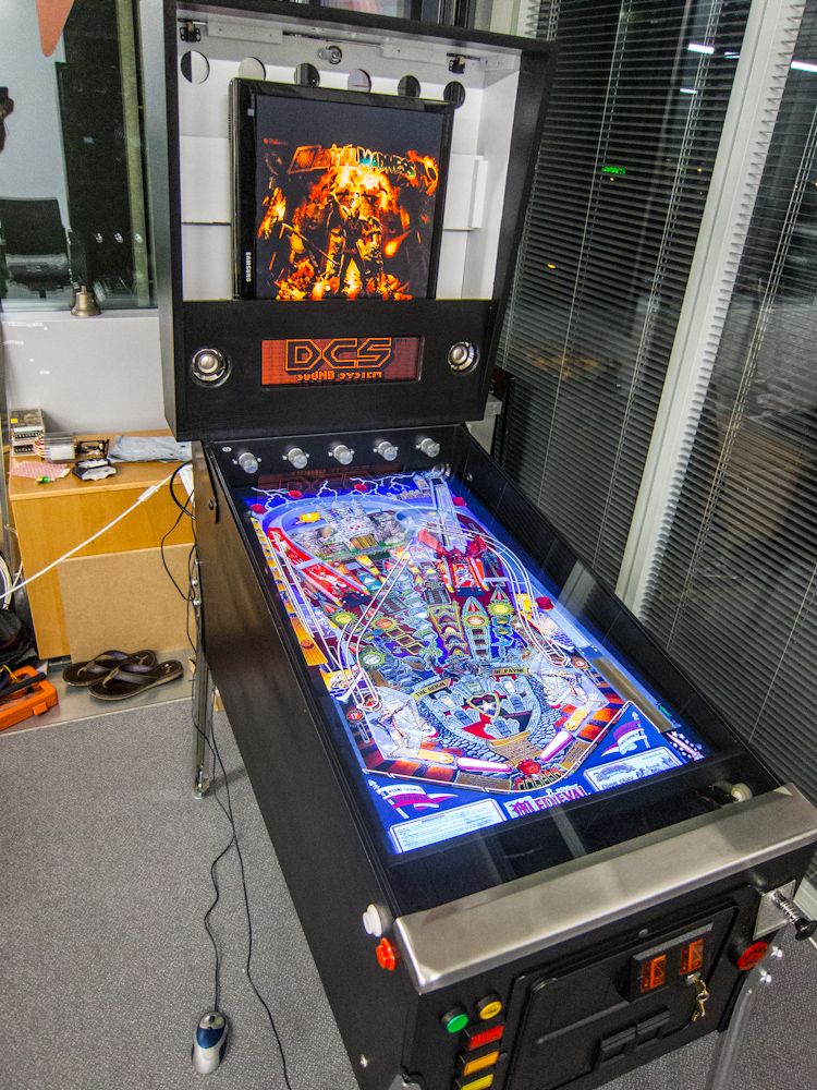

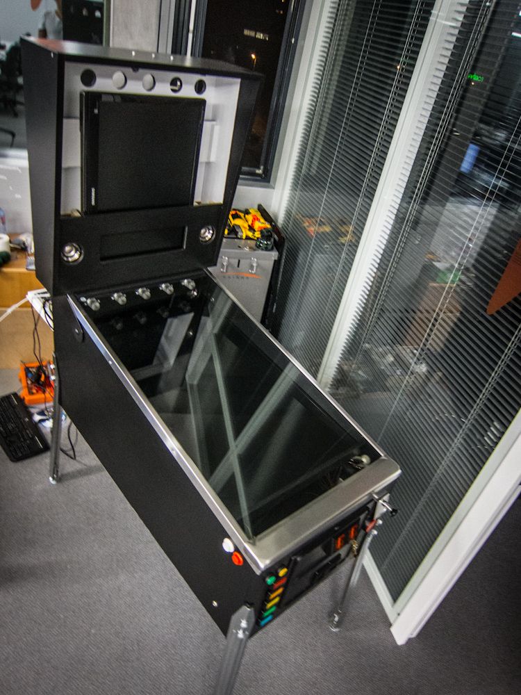

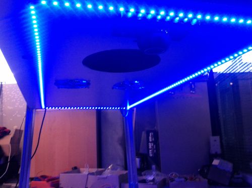

freezy Posted August 27, 2012 Author Posted August 27, 2012 Now only four wheels are missing Sorry for the crappy quality, used my phone.

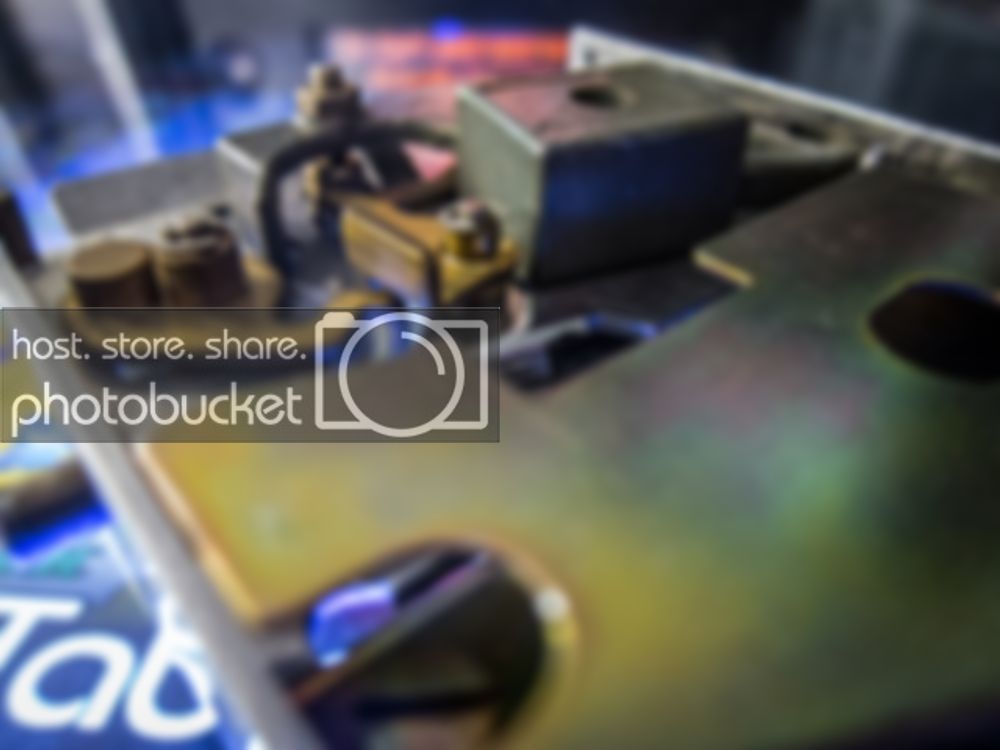

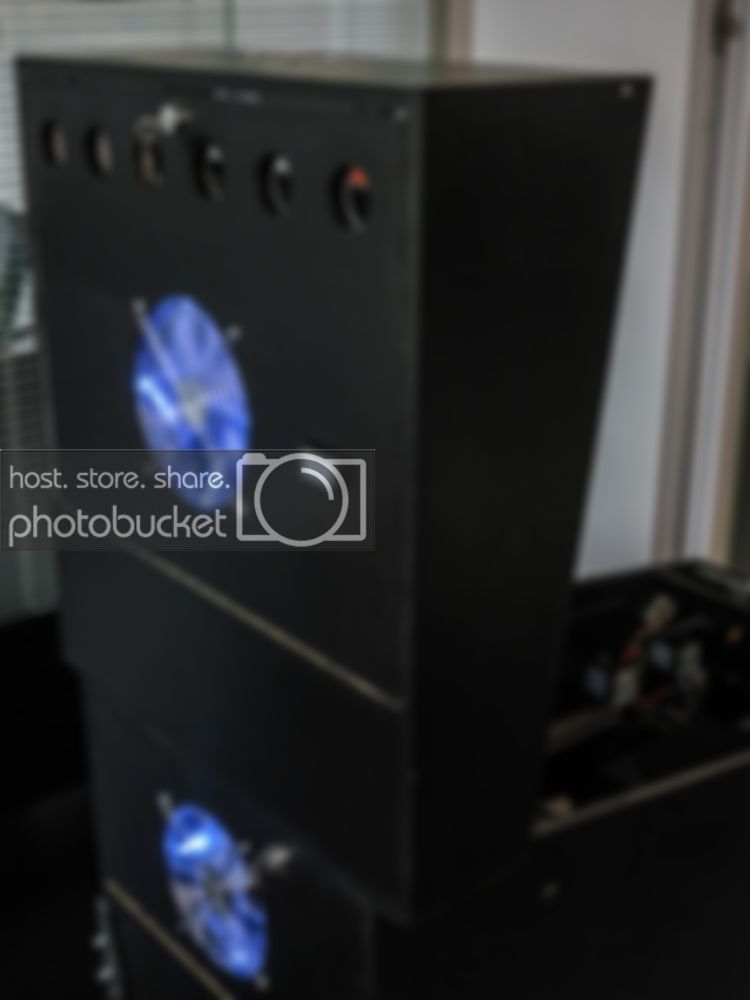

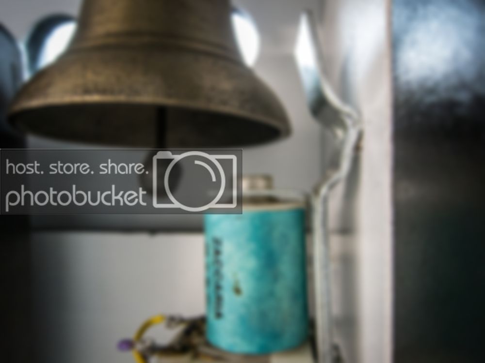

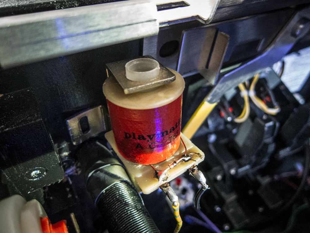

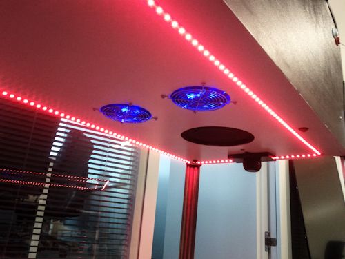

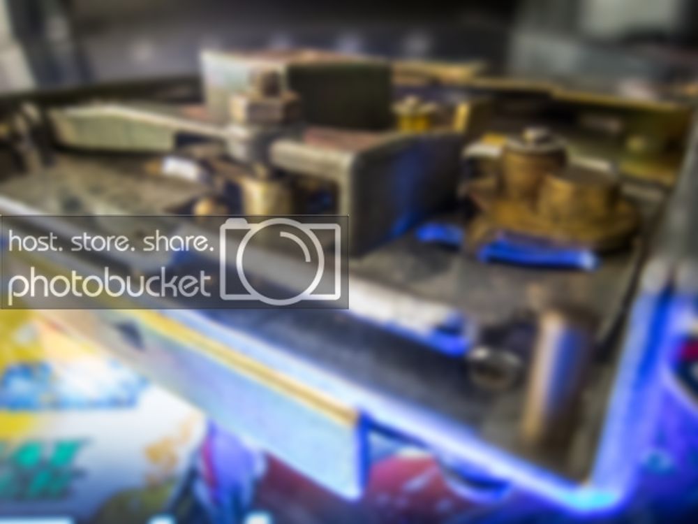

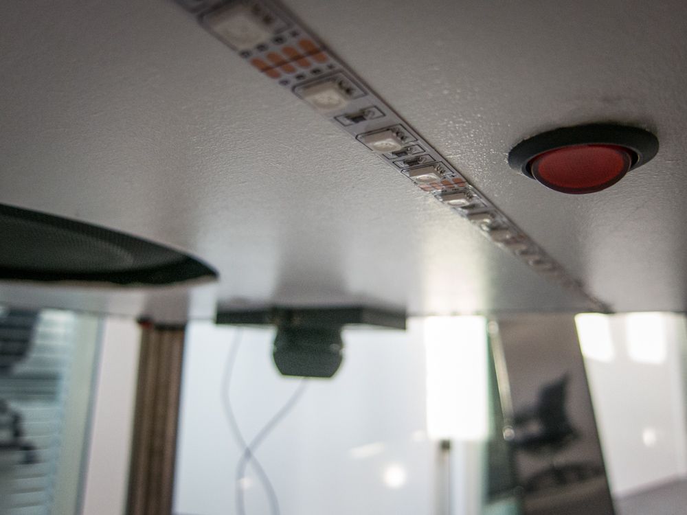

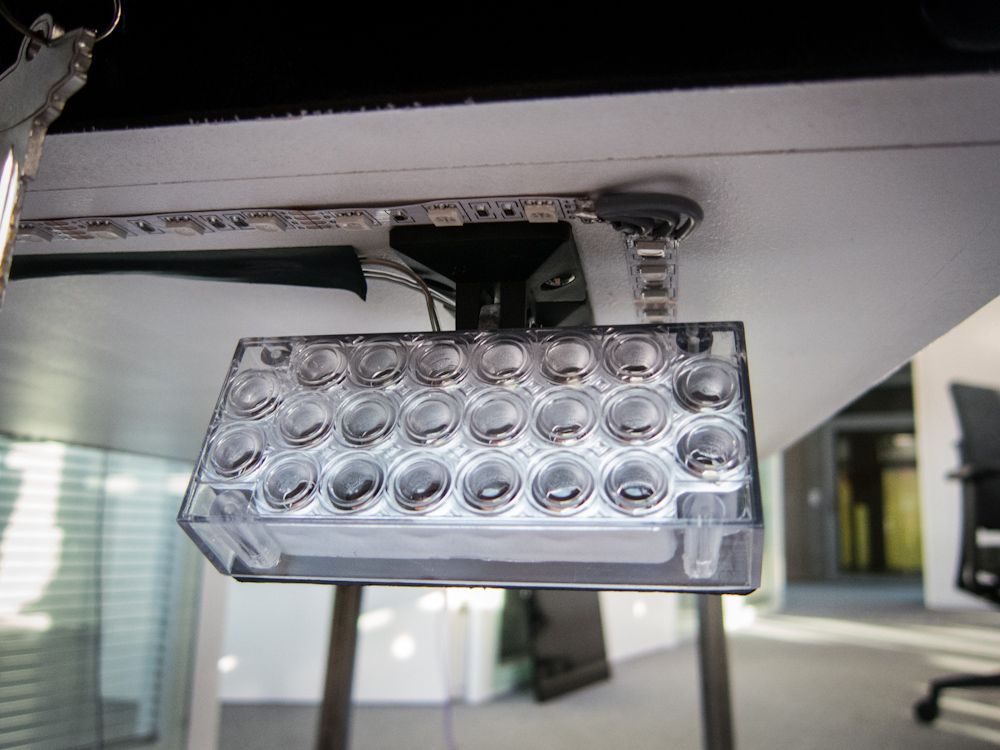

freezy Posted August 29, 2012 Author Posted August 29, 2012 Some more progress. Firstly, I've mounted one of the two replay knockers. It hits straight on the lockdown bar and I can confirm that gives an awesome sound and even better force feedback! Stay tuned for the second one, that will be a surprise. Then I added the strobes, both below the cab. One pair will flash the floor and another the wall behind the machine. Not sure if that will give the wanted effect on its final position, but I have another pair that I could mount somewhere else. About the wiring I still have to figure out how to attach those flasher cables so they don't cover Led-Wiz all the time. Not sure if I already showed this: The night button that turns off the solenoids and the knockers. And for the record, I'm still quite pleased with the TV's image quality

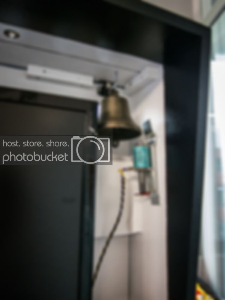

freezy Posted August 30, 2012 Author Posted August 30, 2012 Now to the second replay knocker: Somehow some Swiss feeling had to be added!

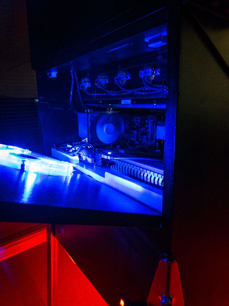

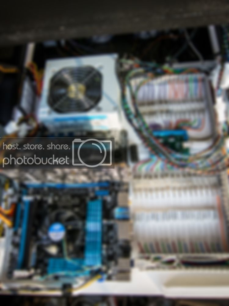

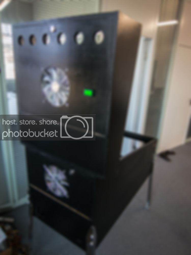

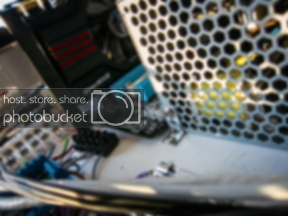

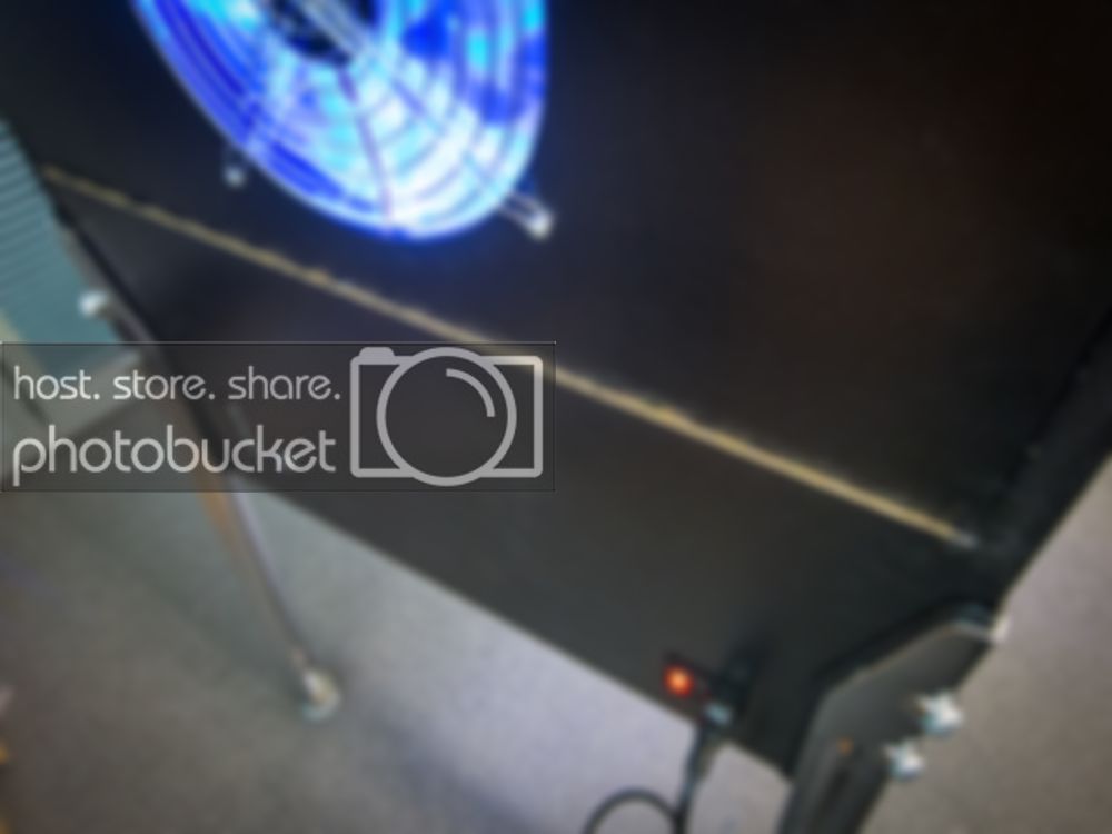

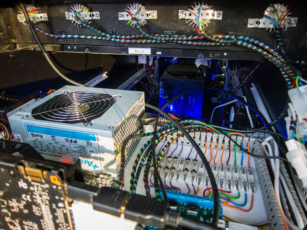

freezy Posted October 4, 2012 Author Posted October 4, 2012 Wow, already a month gone. Besides vacation I was mainly working on small improvements and fighting software (and playing the shit out of it, of course). After tidying up most of the wires, the drawer now closes smoothly. Installed the ports on the back side: USB, ethernet and power. Also fixed down the PSU as well as the graphics card: Still looks best at night. Now I really need to get a concrete idea about the art work.

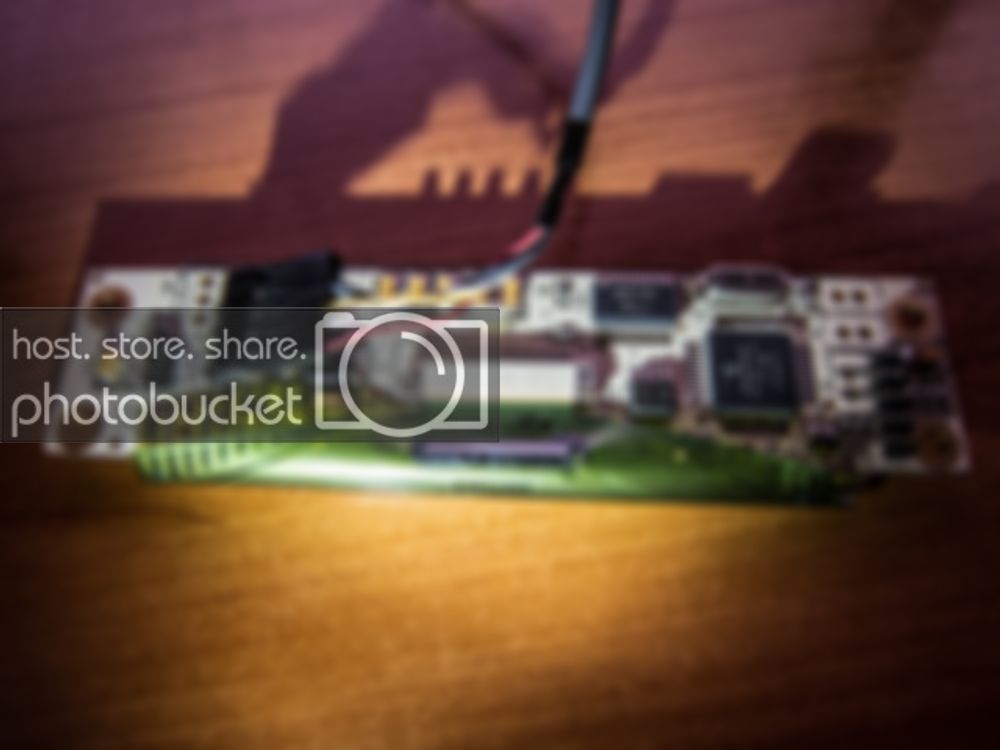

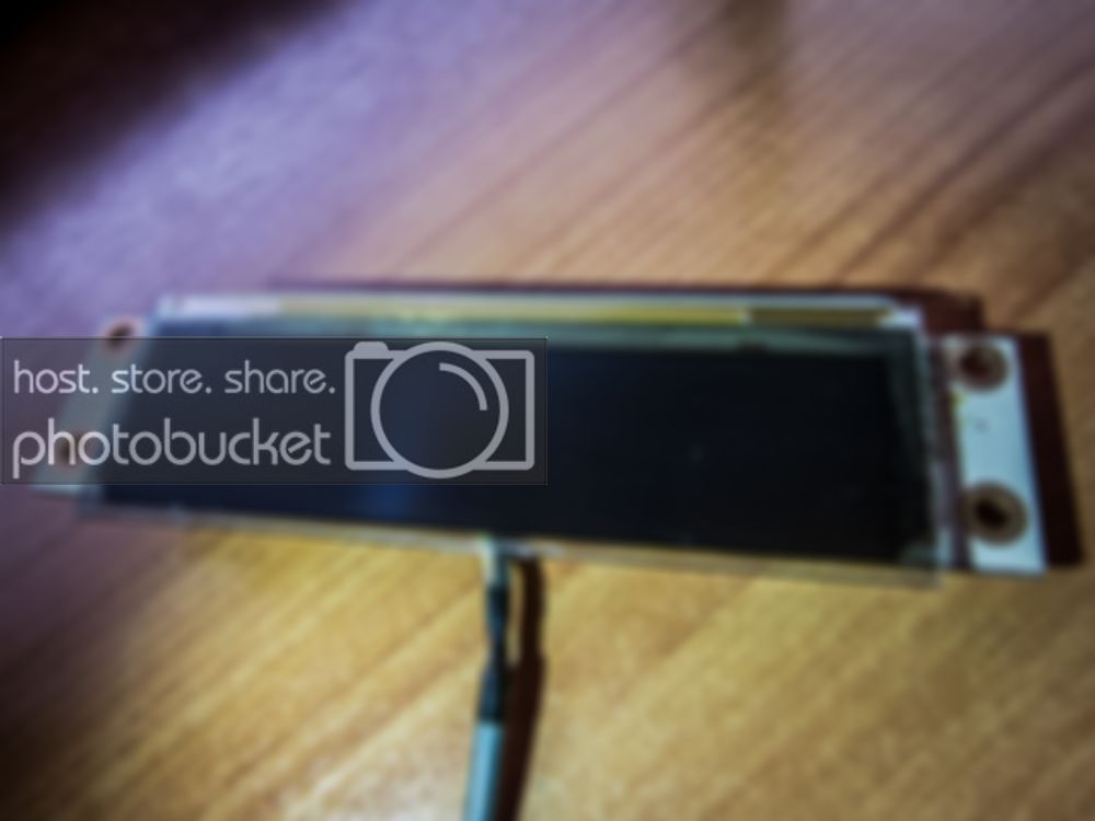

freezy Posted November 15, 2012 Author Posted November 15, 2012 Look what I've found in my old HTPC: It's an OLED display with a 256x24 resolution (I think) and 16 tones per pixel. Putting this in the middle of the apron under the glass would be awesome Anyone from the DMD experts knows what it takes to integrate this with vpinmame?

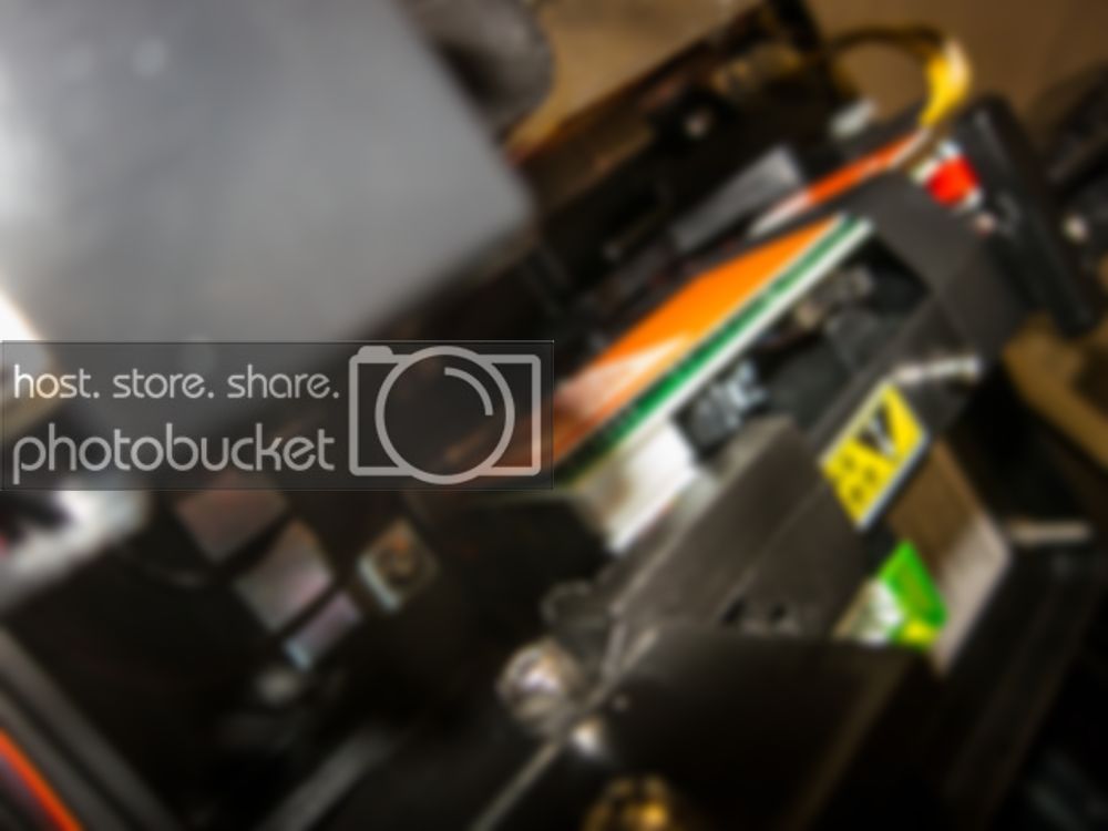

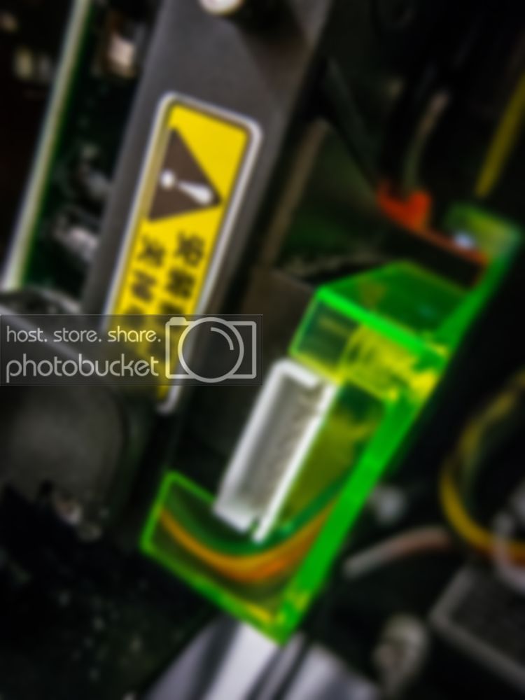

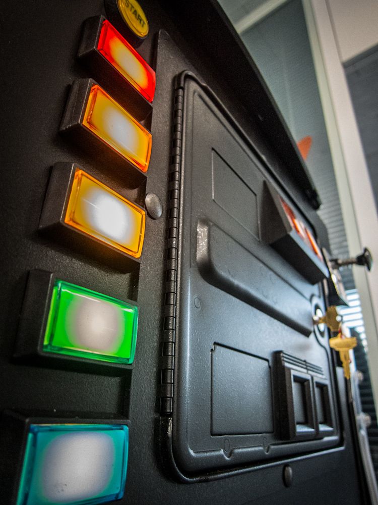

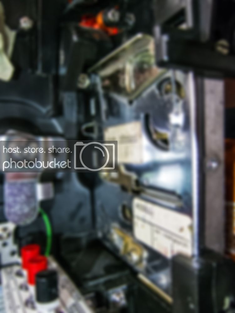

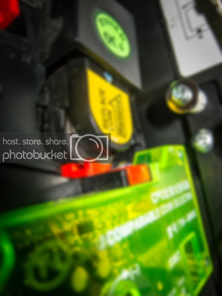

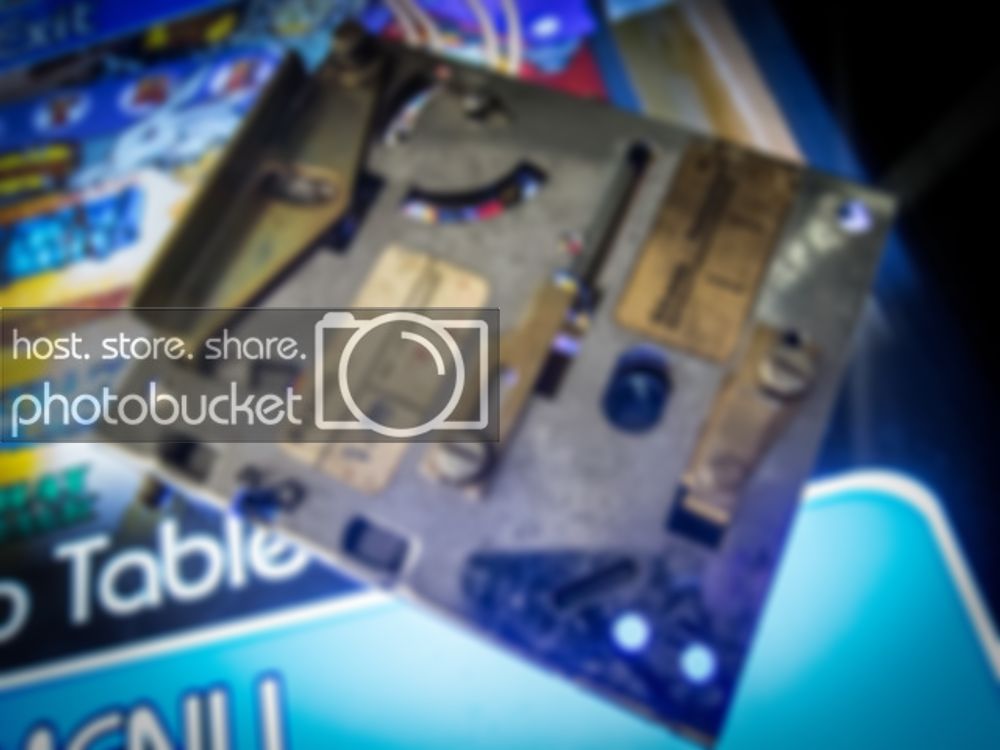

freezy Posted November 23, 2012 Author Posted November 23, 2012 So a few weeks ago a really nice guy gave me a handful of coin mechs for ten bucks (thanks again Peter!). This is a 50 Swiss cents coin mech, exactly what I need. Basically, the coin goes in here: Then passes through this, where weight, size and magnetic property are validated. Fascinating device. Mounted into the coin door, it looks like this: So when the coin gets validated it falls behind the coin door, triggers a controller button and drops into my cash box. Otherwise, it ends up at the other side, which is the reject tray at the front of the door. For the second coin slot I want to validate a smaller unit, so I bought an electronic validator that is easily adjustable, just put the coin to validate against in here: However, in order to mount the sucker, I had to rip off the plastic cover of one side and file off some of the coin door's plastic: Now it fits but the idiots where I ordered forgot to include the cable: So no testing yet, until they send it. For now, the mechanic one already works perfectly (love the sound when the coin falls through and validates), while the other one just sits there. By the way the art work is progressing, I'll post sketches and stuff once it's finished.
