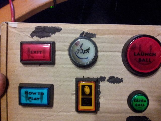

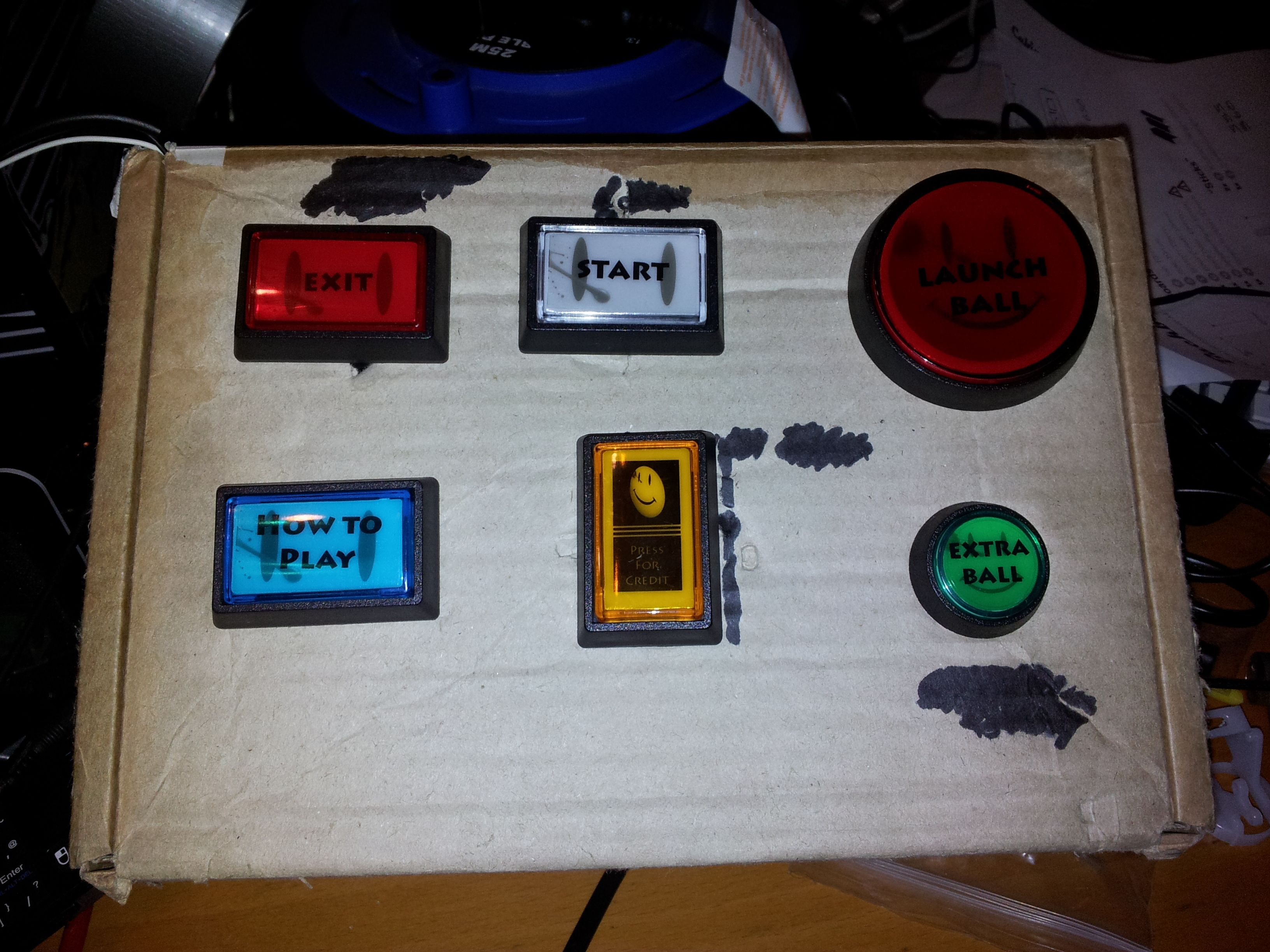

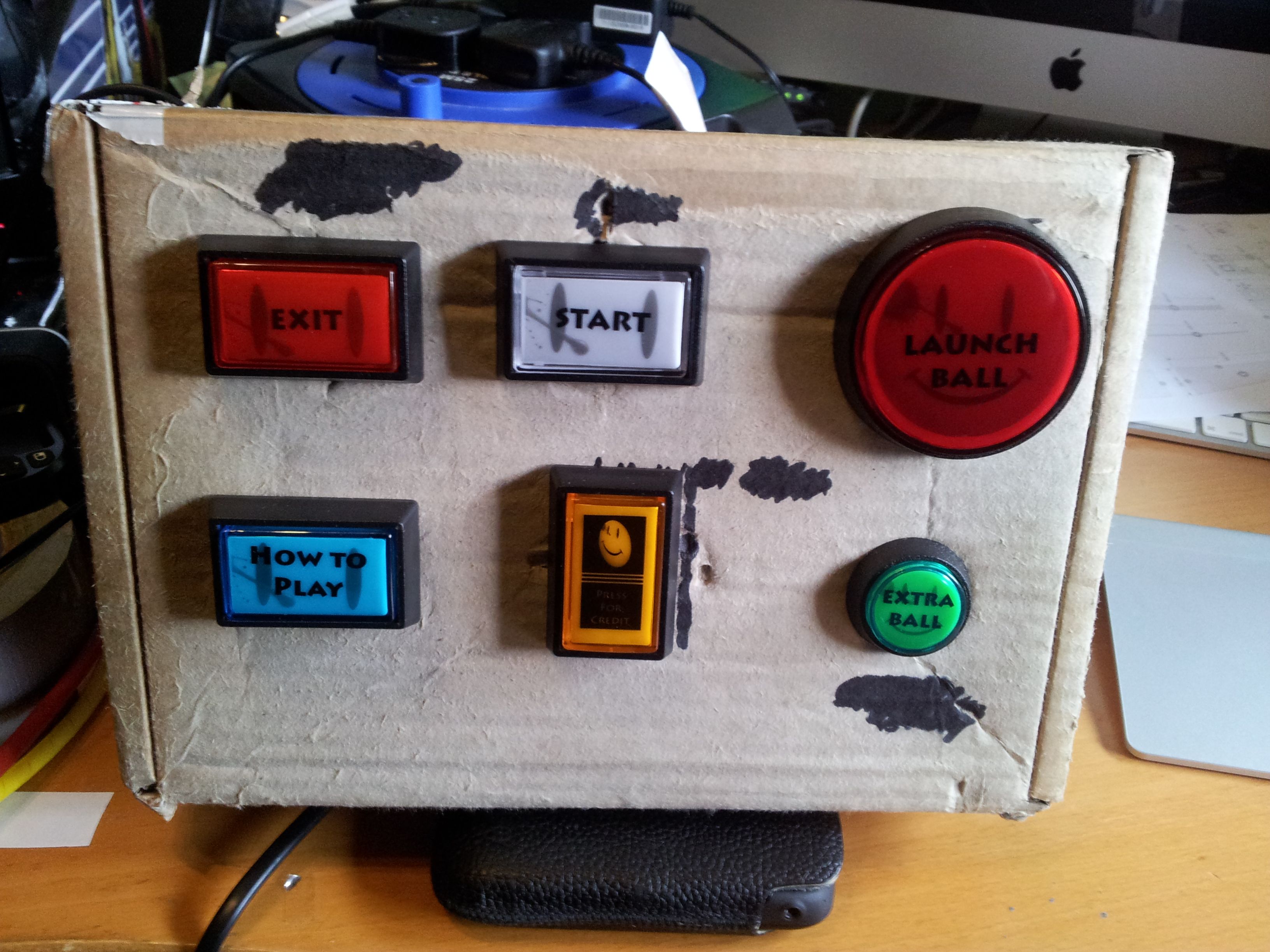

mikekim Posted August 30, 2012 Author Posted August 30, 2012 Progress update: playing around with the ipac and buttons for the past couple of days. built the obligatory cardboard box with all the buttons that i will be using on my cab, to test the ipac programming (also a good excuse to play some pinball with proper leaf buttons, rather than keyboard). at the moment the box is all illuminated from a single 12v power source. looking to replace the buttons, as i'm not happy with the square ones, don't think they will look right on the cab (probably 4cm diameter round ones, are the current replacement options). also have ordered a Yellow Launch Ball button never realised how hard it is go get a good shot of illuminated buttons with a camera phone - will have to break out the DSLR for the build shots the nice tidy internal shot - NOT next instalment::: my LEDWiz and 2 of Zebs booster boards have arrived this week, so i will be playing with them next will also probably pick up the contactors and test them out properly before starting on the cab body
DeeGor Posted August 30, 2012 Posted August 30, 2012 at the moment the box is all illuminated from a single 12v power source. I'm not sure if you're using regular bulbs or not, but if you are, don't leave the bulbs on for too long. At 12v, they will melt your buttons. power them at 5v or better yet, go with leds.
mikekim Posted August 30, 2012 Author Posted August 30, 2012 I'm not sure if you're using regular bulbs or not, but if you are, don't leave the bulbs on for too long. At 12v, they will melt your buttons. power them at 5v or better yet, go with leds. thanks for the tip - i have noticed they get quite warm (they are only on for a couple of minutes). have ordered some led replacements
