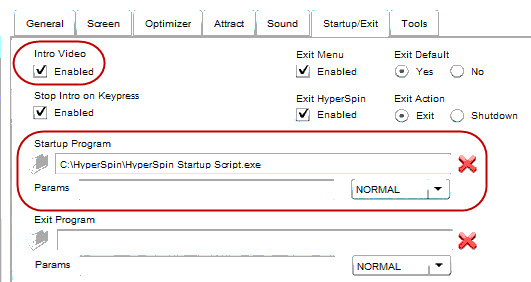

123jimbo Posted August 21, 2014 Posted August 21, 2014 Contents of HyperSpin Startup Script.ini (close to default I think) [Required] HyperSpin_Folder_Path=C:\HyperSpin HyperLaunch_Folder_Path=C:\HyperSpin\HyperLaunch [General] Primary_Color_RRGGBB=363636 Secondary_Color_RRGGBB=ffffff [Controls] Joysticks_Enabled=False Joystick_Delay=225 Joystick_Deadzone=25 [startup] Minimize_Background_Windows_Enabled=true Window_Classes_To_Not_Minimize=Shell_TrayWnd,Button Process_Name_To_Close_1= Program_To_Run_Target_1= Program_To_Run_Working_Dir_1= Program_To_Run_MaxMinHide_1= [Exit] Restore_Windows_On_Exit=true Process_Name_To_Close_1= Program_To_Run_Target_1= Program_To_Run_Working_Dir_1= Program_To_Run_MaxMinHide_1= [Roulette] Roulette_Key=~1 Roulette_Min_MilliSeconds=3000 Roulette_Max_MilliSeconds=8000 [Volume_Menu] Volume_Menu_Key=~2 Volume_Bar_Offset_From_Bottom=44 [QuickLaunch] QuickLaunch_Key=~3 QuickLaunch_Enabled=true QuickLaunch_Left_Offset=5 QuickLaunch_Top_Offset=10 QuickLaunch_Bottom_Offset=10 Item_1_Path= Item_1_Parameters= Item_1_LogoPath= Item_1_Ignore_Process_Close=false Attached is the Startup/Exit tab of HSHQ
ghutch92 Posted August 21, 2014 Author Posted August 21, 2014 Ok that clears up my confusion. I thought you were launching hyperspin as a Program_To_Run_Target. All I know is I've tested it with and without the video and I've had no activation issues. It's hard for me to fix this if I can't duplicate it, so um continue using the video since it works for you. How to Install HyperSpin and more RocketLauncher HyperSpin Startup Script
