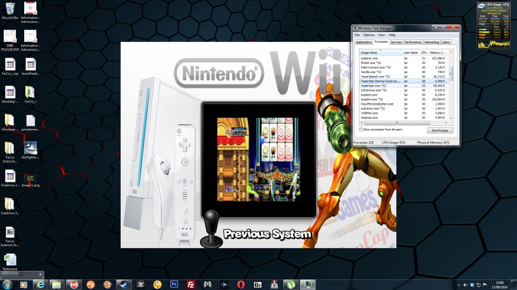

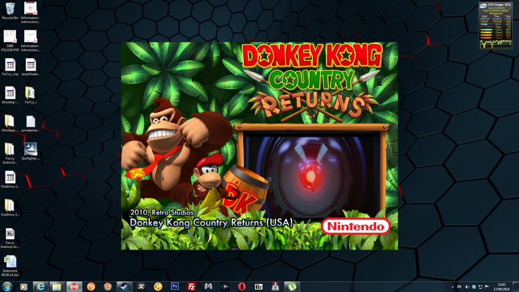

SIMPLYAUSTIN Posted September 17, 2014 Posted September 17, 2014 Much thanks for this again Ghutch and may I say what an amazing Icon you have there Im having an issue though. Not sure if you have read my post about WiiMotes but its causing me some major issues More detail is in the Gold section ref this. But in short, when I enable a WiiMote, I can play for example Wii. However once I exit the Wmu and return back to Hs my controls for the 360 go mental, as if I have no configuration. It also makes me loose focus of my KB too if I exit HS and reload it. I have to click the mouse to enable key support. The only way to get around this is to restart my entire system. Do you think there is anything that can be done to cure this? I do not want to loose the function of your program.. but also dont want to loose the function of the WiiMotes for my games. Sorry to be a pain Simply Austin's YouTube
ghutch92 Posted September 17, 2014 Author Posted September 17, 2014 Much thanks for this again Ghutch and may I say what an amazing Icon you have there Im having an issue though. Not sure if you have read my post about WiiMotes but its causing me some major issues More detail is in the Gold section ref this. But in short, when I enable a WiiMote, I can play for example Wii. However once I exit the Wmu and return back to Hs my controls for the 360 go mental, as if I have no configuration. It also makes me loose focus of my KB too if I exit HS and reload it. I have to click the mouse to enable key support. The only way to get around this is to restart my entire system. Do you think there is anything that can be done to cure this? I do not want to loose the function of your program.. but also dont want to loose the function of the WiiMotes for my games. Sorry to be a pain There is nothing I can do on my end until I get some wiimotes to test with. Try turning the wii motes off before you return to hyperspin see if this helps. How to Install HyperSpin and more RocketLauncher HyperSpin Startup Script
gigapig Posted September 17, 2014 Posted September 17, 2014 Much thanks for this again Ghutch and may I say what an amazing Icon you have there Im having an issue though. Not sure if you have read my post about WiiMotes but its causing me some major issues More detail is in the Gold section ref this. But in short, when I enable a WiiMote, I can play for example Wii. However once I exit the Wmu and return back to Hs my controls for the 360 go mental, as if I have no configuration. It also makes me loose focus of my KB too if I exit HS and reload it. I have to click the mouse to enable key support. The only way to get around this is to restart my entire system. Do you think there is anything that can be done to cure this? I do not want to loose the function of your program.. but also dont want to loose the function of the WiiMotes for my games. Sorry to be a pain I had similar troubles, with the wheel going crazy, but worse was the CPU cycles startup is using, with or without the wiimote connected.
potts43 Posted September 17, 2014 Posted September 17, 2014 I suddenly started having that mad spinning...at least I now know where it's starting from..;-)
ghutch92 Posted September 17, 2014 Author Posted September 17, 2014 (edited) I had similar troubles, with the wheel going crazy, but worse was the CPU cycles startup is using, with or without the wiimote connected.[ATTACH=CONFIG]45012[/ATTACH] [ATTACH=CONFIG]45013[/ATTACH] See how the cpu does when hyperspin is not the active window. That's when it really matters. The y axis controls the wheel spin. When it is neutral or 50% of the way no spin occurs. If it at 0% spin down occurs If it is at 100% spin up occurs. You may want to see what is going on in the control panel gamepad configuration properties (joy.cpl). Edited September 17, 2014 by ghutch92 How to Install HyperSpin and more RocketLauncher HyperSpin Startup Script
gigapig Posted September 18, 2014 Posted September 18, 2014 Thanks ghutch, your correct about Hyperspin being active, the activity does drop when not in focus. Anyway I found I have some serious issues with my PC Temps are at 70 degrees at idle and it's throttling back at load, so a bit of a strip down is required. Apologies if I've confused things mentioning the startup app was using lots of cpu cycles.
