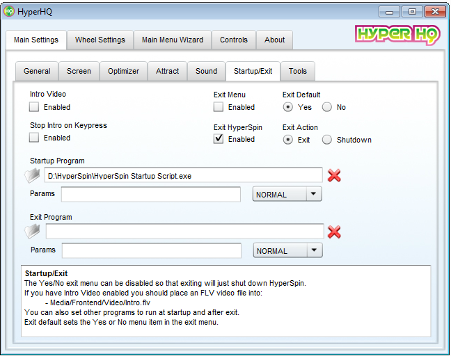

albert_c Posted October 2, 2014 Posted October 2, 2014 X360 PCB's work great with the HyperSpin Startup Script (known to work the Madcatz Brawlsticks (X360), Microsoft X360 controllers, Akishops PS360+, and MC Cthulhu). So you shouldn't have any problems. Firstly, in HyperLaunch, disable all the external keymapper functions. Then skip Xpadder setup entirely. I think the step that you missed is starting HyperSpin Startup Script to start with HyperSpin. Setting up the ini file with 'Joysticks_Enabled=True' is not enough. Go into HyperHQ in the Startup/Exit tab and browse to the HyperSpin Startup Script.exe file is located and set it to start with HyperSpin. Once done, it should work. When you find great deals on Craigslist for CRT based cabs, exuberance can be a bad thing! Current status of cabs: 0/5 working as desired :wallbash:

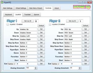

Striff Posted October 2, 2014 Posted October 2, 2014 That's what i did, in HLHQ, it's disabled : Joypad are disabled in Hyperspin setup And the script is in the startup options : So i removed everything linked to Xpadder to be sure, but it's still not working, i missed something else ?
albert_c Posted October 2, 2014 Posted October 2, 2014 I see that you don't have Intro Video Enabled ticked in HyperHQ. Some users have reported that the script doesn't work unless it is enabled. Or, if it isn't enabled, they have to ALT+Tab to shift focus to HyperSpin before it works (which isn't ideal). Anyways, enable Intro Video. Disable external key mappers in HLHQ and don't start the Xpadder profile in the script. Then give it another whirl. When you find great deals on Craigslist for CRT based cabs, exuberance can be a bad thing! Current status of cabs: 0/5 working as desired :wallbash:

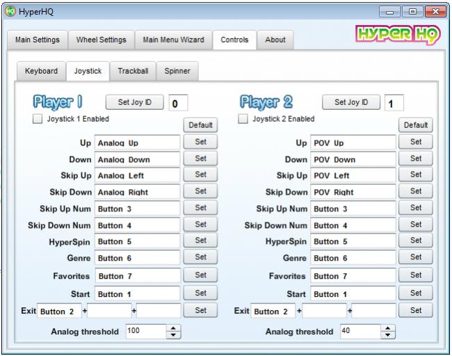

albert_c Posted October 2, 2014 Posted October 2, 2014 Try one more thing. Default the HyperSpin navigation functions for both 1p and 2p in HyperHQ and give it another whirl. When you find great deals on Craigslist for CRT based cabs, exuberance can be a bad thing! Current status of cabs: 0/5 working as desired :wallbash:
Striff Posted October 2, 2014 Posted October 2, 2014 @albert_c If this is here, i never touched it so it's the default settings (if i m not wrong) : So i think we've tried everything @gigapig : But if you use xpadder there is no way to only use it with hyperspin and disable it when you're ingame ?
albert_c Posted October 2, 2014 Posted October 2, 2014 [ATTACH=CONFIG]45344[/ATTACH] In HyperHQ, not HyperLaunchHQ. Hit the Default button on this screen. When you find great deals on Craigslist for CRT based cabs, exuberance can be a bad thing! Current status of cabs: 0/5 working as desired :wallbash:
Striff Posted October 2, 2014 Posted October 2, 2014 No more luck with this try i think it s just dead for me at this point

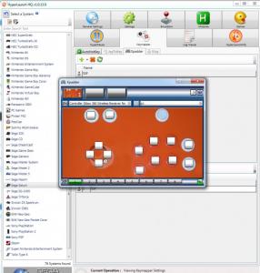

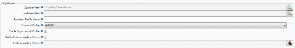

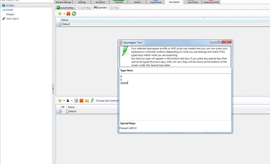

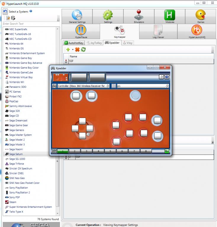

Striff Posted October 2, 2014 Posted October 2, 2014 I don t know what do, everything is set in HLHQ, xpadder is not starting when i launch hyperspin. I added a profile in GLOBAL => KEYMAPPER, it s working fine when i test it : The setup is good : It's disabled on emulators like this : But when i start Hyperspin, nothing happen, xpadder is not started. Do i have to specify something in HLHQ to tell him to load xpadder when hyperspin is launched ? I may think i have to add HyperSpin as a system maybe? If yes how ? :
