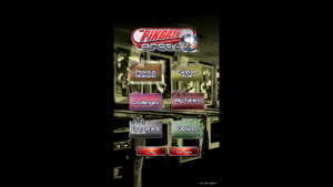

fischb Posted February 20, 2016 Posted February 20, 2016 I just tried the new module. Here is what my screen starts as: Navigation is going to Challanges Home Arcave Room
Metalzoic Posted February 20, 2016 Author Posted February 20, 2016 I just tried the new module. Here is what my screen starts as: Navigation is goingscreen.png to Challanges Ah. I was just typing a reply to ask you for a screen shot and you beat me to it. Nice. You didn't mention you were running it in a portrait mode. That puts your menu items in a different order than the menu normally is, which is throwing the module off. Your menu is 2 across and 3 down. Normally it should be: Previous Seasons - Season 5 - Challenges (on top) My Tables - Tournament - Options I'll make you a custom version of the module that will work with your cab. Give me a few hours... just woke up. PS: Awesome game room by the way! Really nice. That racing rig is badass! I have 3 arcade machines, including my Hyperspin cab and professional air-hockey table, but they are all out in the open in our family room area (I don't have a spare room. Ha!). I don't have a pinball machine in the house yet, but I do have a brand new JJP Hobbit on the way (hopefully soon, I bought the damn thing 3 years ago!) and I've also pre-ordered a new Aliens machine from Heighway Pinball (which probably won't be built or delivered for another year I figure).
Metalzoic Posted February 20, 2016 Author Posted February 20, 2016 OK man try this. I can't really test it myself so let me know asap if it's working fine. 1. Download and put this module into your RocketLauncher>Modules>Pinball Arcade folder. Leave the name as-is (and don't overwrite you normal PinballArcade.AHK file). 2. Go into RocketLauncherUI. Go to the Global System > Emulators tab double click on Pinball Arcade from the list and change the selected module to this new one. Close that. 3. Go to the Pinball Arcade System on the left > Modules tab and this module should be on the list (it should also be yellow designating it as a custom module). Select it and set your module settings. 4. Try it! I already changed your Starting table to TotAN within the module so you don't need to do it yourself. Hopefully that works first shot, but I just did it off the top of my head so if it doesn't let me know and be as detailed as possible about what's going wrong. Pinball Arcade Portrait.ahk
