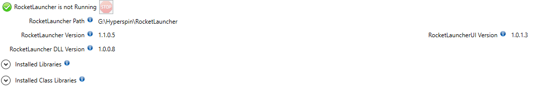

kreator Posted May 6, 2016 Posted May 6, 2016 Hi, thanks for the fast reply :-) I just updated everything yesterday, thinking that i was outdated :-( But now i opened the RLUI and i have 6 new updates. I aplied them and try again. Now i have: PA Module Emul. Version : 1.49.9 RL V.: 1.1.0.5 RL DLL V.: 1.0.0.8 RLUI V.: 1.0.1.3 And i get the same error. Now i'll try to downgrade only the module to the one in this tutorial. I'll let you know what :-) Thanks for the help. EDIT: I downgraded the module to the tutorial one: PA Module Emul. Version : 1.48.7. I changed to I have all tables and deleted the ones in th field My_tables. And now i get this error: ScriptError - This is a folder and must point to a file instead: \ Maybe i get the error coz i upgraded all the RL. Thanks. EDIT 2: I just tried Pinball FX2, that i had it running before the upgrade, and i get the same error. Then waiting for a un upgrade :-)
Metalzoic Posted May 6, 2016 Author Posted May 6, 2016 Thanks, from your posts I just realized that I forgot to update the version number in the module. I've updated it to say 1.49.9. This doesn't change how it works though. Did you also revert to the .isd that goes with that AHK (also in the first post)? Possibly that might help, but I think it's just because the RL update caused system wide problems. I completely reverted to the prior version. The error you're getting now didn't happen after they first updated RocketLauncher so in trying to fix all the other problems it looks like they are maybe creating more. I wouldn't worry about it too much at this point, the new (and absolutely terrible) UI/Menu for Pinball Arcade is due to hit any day now and it will completely break all modules and make TPA no longer work as a standalone system in RL/HS. This was supposed to happen last week all ready, so we'll see.
