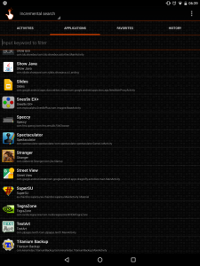

Sting Posted January 16, 2016 Posted January 16, 2016 Download this example .xml Reznnate uploaded (http://www.hyperspin-fe.com/files/file/7810-sample-androidxml-for-hyperspin-android-launcher/) this will give you a template to edit for your own setup If you look though, the game name says something like (com.disney.ducktalesremastered_goo) this is the the shortcut to the pre installed (apk) on your Android device. You can find this with a file explorer under (Android/data) or (Android/obb) in the root menu. But I personally use (Quickshortcut Maker), once you edit the (game name) of any game in the (xml file) and then the description so you know which one it is on your wheel, when you click on that game on your wheel it should just start Here's a screen shot
