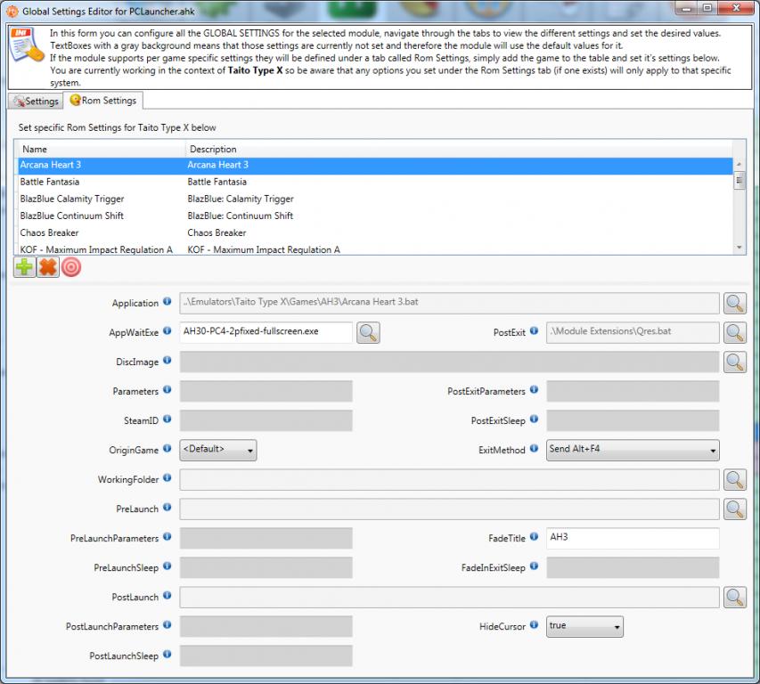

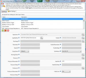

Finally got this sucker (AH3) to work.
It was the appwaitexe which I had wrong. Originally it was "game.exe"
So worked out that the batch file is pointing to "AH30-PC4-2pfixed-fullscreen.exe", so I changed Appwaitexe to that.
Also using leolangone777 suggestion of Qres. Which works really well.
If you need the 2 files, they are in my ftp folder. Just put them in Module extensions and point "postexit" to the Batch file. You will need to edit the batch file if you are not running at 1920x1080.
Not 100% sure of this but, to set the keys you can drag "AH30-PC4-2pfixed-fullscreen.exe" onto "pad_config.exe" to set them?
Hope it wasn't a 1 off.

For those of you who are having problems with AH3 not changing your resolution back, I have an easy solution.
1- Download QRes and place it in your Module Extensions folder
2- Create a batch file to change your resolution back. In mine I have "qres.exe /x:1920 /y:1080"
3- Under Rom Settings for AH3, edit your PostExit to the location of your resolution changing bat file
There are other quick programs to change your resolution, but I've been using QRes for quite some time and it has never given me any problems. With RL, using a program like QRes on exit has never been so easy. I spent days in the past getting Taito Type X to work right, with RL it took maybe an hour. :D
[ATTACH=CONFIG]29222[/ATTACH]

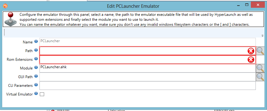

can anyone tell me what name I need to put in my wheel and what global emulator I need to choose? Seems the edit global setting button in the pictures does nothing until I set everything prior up correctly.
Ok. I'll let you know what I have and maybe you guys can fill me in on my ignorance. I have added the available themes THK offered, and renamed them according to the available XML file, also grabbed Jimmy's wheel art and made sure those names are also the same. I also added Taito Type X into HyperHQ and added emulators\Taito Type X\Emulators\Taito Type X\Games to the roms path (it's this way due to the folder path hosted on the ftp, it was a straight copy.) What I'm getting lost is the true setup from HyperLaunch HQ. 1) Do I choose PCLauncher Global emulator 2) What about the AHK file (which do I use and the ini that goes under the settings. There is a picture I can barely see here: http://www.hyperspin-fe.com/forum/showthread.php?26741-Taito-Type-X-and-Hyperlaunch-3-0/page8&highlight=taito+type but I'm not sure what module to choose or emulator to have. Basically, I can't get to the section to edit the global settings as shown in the picture.
Here is a pic of the window I'm not sure what to put in here...if anything in here at all. BTW from the FTP I did copy the entire Taito Type X folder from djvj's FTP folder. If that helps you guys. Let me know what I need to have. If this isn't appropriate. I'm welcome to PM.
edit. forgot the picture: post-75313-142870594808_thumb.png
edit. forgot the picture: [ATTACH=CONFIG]29343[/ATTACH]
Nothing. Just check the virtual emulator box.
The pclauncher ahk has been updated in the last few weeks, so its much easier to setup.
