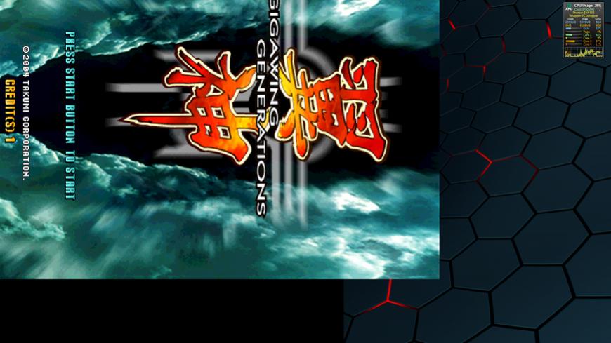

it's definatley pointing to the right module for me, but dxwnd keeps popping up telling me its already running, and they still don't rotate no matter what I try
[sIGPIC][/sIGPIC]
Does it stay in the system tray? Would also need to use irotate? its in module extensions.
I'm watching Olympus has Fallen at the minute so I can't test anything :(
ive set it to stay minimised that's done the trick, still wont rotate using irotate as prelaunch though
[sIGPIC][/sIGPIC]
use display.exe to rotate instead

ive got them all working, I just cannot for the life of me get the shoot em ups to rotate, arrrgggghh its a head wrecker for sure.

I have to hate myself right now. The reason it kept giving me this module does not support Taito Type X was because I didn't have the updated HyperLaunchHQ. I'm on 1.07.0, hyperlaunch version 3.0.0.8 now. Once I got the new exe's in there it allowed me to click on the box. Now just need to figure out what to put in the boxes below. I just added King of Fighters XIII to the list. I'm sure there are ton more things I have to add.
So I think I'm at the same point in this as you guys.
Got Gigawing to start, DXWnd has started. I added a path to game.exe in DXWnd so it goes into a border less window, but neither irotate or display.exe seem to start.
Bed time.:goodnight:

Did you download the dxwnd.exe and put it into \HyperSpin\Emulators\DXWnd?
Then I added a new emulator in the taito type x tab, named taito vertical, path \HyperSpin\Emulators\DXWnd\dxwnd.exe, selected DXWnd module, ticked virtual monitor. Go into modules and set up the rom in PClauncher the same way as other roms. I've just realised I have setup a new emulator but I'm not using it doh, off to try defining the game to use the taito vertical emu.
I think I may have this wrong after reading the DXWnd module notes:
MEmu = DXWnd

Edit: I did add the path to game.exe into DXWnd.
It's running:
08:52:53:319 | MD | INFO | +218 | Module Run - Running: E:\HyperSpin\HyperLaunch\Module Extensions\dxwnd.exe
08:52:53:394 | MD | DEBUG1 | +62 | Module Run - "dxwnd.exe" Process ID: 7808
08:52:53:599 | MD | INFO | +219 | Module Run - Running: E:\HyperSpin\Emulators\Taito Type X\Games\GigaWing Generations\E:\HyperSpin\Emulators\Taito Type X\Games\GigaWing Generations\GigaWing Generations.bat
08:52:53:638 | MD | DEBUG1 | +31 | Module Run - "E:\HyperSpin\Emulators\Taito Type X\Games\GigaWing Generations\GigaWing Generations.bat" Process ID: 7848
08:52:53:643 | MD | DEBUG1 | +0 | GetActiveWindowStatus - Title: BlackScreen2 | Class: AutoHotkeyGUI | State: 0 | X: 0 | Y: 0 | Width: 1080 | Height: 1920 | Window HWND: 0x10abe | Process ID: 7372 | Process Path: E:\HyperSpin\HyperLaunch\HyperLaunch.exe
08:52:53:647 | MD | INFO | +16 | Module WinWait - Waiting for YOKUSHIN ahk_class TOPWINDOW
08:52:54:098 | MD | DEBUG1 | +452 | GetActiveWindowStatus - Title: YOKUSHIN | Class: TOPWINDOW | State: 0 | X: 0 | Y: 0 | Width: 496 | Height: 678 | Window HWND: 0x20ad0 | Process ID: 7380 | Process Path: E:\HyperSpin\Emulators\Taito Type X\Games\GigaWing Generations\game.exe
08:53:04:194 | MD | INFO | +10093 | Module Process - WaitClose game.exe
08:53:26:610 | MD | INFO | +22418 | Module WinClose - Closing: DXWnd
08:53:27:049 | MD | INFO | +436 | Module Process - WaitClose 1
"Computer games don't affect kids; I mean if Pac-Man affected us as kids, we'd all be running around in darkened rooms, munching magic pills and listening to repetitive electronic music."

Sorry Sir, I think we have our wires crossed, I thought you meant irotate not DXWnd.
I could see that had started but not iRotate.
Same situation with display.exe.
I'm following this thread closely. If you guys get it figured out I'd like to know the steps. Temp solution for now is to use ArcadePC Launcher but some of the setting zip files it copies the launcher and etc from can be old depending when the rom was dumped.
It's not running because you have your game set to use standard, not vertical:
08:52:53:100 | MD |     INFO  | +16    | Module Setting - VerticalMethod: irotate
08:52:53:102 | MD |     INFO  | +0     | Module Setting - [b][color="#FF0000"]System: standard[/color][/b]
Look close at the module conditionals:
[color="#FF0000"][b]If system = vertical[/b][/color]
{	If verticalMethod = irotate
	Run("iRotate.exe /rotate=90 /exit", moduleExtensionsPath) ; another option to rotate screen
Else If  verticalMethod = display
	Run("display.exe /rotate:90", moduleExtensionsPath) ; Switching to 90�
;Sleep, 200
The module is made to handle the scenario you want to force your games into a window, not just going vertical by using display/irotate. It's a dxwnd module, not an irotate one.
