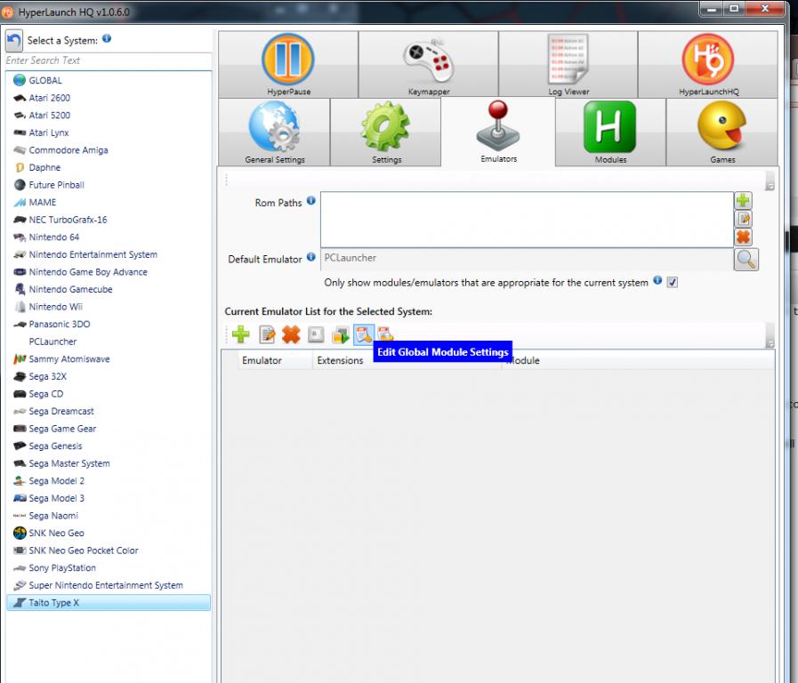

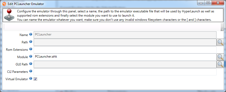

You need to set up a wheel for taito type x in HyperHQ. no need to set anything else in there.
HLHQ
under Global set PClauncher.
From the left pane choose Taito Type X and set the default emulator to PCLauncher.
Then Edit global module settings.
Choose rom Settings, and set your games up as already outline in this Thread.
No real need to edit ini's.
HLHQ
[ATTACH=CONFIG]29377[/ATTACH]
[ATTACH=CONFIG]29378[/ATTACH]
