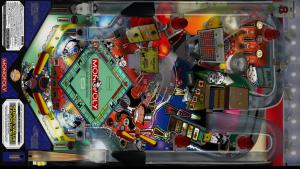

luvthatapex Posted January 24, 2013 Posted January 24, 2013 I like this table very much and Bad Boy Bill did a tremendous job on the FVP. However with the advances in VP9.14, we can modify this table and make it run on just about everyones system without FlashVP. I am in the middle of updating this table and asked Bill for permission to MOD. When I receive permission I will show you a screenprint of the WIP.
godzillagodzilla Posted February 6, 2013 Posted February 6, 2013 Hi Guys. Fantastic Table. Great work!!! I would like to turn the Fvp degree by 90. Is this possible?
luvthatapex Posted February 7, 2013 Posted February 7, 2013 ok, here is the modified version I have been working on. This one should play on anyones cabinet and doesn't required FVP. It includes several VP9.1X enhancements and runs well on my cab. Thanks BBB for permission to mod. Its still a WIP, but it's at the phase now that I think most people will enjoy on their cab. Give it a play http://www.mediafire...wgwt19gfv67g1z7 The LEDWIZ config for 5 flashers is already available and the flasher show is great in this game.
