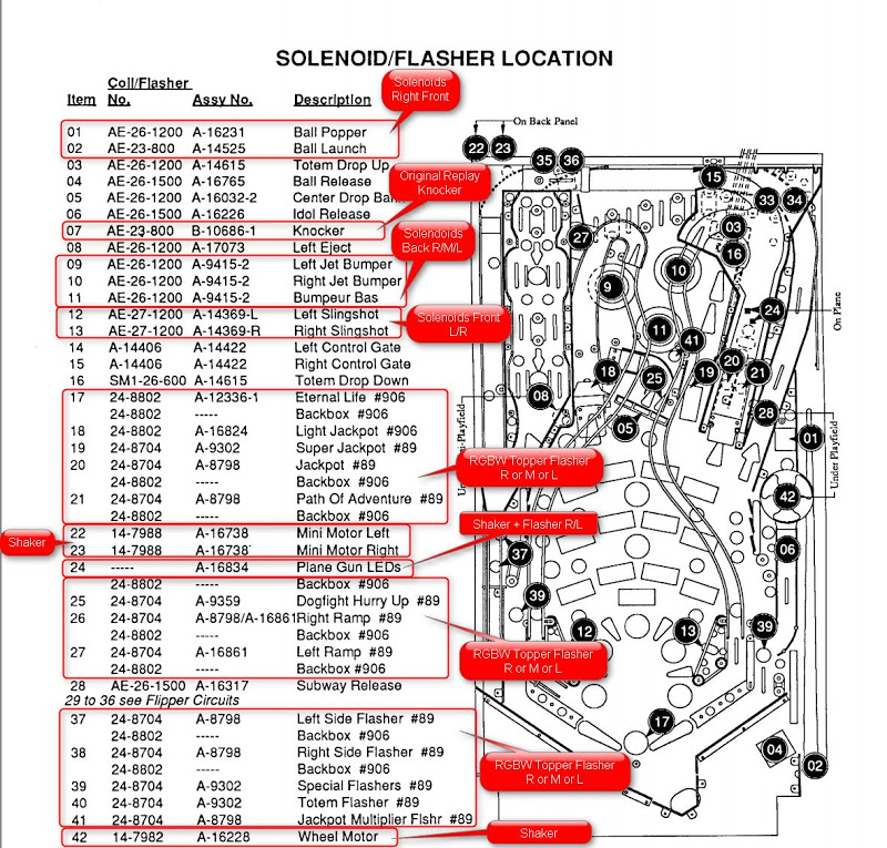

chriz99 Posted November 16, 2010 Author Posted November 16, 2010 trying indy today cheers chris [sIGPIC][/sIGPIC] * taito egret 29 candy cabs * indy & star wars pachinkos 17" bartop with ledwiz rgbleds * 10" bubble bobble & galaga bartop * arm champs 2 check out hi-res backglasses * best vpin performance * ledwiz config and software

chriz99 Posted November 16, 2010 Author Posted November 16, 2010 Hi Chriz!These RGB lights, do thay also show white light. Or do you have to have 3 RGB and 1 white LED like this one yes, they have an extra ultrabright white diode (RGB-W). It's like a strobo. just amazing for stroboscope-effects like AFM strobe multiball. playing Indy right now. flasher rotations are awesome and the extra shaker on the right ramp (when you can hear the machine gun) gives so much extra fun to the gameplay. I think i will try addams family for a short test (bookshelf greeeeed with activated shaker and the multicolored bumper caps) cheers chris [sIGPIC][/sIGPIC] * taito egret 29 candy cabs * indy & star wars pachinkos 17" bartop with ledwiz rgbleds * 10" bubble bobble & galaga bartop * arm champs 2 check out hi-res backglasses * best vpin performance * ledwiz config and software
shilmover Posted November 16, 2010 Posted November 16, 2010 Hi Chriz!These RGB lights, do thay also show white light. Or do you have to have 3 RGB and 1 white LED like this one I wonder if the ones I have will display white too... Will test tonight. yes, they have an extra ultrabright white diode (RGB-W). It's like a strobo. just amazing for stroboscope-effects like AFM strobe multiball.playing Indy right now. flasher rotations are awesome and the extra shaker on the right ramp (when you can hear the machine gun) gives so much extra fun to the gameplay. I think i will try addams family for a short test (bookshelf greeeeed with activated shaker and the multicolored bumper caps) Post a video of the flasher rotation as I dont fully understand what you are doing there.
chriz99 Posted November 16, 2010 Author Posted November 16, 2010 I wonder if the ones I have will display white too... Will test tonight.Post a video of the flasher rotation as I dont fully understand what you are doing there. you have to mix red, green and blue to generate white with a rgb-led. the cree leds have an extra fourth diode for ultrabright white. the mixing is better than rgb-white and the extra coldwhite diode gives that strobo kick. with flasher rotation I mean the flashers on top of the backbox go mad cheers chris [sIGPIC][/sIGPIC] * taito egret 29 candy cabs * indy & star wars pachinkos 17" bartop with ledwiz rgbleds * 10" bubble bobble & galaga bartop * arm champs 2 check out hi-res backglasses * best vpin performance * ledwiz config and software
