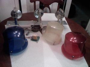

shilmover Posted November 17, 2010 Posted November 17, 2010 And then there were 9... Looks like I blew the Red on one of the LEDs. Accidentally bypassed the resistor with 6v. No more red. Correction, I had the resistor for the Red LED on the Blue one and Blue on the Red on... Hence, no Red LED...
njay Posted November 17, 2010 Posted November 17, 2010 holy crap dude those are huge !!!! My Mini Pin Build: http://www.hyperspin-fe.com/forum/showthread.php?t=5622 My Arcade Bartop Build: http://www.hyperspin-fe.com/forum/showthread.php?t=14570

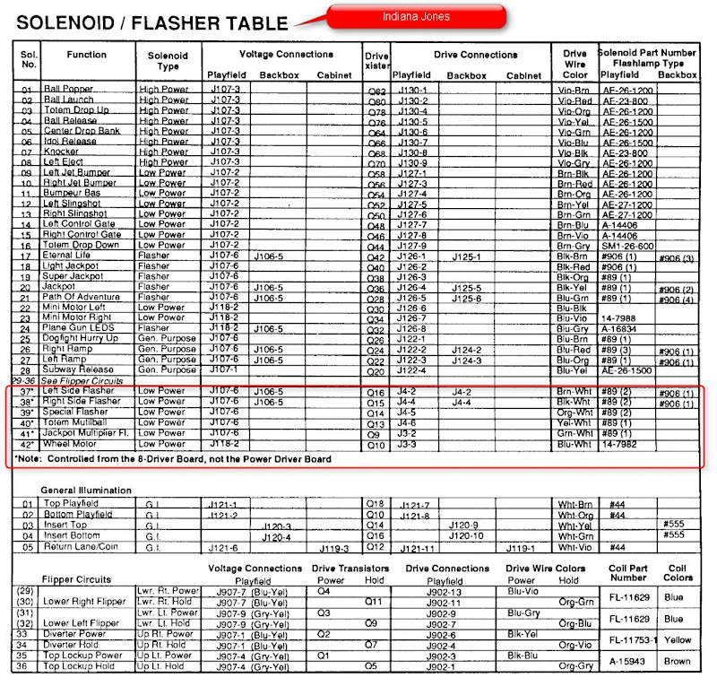

chriz99 Posted November 17, 2010 Author Posted November 17, 2010 thanks for your help, guys! Which version of Addams? Looks like there are 6 flashers in the script. This is slightly different from the manual.Solenoid 17 = Flasher 1 (above small flipper left) 18 = Flasher 2 (above swamp) 19 = Flasher 3 (above pop bumper 1) 20 = Flasher 4 (upper left) 21 = Flasher 5 (Top center) 22 = Flasher 6 & Cloud Topper Does any of this help? addams family flasher 17-21 generates an visual pinball overflow/outspd/line0 error, when the ball activates the first flasher. --------------------------- on twilight zone the same, overflow/outspd/line0 error --------------------------- I noticed on indiana jones, that flasher 37-42 are not working... but 17-21 works great! maybe because 37-42 are controlled via 8-driver-board? cheers chris [sIGPIC][/sIGPIC] * taito egret 29 candy cabs * indy & star wars pachinkos 17" bartop with ledwiz rgbleds * 10" bubble bobble & galaga bartop * arm champs 2 check out hi-res backglasses * best vpin performance * ledwiz config and software
pixelmagic Posted November 17, 2010 Posted November 17, 2010 Look at what I just bought... Are those F14 Tomcat lights ?? [TABLE=width: 500] [TR] [TD][/TD] [TD=align: center]New project homepage: http://blog.pixelmagic.nl/[/TD] [TD][/TD] [/TR] [TR] [TD][/TD] [TD=align: center]LED-Wiz utility: http://pinball.pixelmagic.nl/ledwiz/[/TD] [TD][/TD] [/TR] [TR] [TD][/TD] [TD=align: center]Anyone want to buy my LEDwiz ?? [/TD] [TD][/TD] [/TR] [/TABLE]
njay Posted November 17, 2010 Posted November 17, 2010 the 8 board driver should also be controlled by the rom right? maybe the output signals to the board is different from what expected My Mini Pin Build: http://www.hyperspin-fe.com/forum/showthread.php?t=5622 My Arcade Bartop Build: http://www.hyperspin-fe.com/forum/showthread.php?t=14570

shilmover Posted November 17, 2010 Posted November 17, 2010 holy crap dude those are huge !!!! Yes... Yes they are... Are those F14 Tomcat lights ?? You got it. The cool think about this unit is that the light does not rotate like others, the light is stationary and the silver disk rotates. This means that I should be able to install RGB lights there and control the color of the lights.

njay Posted November 17, 2010 Posted November 17, 2010 OFcourse not as bright as those cree leds, but they will do Still need to decide where to point the LED at or towards me or to the back to the wall flLaybmnjnE My Mini Pin Build: http://www.hyperspin-fe.com/forum/showthread.php?t=5622 My Arcade Bartop Build: http://www.hyperspin-fe.com/forum/showthread.php?t=14570
