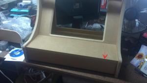

bluc Posted February 1, 2014 Author Posted February 1, 2014 Yep that's the drill bit I bought. The epoxy I was going to use on the control panel not the lexan but where the control panel (horizontal piece) meets the front panel at bottom(vertical bit). Just that after I route a radius on the front edge there is no way to screw the to pieces together because of the radius. I have to rely on glue. So if I put couple gusetts and a couple dowels and use epoxy I should end up with a good strong joint. see red arrow in picture below

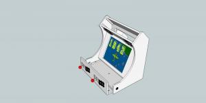

Polemicist Posted February 1, 2014 Posted February 1, 2014 Most epoxy are a two part glue. These can tend to go brittle over time. Liquid nails is my preference for a harder bond for wood. With most builds like this you would have internal boards that did most of the work of holding the pieces in place as pictured here http://www.koenigs.dk/mame/eng/stepweecade.htm This allows you to be able to route the corner you have to a large radius without issue. That looks like 16mm MDF so you could eve get away with a 8mm radius curve on that if you are mounting the boards as seen above.
bluc Posted February 1, 2014 Author Posted February 1, 2014 Yea I have the same blocks as seen in your link, I am also putting piano hinge on it so the control panel pivots forward for access to the inside of control panel to bottom of buttons and joysticks and electronics, it is fully supported while closed but need it to be strong while opened. My concern is the join along the front not being strong enough and failing 2-3 years down the track. Although The control panel wont be opened much I dont want to have to build a new control panel because of the front join in the timber fails. see pick below to see what I mean by having it pivot
