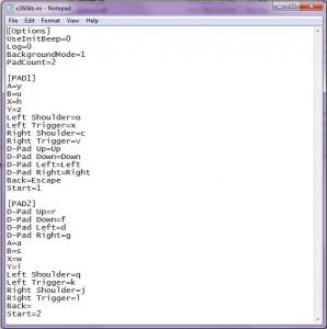

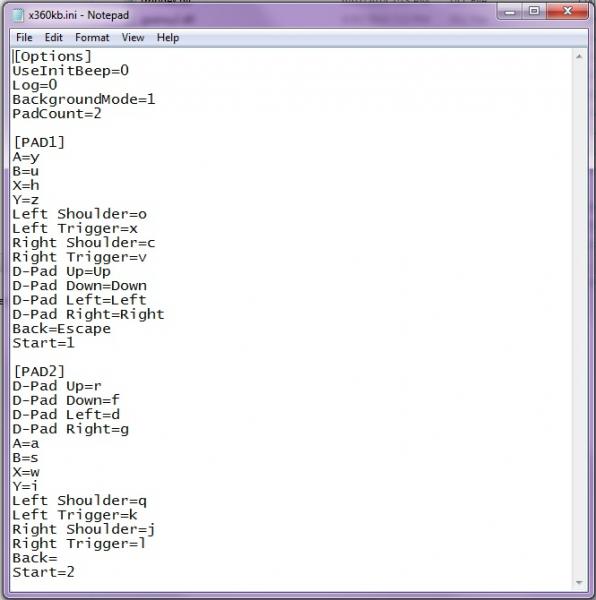

langersld Posted February 12, 2014 Posted February 12, 2014 OK... I was having some real issues getting the virtual joysticks to register with this game.... With the help of my good friend Majorspawn ( Big Credit to him for the files.......thanks champion)... We have stumbled on a relatively easy fix for those of us using Ipacs so that p1 -p2 controllers are available in the new Double Dragon Neon game... This hack has been done before and we have not created the files..... Big thanks to who ever it was that created it... So simply copy Xinput1_3.dll and x360kb.ini ( in my ftp) into your game directory (bin folder)... Open x360kb.ini and change your keyboard inputs to match... Load the game and whallahh... you will be able to select your 2 controllers in the config menu Note this has only been tested with an IPAC... other controllers may not work Ps.... I hope I put this post in the right section

langersld Posted February 12, 2014 Author Posted February 12, 2014 The control options in the game itself don't seem to stick. You have to select controller 1/2 for both characters. Sent from my SM-N9005 using Tapatalk Do you mean not saving? When you start playing the game the controllers seem to be found automatically... Just make sure that pad1 and pad2 in x360kb.ini match your Ipac setup

njgsx96 Posted February 13, 2014 Posted February 13, 2014 Wow, that is flipping awesome! I had the keyboard mapped in game. Set up the ini file, making PAD 1 equal to what my 2 player controls are and presto-change... I no have a 2 player game for my cab! Thank you all!
langersld Posted February 13, 2014 Author Posted February 13, 2014 I have them mapped in game now and they remember when started through hyperspin. Give it a try, should work. can confirm this guys.... so just a small recap.. The Game will default controls to Player 1 - Keyboard Player 2 - Controller 1 So....... 1. Use keyboard for player 1 - Map inside game ( as it saves your keyboard binds)...tested and working 2. Use PAD 1 for player two inputs ( default in game) - Just map the x360kb.ini to match your desired keys on your second player CAB joy and buttons Running it like this will remove the need to enter the game controller config on each boot
