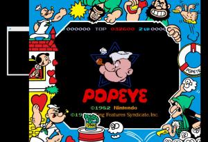

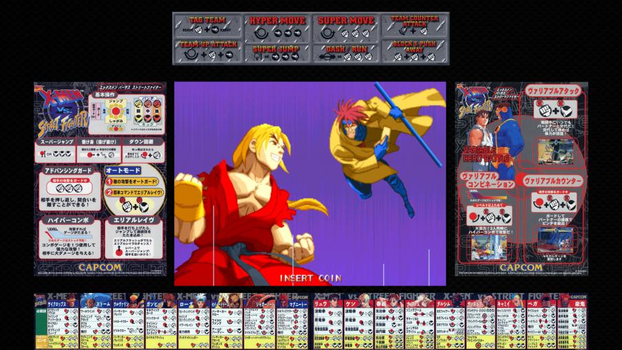

Here's some examples.

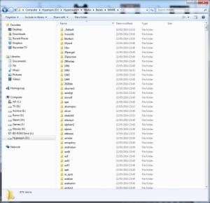

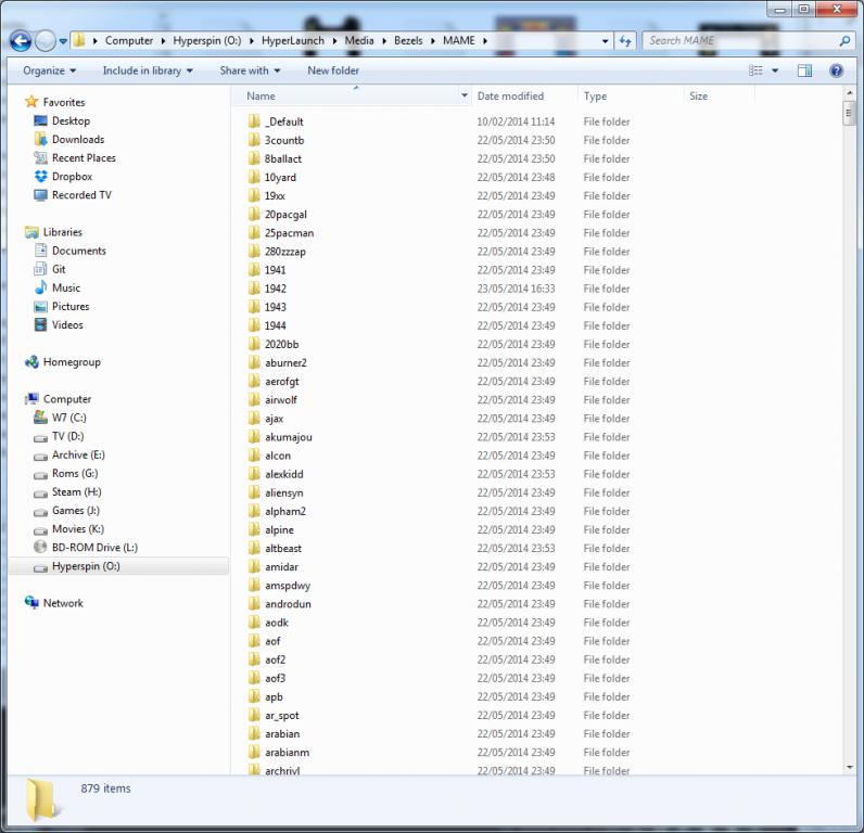

So what do you do with this mass of artwork? The folders should be placed in your “:\HyperLaunch\Media\Bezels\MAME” folder, if you already have artwork in there you can choose to add them or not, but the artwork you have already; will still be usable.
There are 2 sets of optional files that can be added. “Background - 16x9 black 19201080 (Potts43).png” which can be found with the project folders in "_Default" or as part of the script written by rfancella. Also “Bezel - 16x9 transp 19201080 (Potts43).png" & “Bezel - 16x9 transp 19201080 (Potts43).ini” this is also included in another script written by Ron, but I will leave him to explain what they are and what to do with them.
Here is the folder structure.

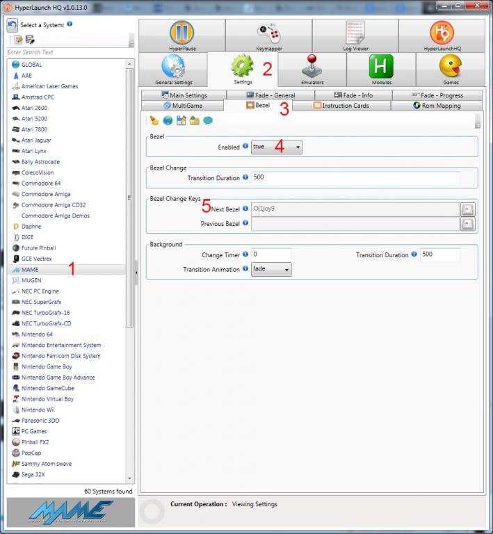

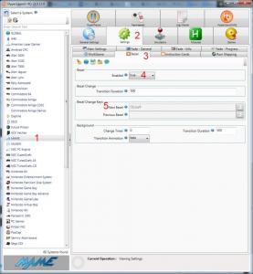

To set this up first open Hyperlaunch HQ and select Mame from the left pane (1), click the settings tab (2) and then the Bezel tab (3). Look to the bezel section and set Enabled to True (4), next section to look at is “Bezel Change Keys”. (5)
To be able to change the bezels and also go full screen if required, you need to assign a “Next Bezel” key, so go ahead and set that.

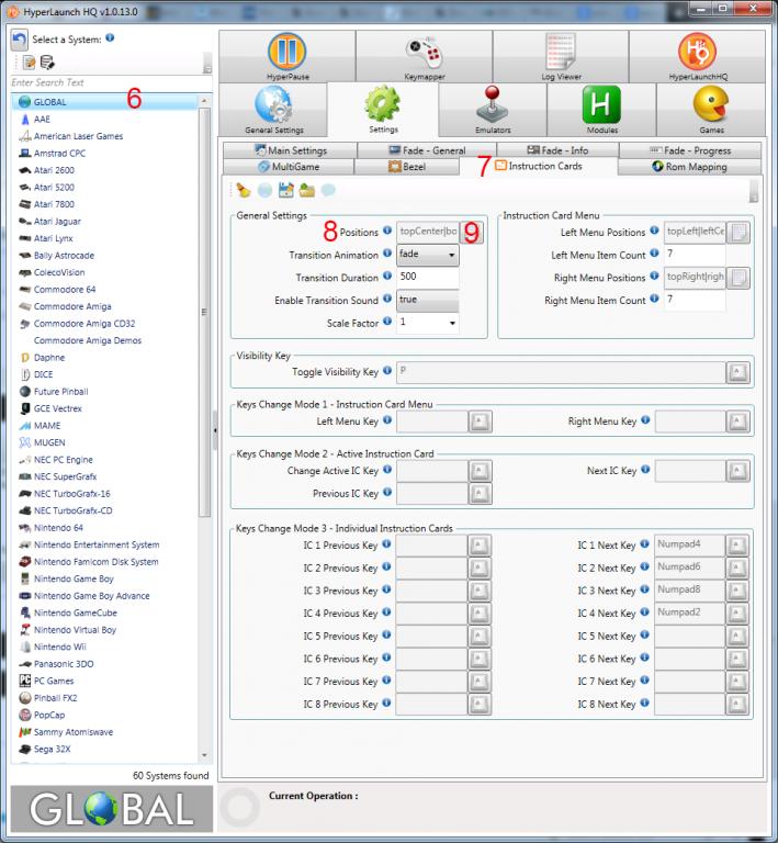

Next click Global on the left pane or if you need these settings just for Mame stay in Mame(6), click the Instruction cards tab (7).

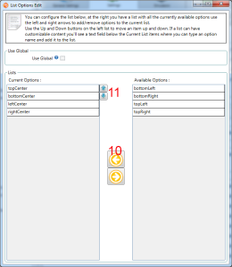

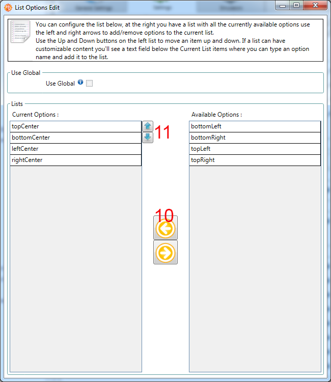

Look at General Settings, Positions (8). Click the “List options Edit” button (9).
If you haven’t added these positions, you need to move them to the left Hand Side using the left arrow (10).
Move the following.
Top Center
Bottom Center
Left Center
Right Center
You can add more if you plan on having IC’s in other positions, but they won’t be needed for this set.
Now if they are out of order, use the blue arrow keys to put them in order (11).
Close that window.

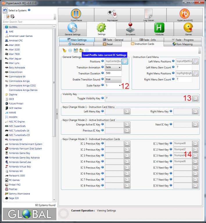

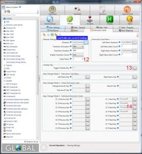

Now look at the scale factor. You need to set this to “1” so type that in the box (12).
You can now set a Visibility key if required; this key will quickly remove all IC’s from the screen (13).
Next up is the “key Change Mode 3”, these keys will cycle the 4 positions for our IC’s.
I have only set 4 keys as this is enough, but you can set the “Previous Key” as well.
N.B. The keys I have set are just examples; some of you will be using arcade buttons to cycle through the artwork, others may be using game pads.
So I have set ”IC 1 to IC 4 Next” keys (14).
IC1 is leftCenter Position.
IC2 is rightCenter Position.
IC3 is topCenter Position.
IC4 is bottomCenter Position.

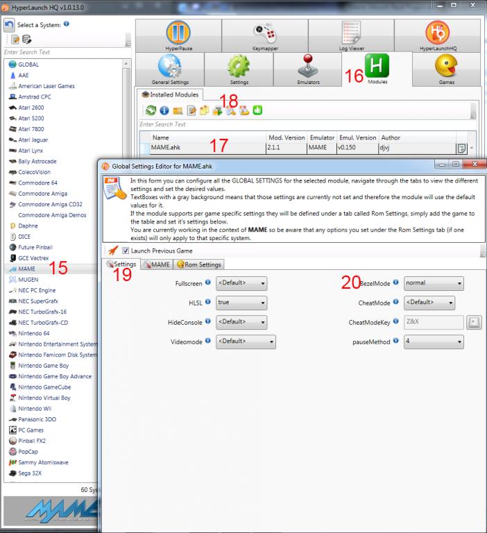

Finally we need to set the correct Bezel mode.
On the left pane select Mame (15)
Choose the Modules tab (16)
Highlight Mame.ahk (17)
Hit the Edit Global Module settings (18)
Next in the Settings tab (19) seek out the bezel Mode and change it to “Normal” (20)
You can now run a game audit, and run a game with a supporting bezel. PuckMan is a good first choice as it has 5 bezels and 2 IC’s.

Give this a try.
Open up HLHQ.
Select MAME on the left.
Select Modules on the top.
Click once on MAME and hit the "Edit Global Module Settings" button.
On the Settings tab, make sure your BezelMode is set to "normal".
Click on the MAME tab right next to Settings.
Change the following all to "false": Artwork_Crop, Use_Bezels, Use_Overlays, Use_Backdrops, Use_Cpanels & Use_Marquees.
Close out that window.
Click the Settings tab on top.
Click the Bezel sub-tab and make sure Bezel - Enabled is set to true.
If that doesn't work, post your HyperLaunch log using code tags as described here:
http://www.hyperspin-fe.com/forum/showthread.php?31072-The-HyperNoobie-Guide-For-Posting-To-The-Fourm
Let me know how it goes.

Step 7:
Delete the M:\Bezels\_MAME Artwork Bezel Project\0_Extras directory and all it's contents.
Move all the directories from M:\Bezels\_MAME Artwork Bezel Project\ to your HyperSpin setup. Put them in ...\HyperSpin\HyperLaunch\Media\Bezels\MAME and when asked to overwrite the files and directories, please say Yes to all. When done, your directory structure should look something like this:
...\HyperSpin\HyperLaunch\Media\Bezels\MAME\_Default
...\HyperSpin\HyperLaunch\Media\Bezels\MAME\3countb
...\HyperSpin\HyperLaunch\Media\Bezels\MAME\8ballact
...\HyperSpin\HyperLaunch\Media\Bezels\MAME\10yard
...\HyperSpin\HyperLaunch\Media\Bezels\MAME\19xx
Yours may be a little different if you already had some bezels in there.
That's it. This should allow your 4x3 setup to display all the bezels from the MAME Artwork Bezel Project correctly!
