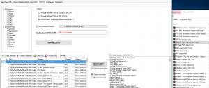

skylinekiller Posted April 25, 2016 Posted April 25, 2016 This is what I am talking about. My roms appear to be names exactly like the media. It says rom not found, but there it is in my folder. **UPDATE** I realized I have to double click the system on the left each time for each system. I can't just use the drop down box every time.
