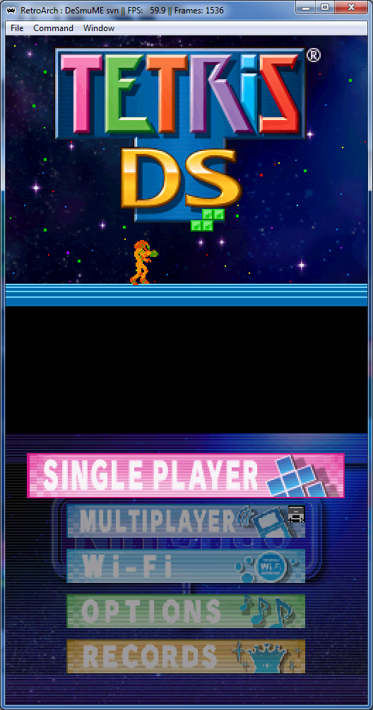

Fromlostdays Posted January 23, 2015 Author Posted January 23, 2015 Can the DESMUME core fullscreen with a gap?? That's what the above post is about. It isn't implemented yet, but apparently they plan to and are working on it. As of right now you can change the orientation, but you can't separate the two screens, thus that fantastic DS bezel for HL goes to waste. I have to say though, in the picture above I don't see a gap. I see one big screen. We sort of need two screens not conjoined in any way... right? Walter:beerglass:

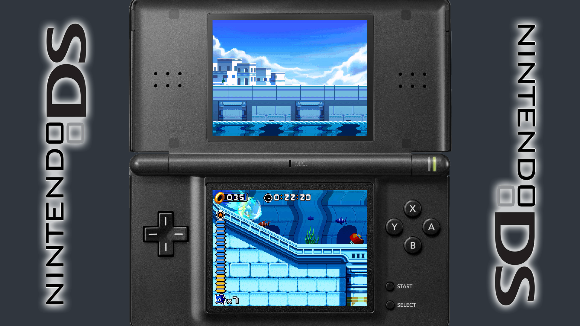

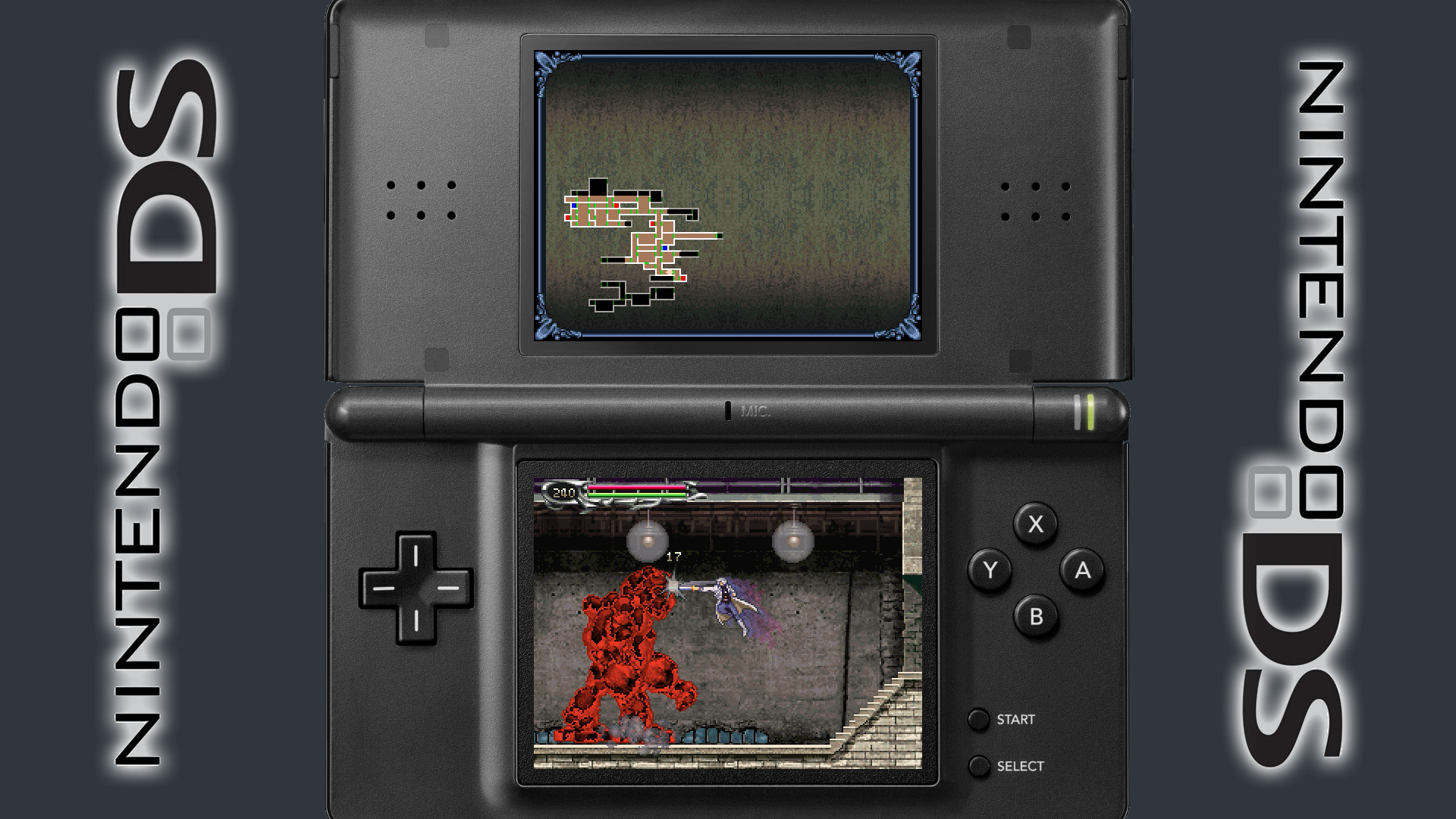

Awakened Posted January 23, 2015 Posted January 23, 2015 OMG I need this in my life...... theres sooooo much I need to be working on but PS2 has taken my life. Can the DESMUME core fullscreen with a gap?? Yep. I just took that shot in windowed mode to show it was in RetroArch. I have to say though, in the picture above I don't see a gap. I see one big screen. We sort of need two screens not conjoined in any way... right? I used the biggest gap size, 90px, so it's the giant black bar between the top and bottom screens. Someone could make an overlay that has a middle portion the covers the black bar to better give the illusion of two screens. Edit: I made an overlay that fits at 1080 res, with integer scale on and screen gap set to 90 that you can grab here. I included a .psd version with all the layers if you want to edit it. Setting overlay opacity to 100 in RA's settings makes it look best:
fire10 Posted January 24, 2015 Posted January 24, 2015 Great work could you make a 1024 x 768 version aswell many thanks for this.
Awakened Posted January 24, 2015 Posted January 24, 2015 Great work could you make a 1024 x 768 version aswell many thanks for this. Here's my attempt.
