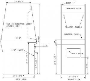

rockyrocket Posted March 23, 2012 Posted March 23, 2012 I have this, can not seem to find the original site it came from though sorry. Starwars build Tron build Tempest build
rockyrocket Posted March 23, 2012 Posted March 23, 2012 http://timeouttunnel.com/movie.htm Has some cool renderings and a very cool movie by peter hirschberg, bet that makes you build one!. Starwars build Tron build Tempest build
mameman Posted March 23, 2012 Author Posted March 23, 2012 I have this, can not seem to find the original site it came from though sorry. yeah i found that same one a little while back, i may have to use it also. surprising there is not more out there given i have seen a number of builds. PM me for any custom CNC needs. Find me on Facebook.. Xtreme Pinball or www.xtremepinball.com Ipad pinball cabinet iFlipper Here: See the Doctor Who build Here.... / See the Tron build Here.... / See the BattleStar Galactica build Here.... See the Big Bang Bar build Here.... / See the Twilight Zone build Here.... CNC Work Here.....
