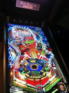

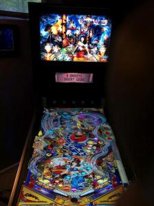

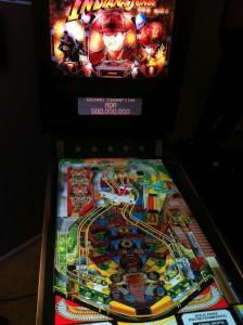

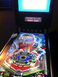

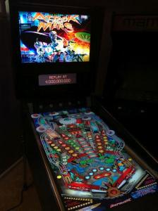

bill55 Posted May 3, 2012 Author Posted May 3, 2012 FINALLY! Got to load up a couple tables and see them on the playfield screen. No LEDWiz yet or even cabinet buttons functioning, but it's a start. Had some trouble getting the backglasses to show up. I think it may be due to my monitor numbering. Not exactly sure how to change the numbering in windows. I know how to move them around and select the default, but not the actual 1, 2, 3 numbering. Anyone know before I start my google hunt. I did get the DMD working on the correct screen at least. Anyway. here are a couple pics. My Pinball Build: Indiana Jones and the Pinball Crusade

delliott00 Posted May 4, 2012 Posted May 4, 2012 FINALLY!Got to load up a couple tables and see them on the playfield screen. No LEDWiz yet or even cabinet buttons functioning, but it's a start. Had some trouble getting the backglasses to show up. I think it may be due to my monitor numbering. Not exactly sure how to change the numbering in windows. I know how to move them around and select the default, but not the actual 1, 2, 3 numbering. Anyone know before I start my google hunt. I did get the DMD working on the correct screen at least. Wow.... Awesome cabinet build. I am refurbing an old pinball cabinet now and have gone through some of the same setup issues you had when using the tutorial. It is very helpful but also has a few frustrating omissions as I think things have changed a lot. Are you using winXP? If you are, you can get it to make the monitor identification (1,2,3) sticky by plugging the primary display and 2nd monitor in first (primary should be monitor 1), then setting up the resolution for #2 in properties, then shutting down. Then plug the 3rd monitor in, start up and go into the properties and set that one up. XP seems to identify them based on the order that they are attached, even though you can place them in different adjacent positions on your virtual desktop. Also, you'll have to use the nVidia setup tool and make sure whichever card has two monitors plugged in that the sequence is correct when its lists them both. For example, I have a 23 Acer backglass and a 15" dell DMD. Both are on my 2nd card. When I pull up that card it has to say "Acer 23VL + Dell 15EFP" ... if its the other way around, I get the DMD set to #2. Took me a while to figure that out but since then they have not changed even if I unplug and reconnect. BTW I also had the same problem with the backglass. Took me a while to figure out that the install zip had an older file in it. The newest DLL and EXE fixed that problem. The second problem I had was that the XML game title and description have to be the same, and have to match the table, uvp, and png file names. The tutorial specifically shows them with different entries in those fields, but that apparently won't work. Right now I'm getting some weird problems where certain tables will run fine in vpinball.exe with the original vpinmame script (but no backglass), but as soon as I try to edit to ultravp.backglassserv (for those with a uvp file) the tables bog way down and it takes 10 seconds for every keystroke or mouse movement to show up. Not sure why, although I don't fully understand the difference between uvp, active backglass, and static backglasses and how to tell which format a table is set up for, and how to set each up in the script and in Hyperpin... LOL.... I need a tutorial for the tutorial.... Anyways, again great build. Very helpful. -Dave

swaffar Posted May 4, 2012 Posted May 4, 2012 Got to load up a couple tables and see them on the playfield screen. No LEDWiz yet or even cabinet buttons functioning, but it's a start. Had some trouble getting the backglasses to show up. I think it may be due to my monitor numbering. Not exactly sure how to change the numbering in windows. I know how to move them around and select the default, but not the actual 1, 2, 3 numbering. Anyone know before I start my google hunt. I did get the DMD working on the correct screen at least. The numbering DOES NOT matter. All that matters is that: -Playfield monitor is your primary -Backglass monitor (even it windows shows it as #3) is to the right of the playfield monitor in windows settings, aligned with the 0 line on the offset -Backglass monitor should be in native resolution, with correct resolution in hyperpin settings file -Backglass monitor offset settings need to be x=0, y=0 in hyperpin settings file This had me pulling my hair out for hours, because I assumed the backglass offset should be 1920, 0 in the settings file... makes sense right? Nope. Leave it with 0's and don't worry about how windows numbers your monitors. Hope that helps people out.
bill55 Posted May 5, 2012 Author Posted May 5, 2012 Thanks! I'm going to mess around with it a bit tomorrow. What is the easiest test for the backglasses? Easier to get a static one to work first instead of uvp? My Pinball Build: Indiana Jones and the Pinball Crusade
swaffar Posted May 5, 2012 Posted May 5, 2012 yeah as long as you have the folder structure, file names, and hyperpin database are all correct you'll be good to go.

bill55 Posted May 6, 2012 Author Posted May 6, 2012 YES! Took some tinkering but I got it! A couple things I figured out: 1. As others stated the numbering does not matter. It's the order they are on. (playfield on the left, backglass in the center, and DMD on the right. 2. The backglass would not work with the screen running it's native res (1920x1200). I had to change it to 1280x1024 and it worked right away. 3. The tables had to be added to the .XML file for Hyperpin. I thought that if I wasn't using Hyperpin to launch these that it wouldn't matter. I was wrong. Once I added them to that .XML file the UVP backglasses started working. My Pinball Build: Indiana Jones and the Pinball Crusade
